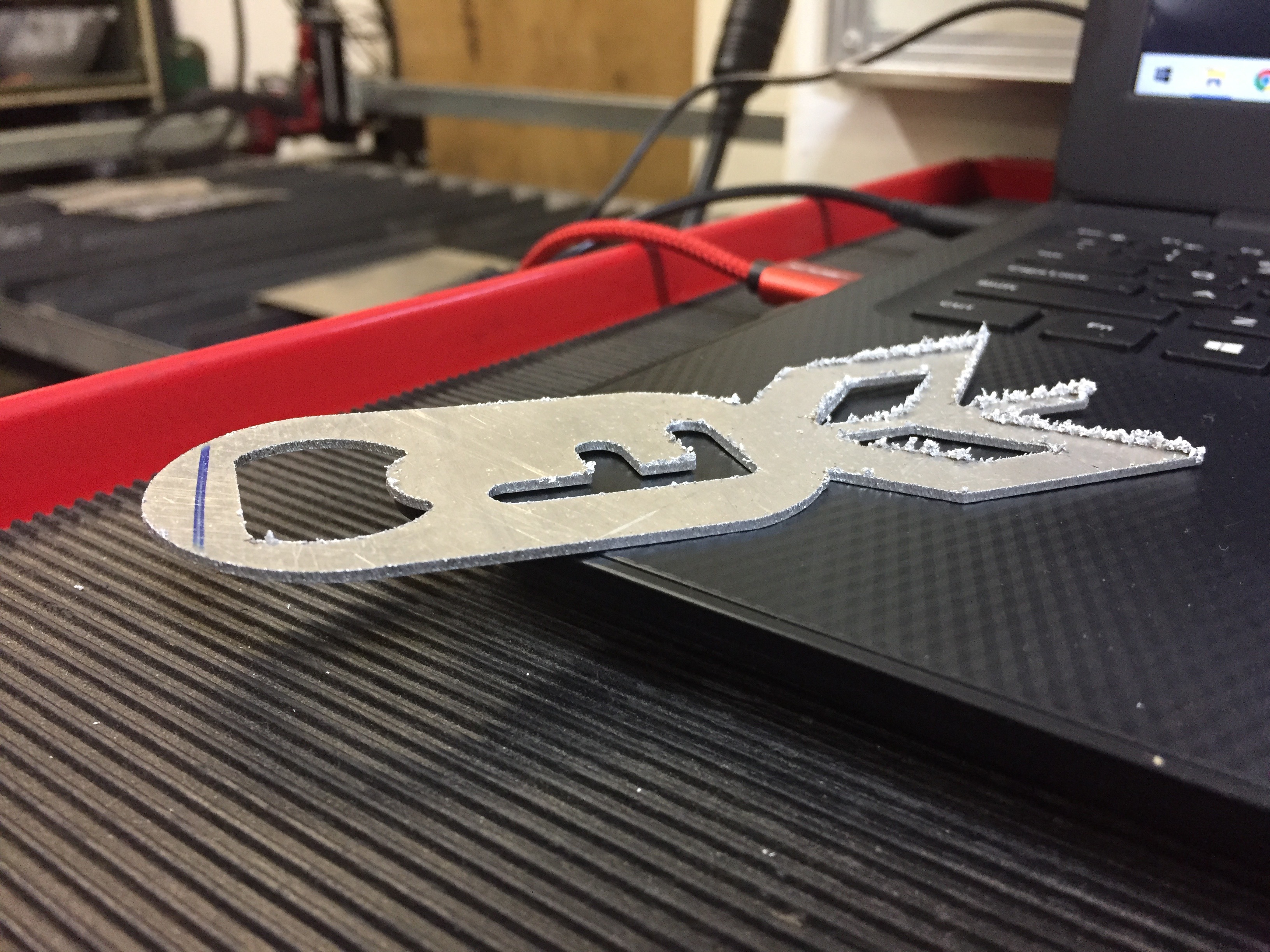

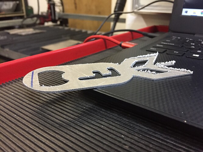

i just cut the FBomb bottle opener out a few minutes ago. nice easy file to run.
Powermax 30 Air, 105 IPM at 20Amps on .050" 5053 aluminum.
dross was almost non existent.

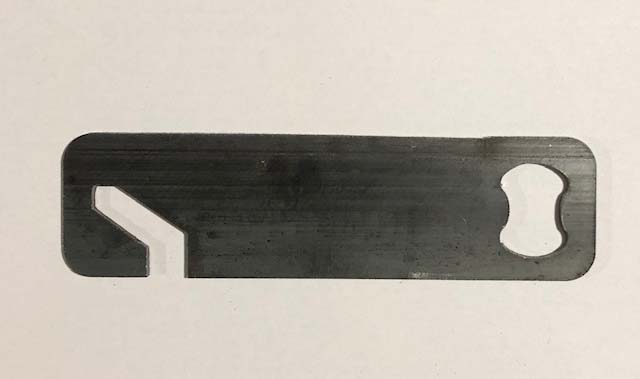

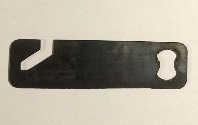

Thats what I ended up doing. Not bad for the first cut on the machine and the first time ever using a plasma cutter.
