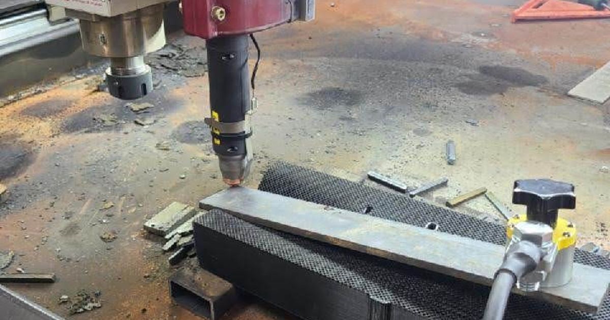

If I were in your situation, I would install a magnetic torch mount. Then that would be a simple process. Personally, I would not like needing to unscrew the cap screws and dismount and then need to re-mount the torch every time I used the machine.
Here is an example:

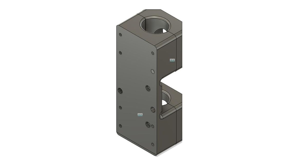

Or if you have access to a 3D printer you could fabricate something:

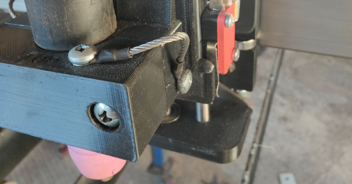

Edit (more breakaway designs):
One that could be adapted or used with the others:
