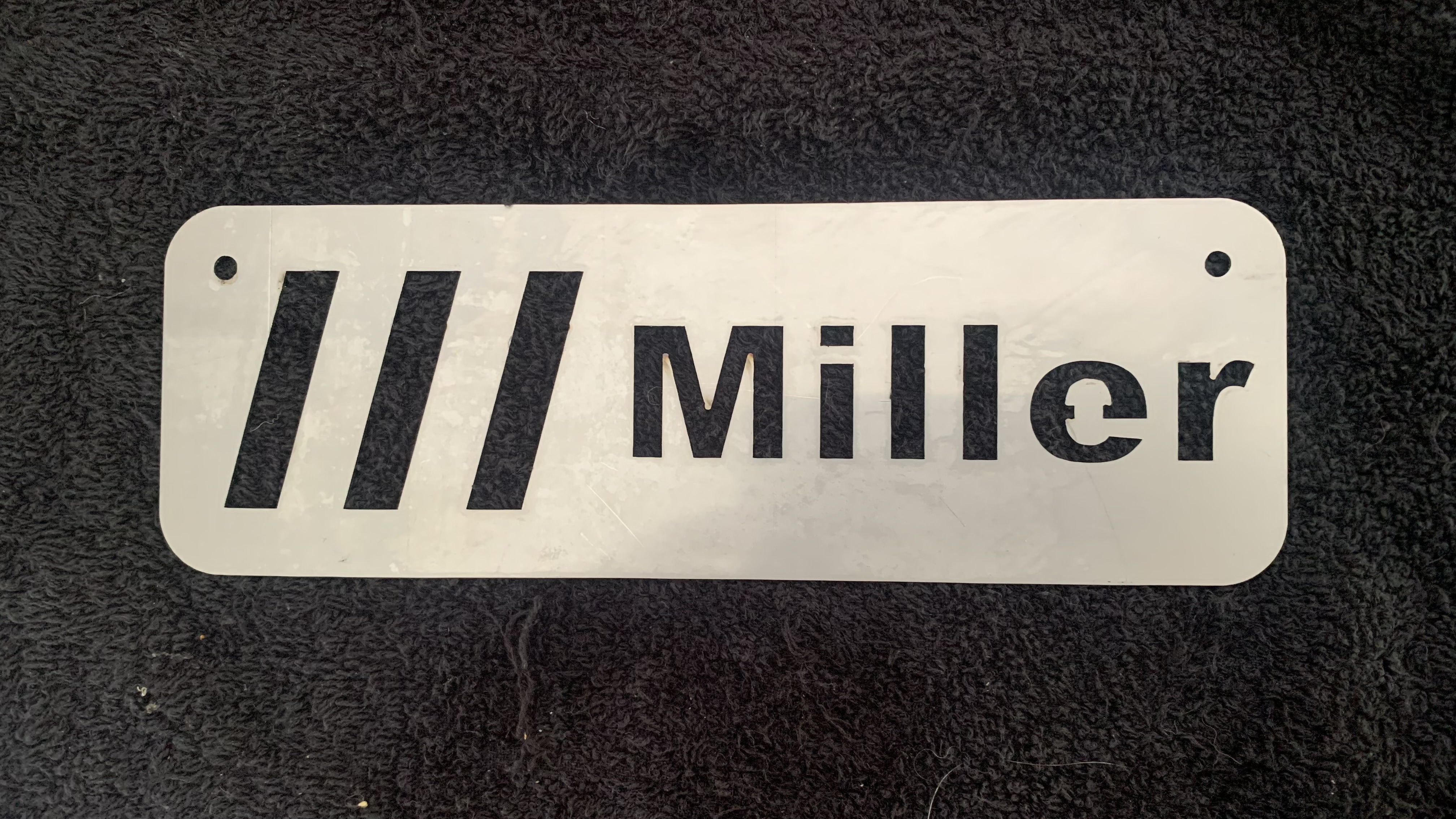

Yes it’s quite capable of running a laser. You will need to add a stand alone Capacitive Torch Height Controller for your Z axis stepper motor though. I am still working on mine as I’m not completely happy with it yet. The laser is very sensitive to distance from material but when you get it right it’s amazing. Couple things I learned the hard way. I am using a 3000watt Razortek machine and with it set to 2000 watts it completely destroyed the water pan. I now have a piece of 1/2 sacrificial plate on the floor under the machine as it doesn’t do anything nice to concrete either. Think lava. Do take the time to put a switch in your machine so that the trigger circuit is either under CNC control or the switch on the handle, not both at the same time. It’s to easy to have a screw up if there’s more than one way to trigger the laser. Always respect the laser! Also run the x/y axis as fast as the laser will cut. There’s charts online for material thickness and wattage. If you cut to slow it will not only try to weld your project to the slats it will also try and cut your slats in half. The little Miller pic is 1.2mm stainless. Cut time was about 6 seconds.
