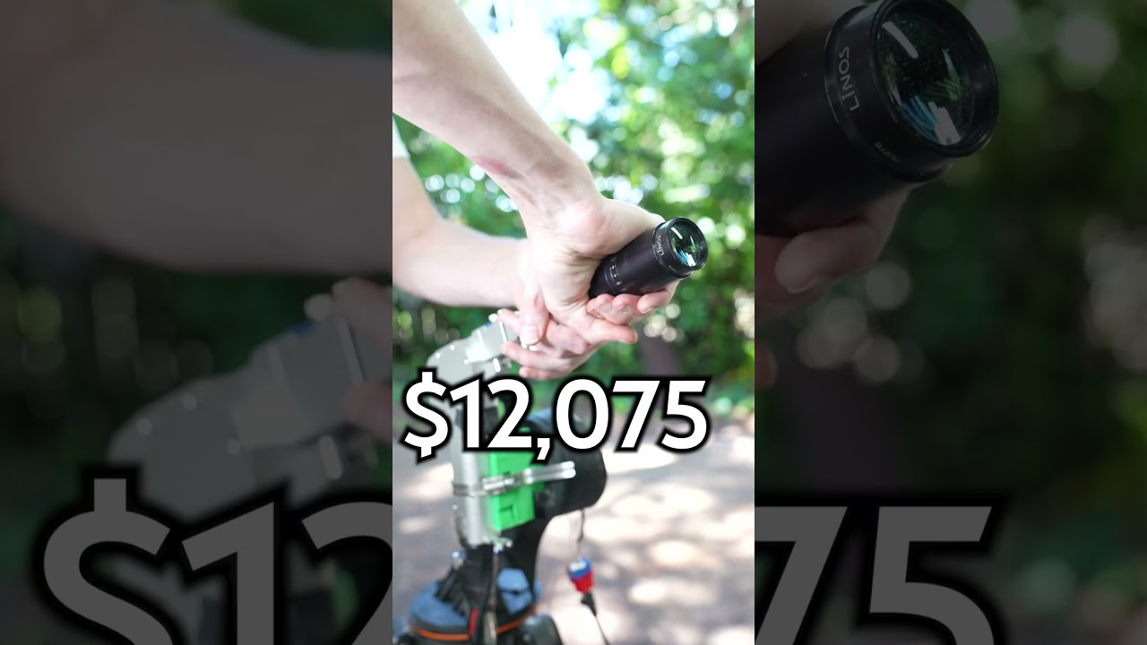

Crossfire Pro Laser Swap
Coming soon! We have a few more issues to resolve (like how to not burn through the water tray).

indeed, kerf width is 0.01"
I cannot imagine some of our crew with a dangerous laser. Can you guys?:grin:
agree, this laser demands respect otherwise it can and will hurt somebody. We’re working out the details of getting this to work with firecontrol while also not blowing a whole through our water tray.

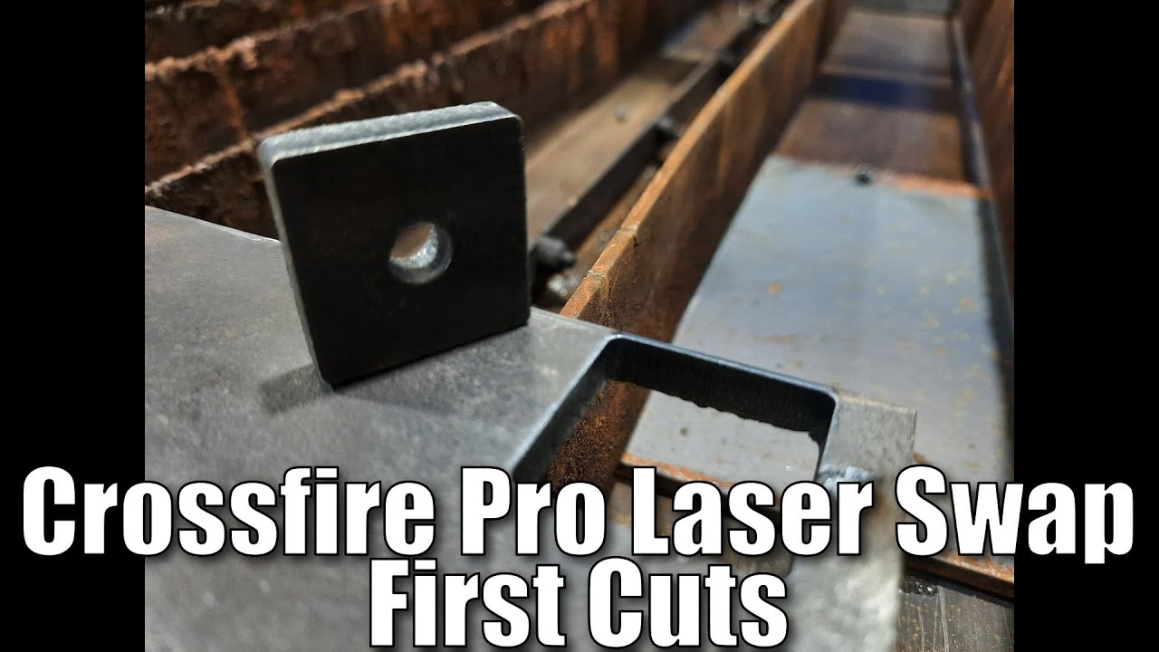

Success! We shot at least an hour of video this afternoon. I’ll edit this down and post it.
1/4" HRS 1" square with 0.25" hole - 1500W at 30ipm, minimal dross, 0.003 over.

Ok that is sexy!
More deets!
