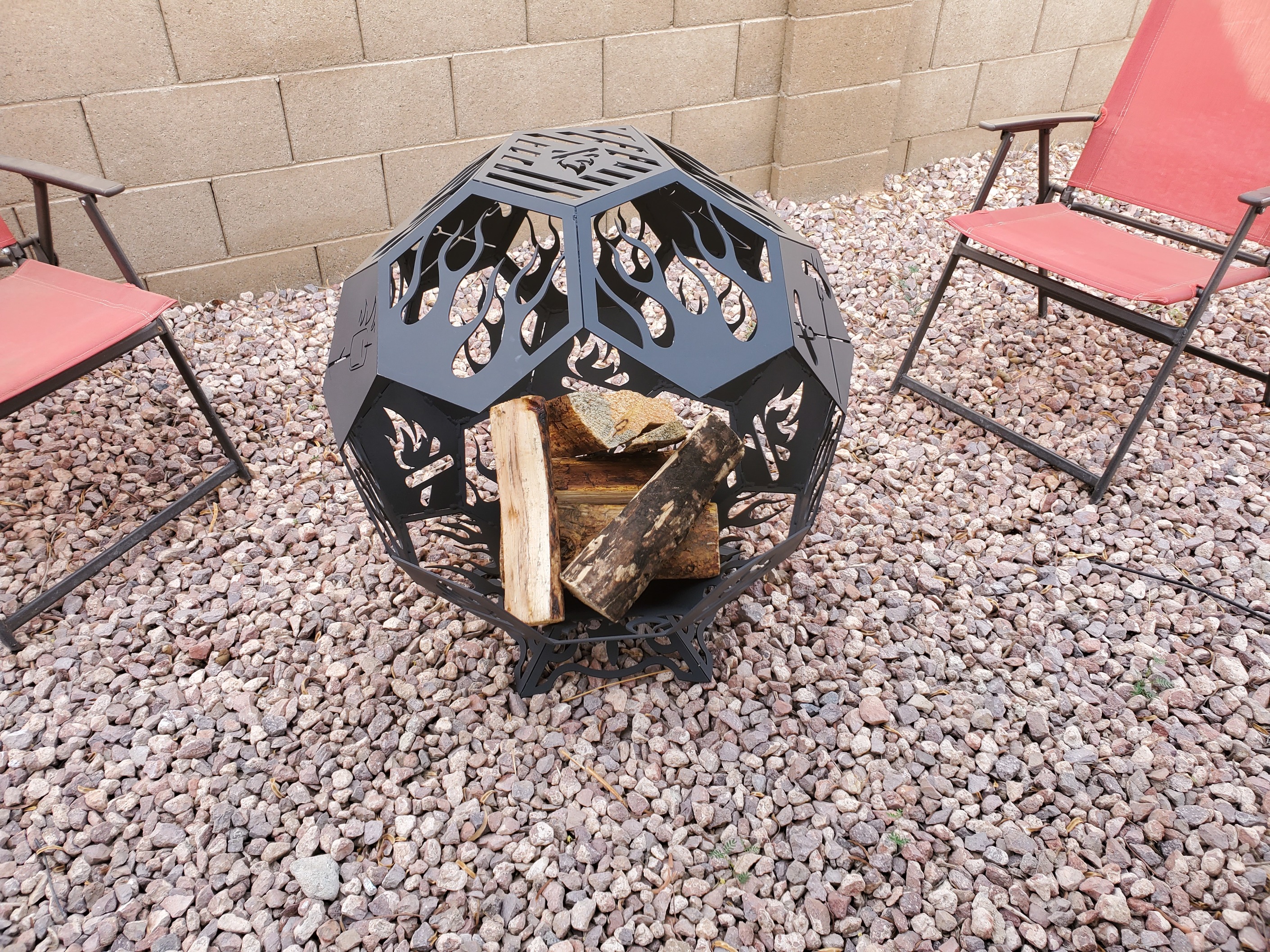

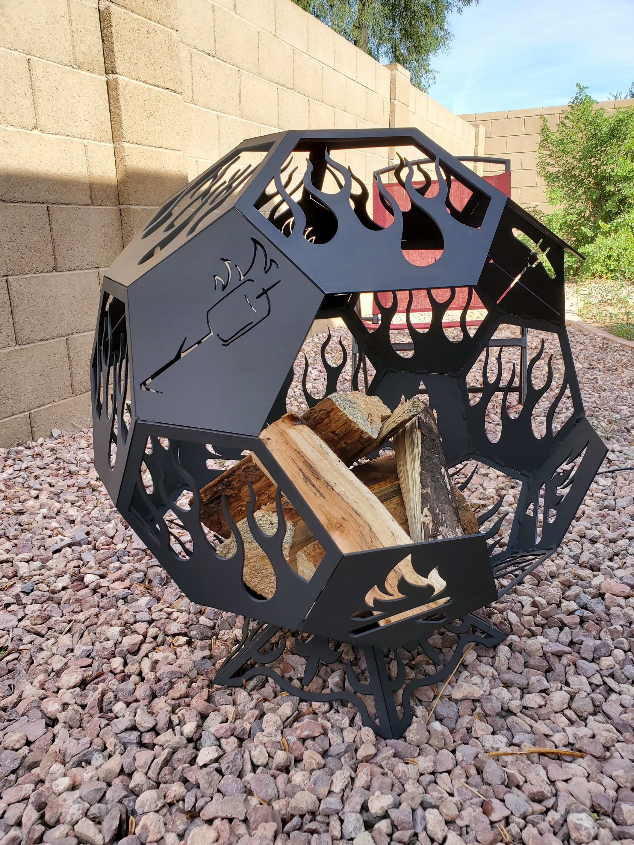

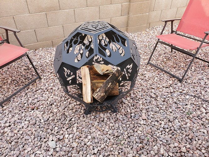

I make these fire pits but I’ve had more success selling the design files on ebay, etsy, and Facebook. I designed this one from the ground up.

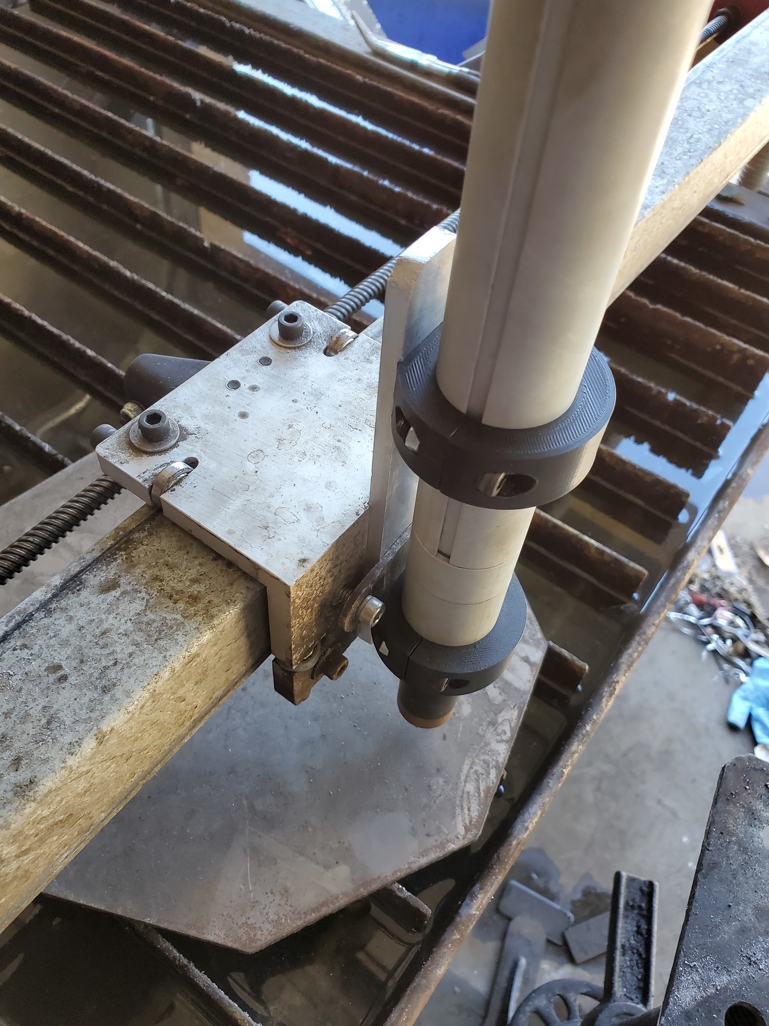

I 3D printed myself a machine torch mount and cut a piece of 1/4" aluminum for the slide bar.
These are big sellers locally at $100-125 a piece. You’ve probably seen them from multiple vendors on Facebook, I just… umm… copied their designs. No excuses lol.

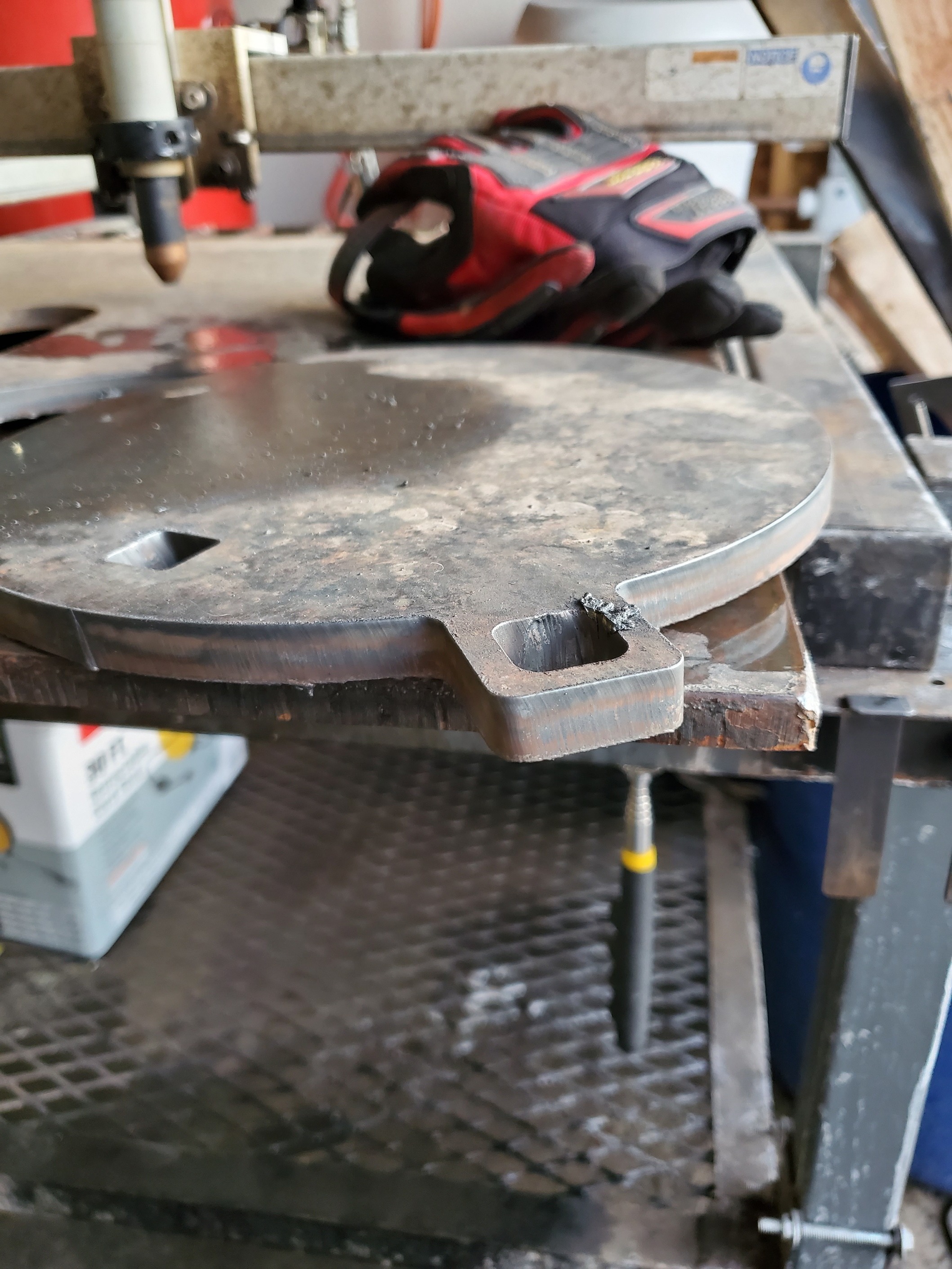

Recently got into cutting AR500 for target gongs. This was my first go at 1/2" and it came out pretty nice with almost no bevel.

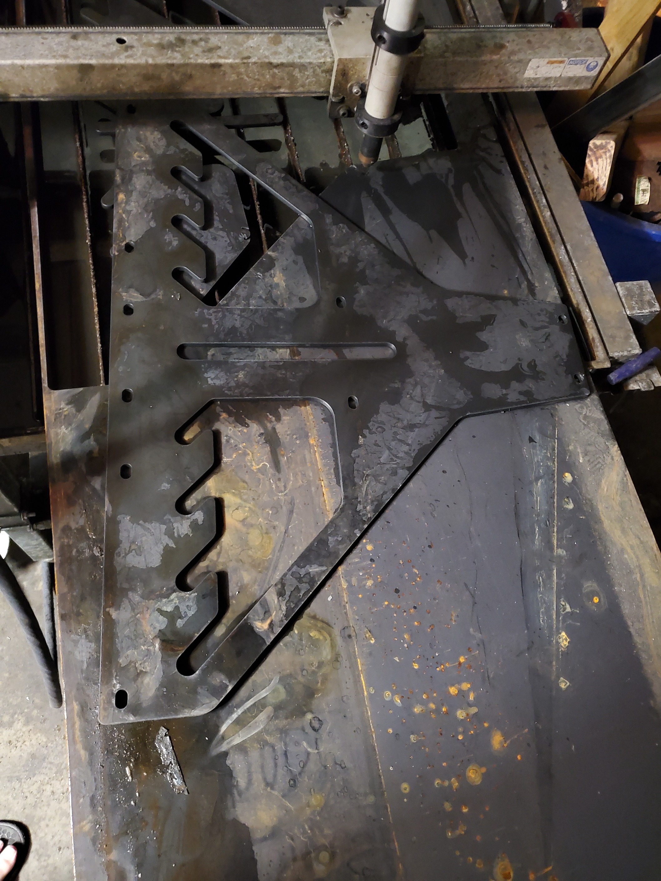

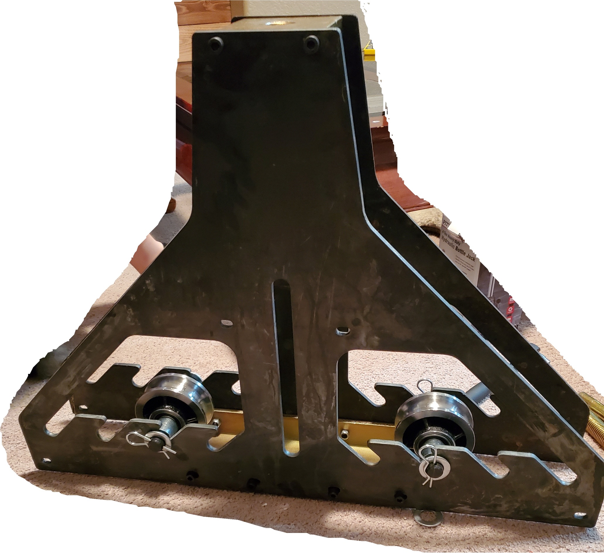

I wanted a tube roller so here’s my current project. Harbor Freight Tube Roller redesigned into something similar to “The Beast” that SWAG sells. I’m still working on it and adding a spring return for the 4 ton jack that sits inside but it’s almost done. Next, I’m cutting a tube bender out of 5/8" steel that’ll use a air/hydraulic ram and JD2’s die. I’ve got the files ready, I’m just keeping an eye out for a drop piece that’s about 1/4 of a sheet. As soon as my supplier has one, I’ll scoop it up and get started.

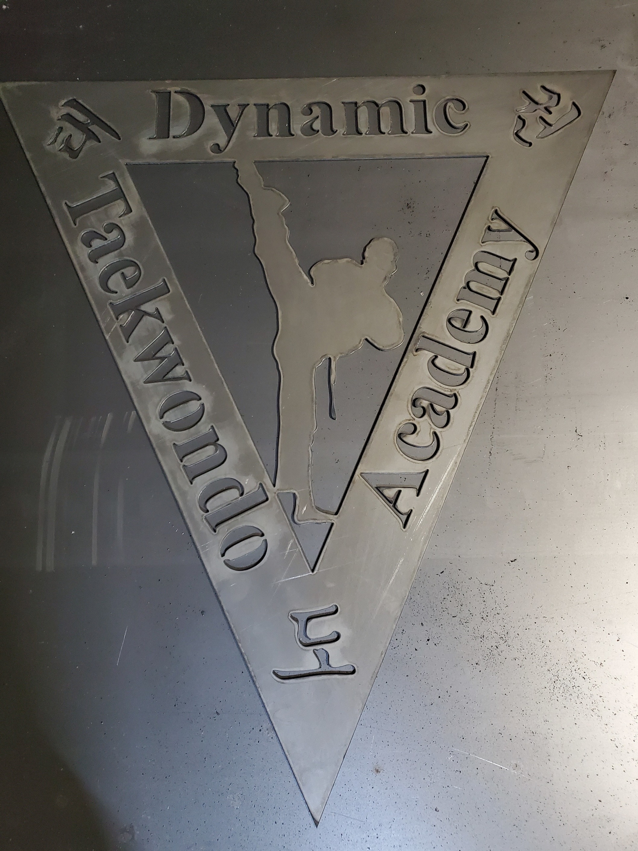

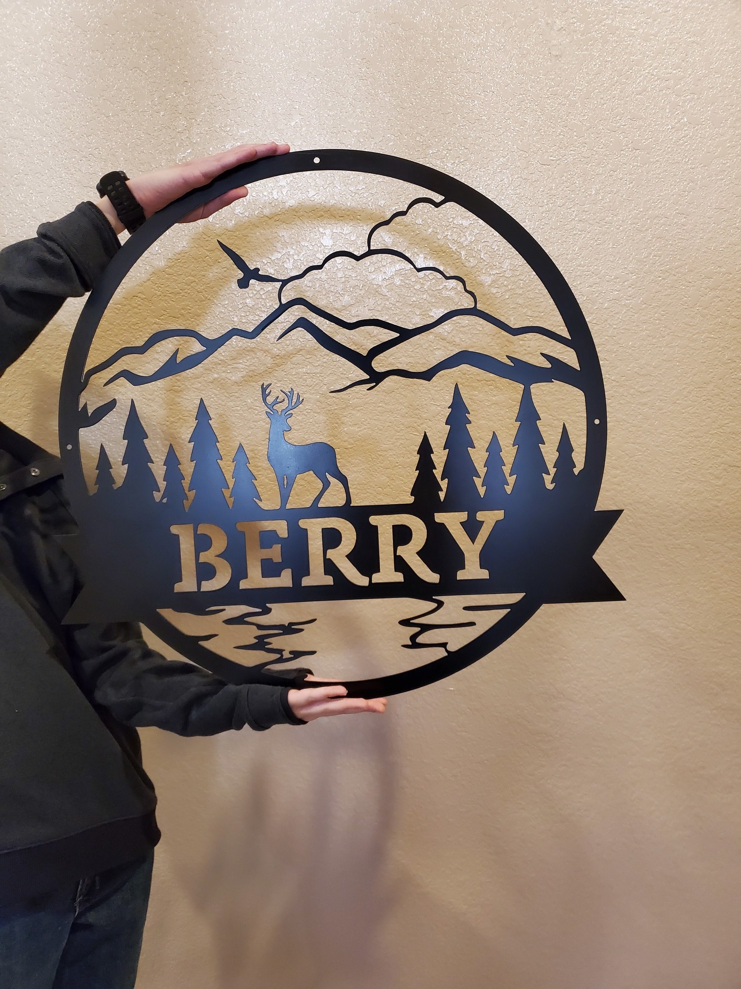

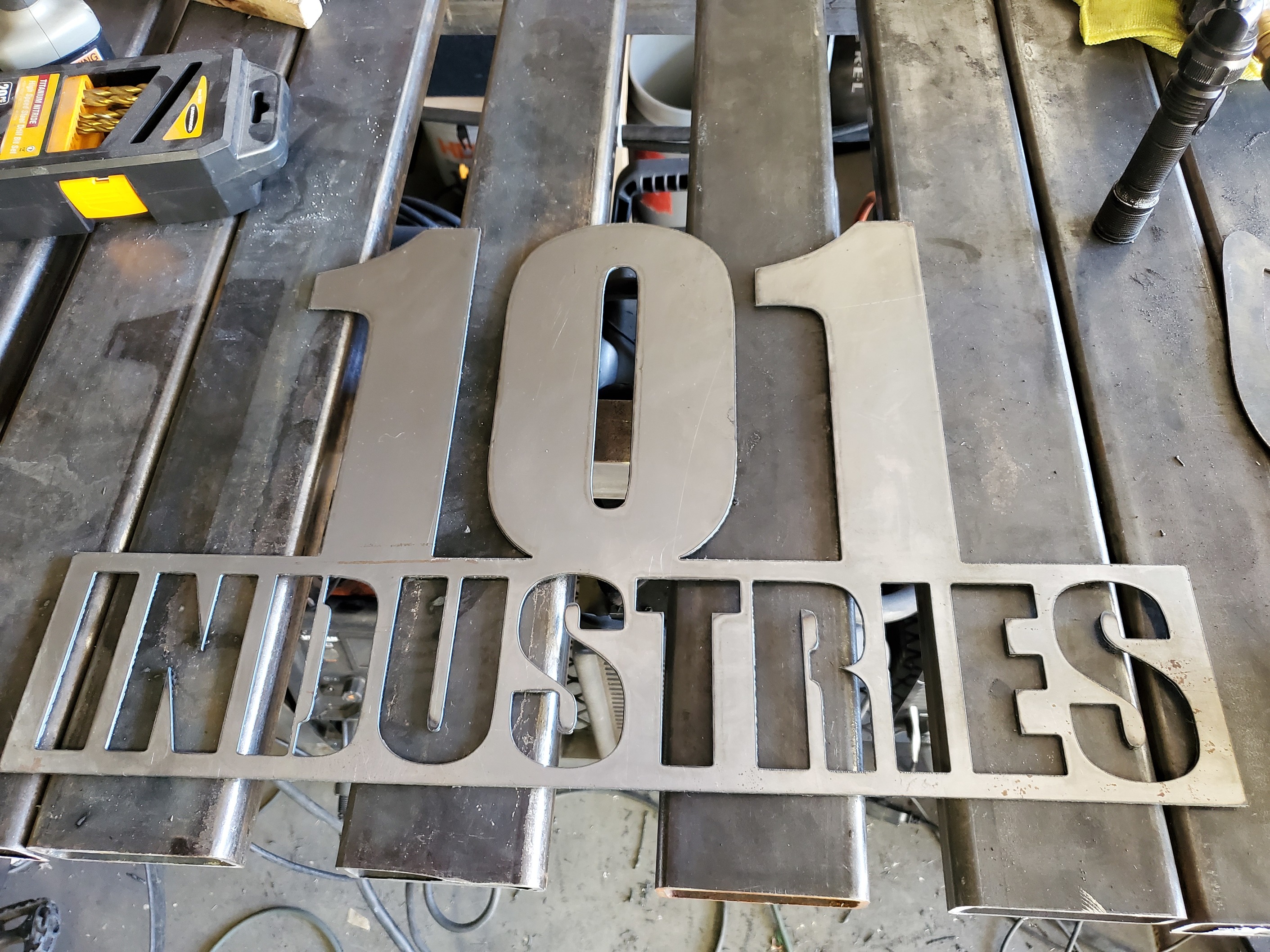

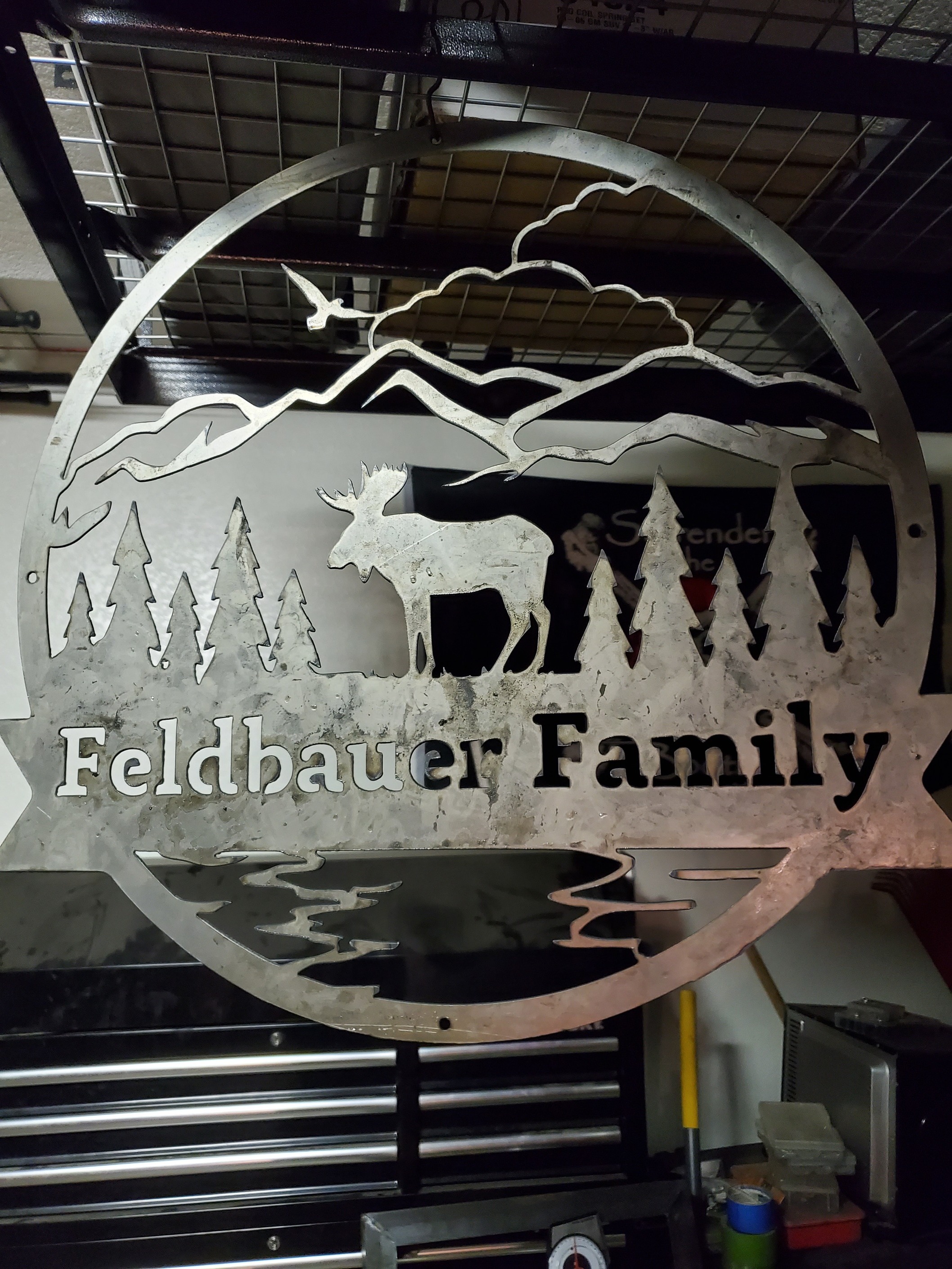

A couple small business signs. I’ve done about 20 of these for companies in Arizona and New Mexico

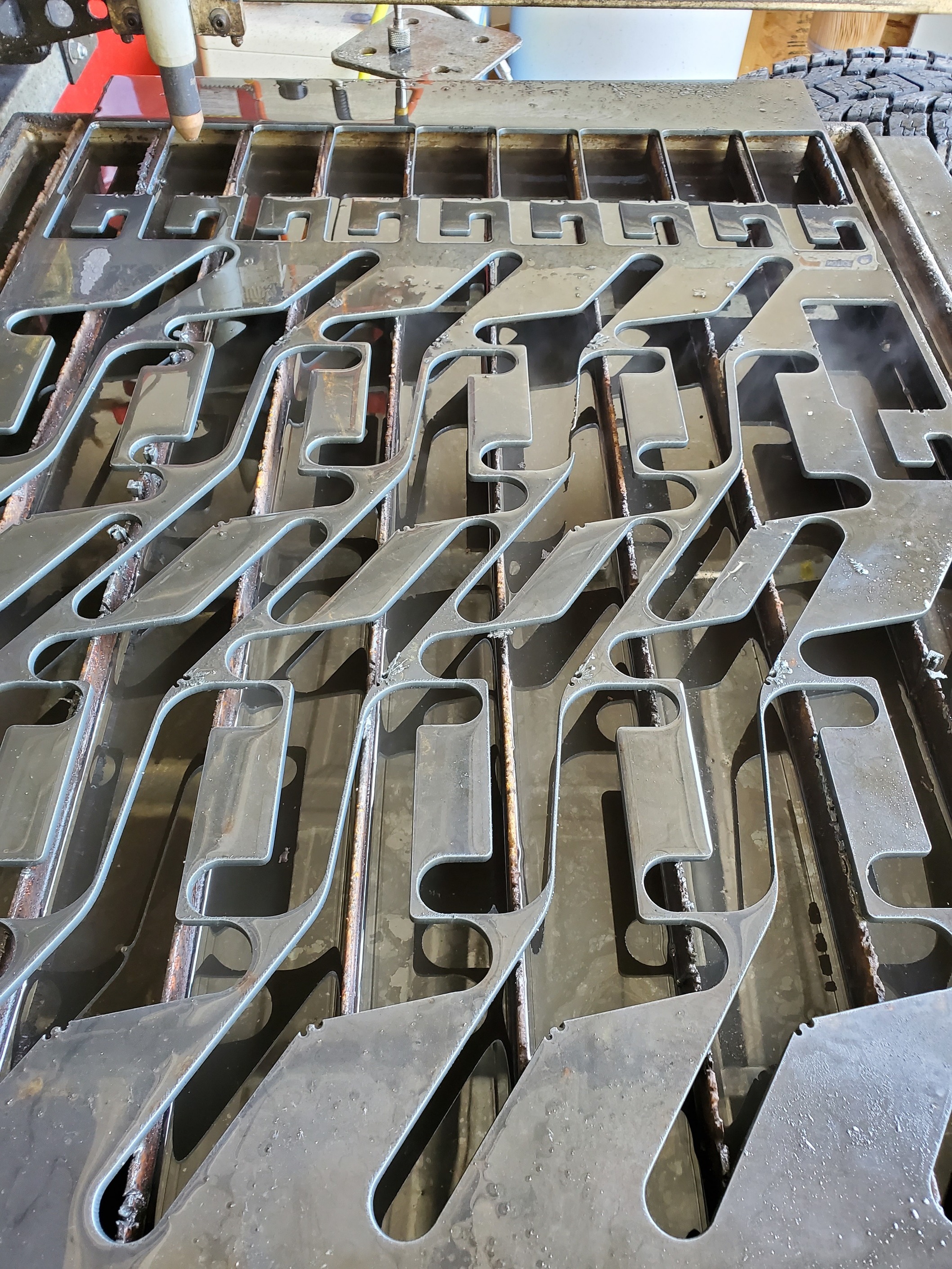

A little example of nesting. These are brackets for target stands cut from 3/16" steel.

Awesome! Nice stuff!!! They actually sell those target gongs at my supplier, thought they were a little expensive though, making them for yourself or selling them? What do you sell them for? And what plasma do you have? I have a Everlast 50s, not sure I could even cut them out, thickest I’ve cut is 1/4" as of yet, and that was only by necessity…
Thanks @Dicky, I have a Hypertherm Powermax 1000 with the retrofit Duramax torch. So essentially a 60amp version of the Powermax65 power supply with the same torch and consumables. It cuts like a dream, I can’t wait to get an 85 someday. I cut them at 60 amps with the 65amp nozzle and a shield at 30ipm.
I’ve been cutting them to sell but only when I can get drops. 1/2" steel weighs 20lbs/sqft so you can imagine anything bigger than a quarter of a sheet gets really unmanageable without a hoist of some sort. I’ve been selling the 10" gong with a folding target stand for $120. The gongs themselves are only about $52 on Amazon so it’s hard to get much more than that for them. I designed a folding stand with target hangers just to offer something a little different. Total cost to me is about $15 in metal, $13 in EMT conduit and 2x4 for the legs and cross beam, and $1.50 in hardware. It’s a great mark up and easy to cut and put together. I’ll post a picture when I get home today.
Awesome! thanks! I can’t remember the size, I’ll look when I go to my supplier again. I think he sells the 10" for about $38. I didn’t know they cost that much! I use bowling pins hanging from and A frame with a piece of rope, about 5 of them… Kids get a kick out watching them swing when they hit them!
At $38 it’s probably the 3/8" thick AR500. The price goes up quite a bit for the 1/2" but it’s supposed to take everything up to .338 Lapua without pitting too bad.

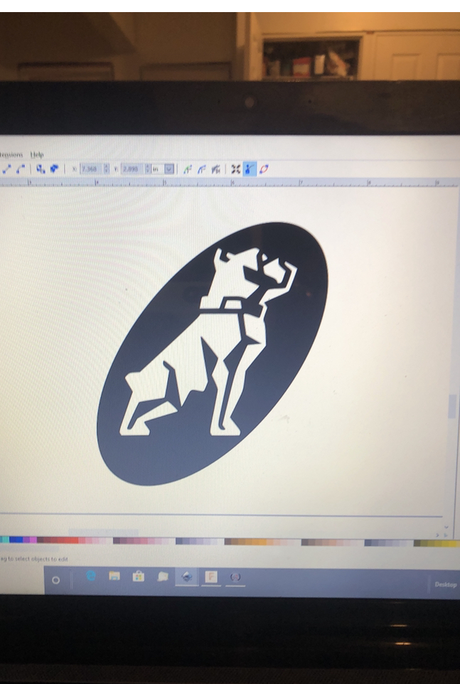

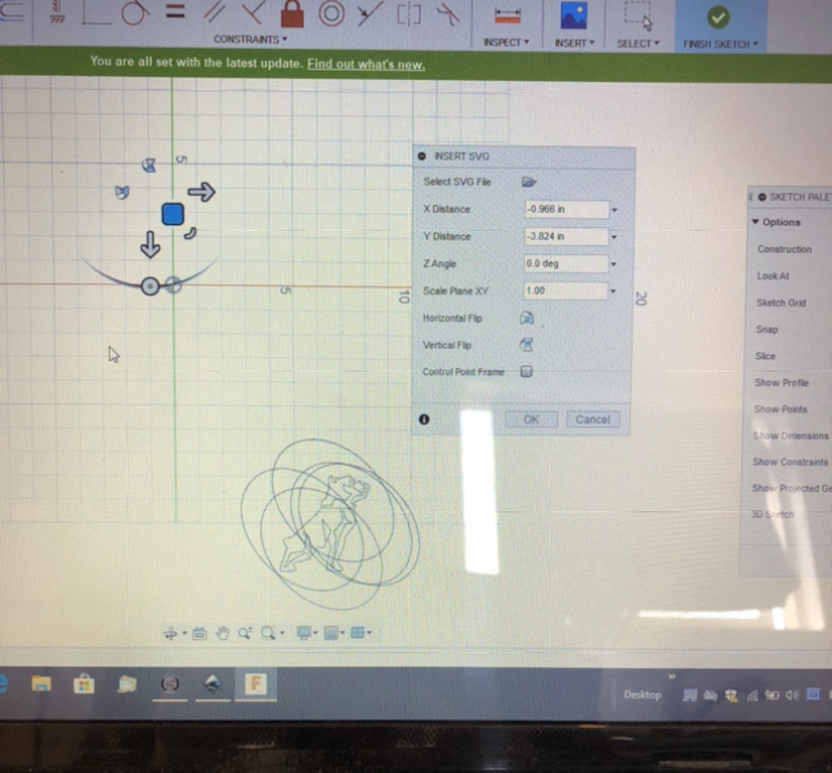

I just want to pass on a little advice about Inkscape. I have a habit of leaving the tabs open, and the other day I was making a Mack truck bulldog sillouette, and I couldn’t import it into fusion without a bunch of lines ! I tried everything ! Finally i restarted Inkscape and it all worked fine ! I’m sure most of u know this. I’m just a welder not a computer guy !
