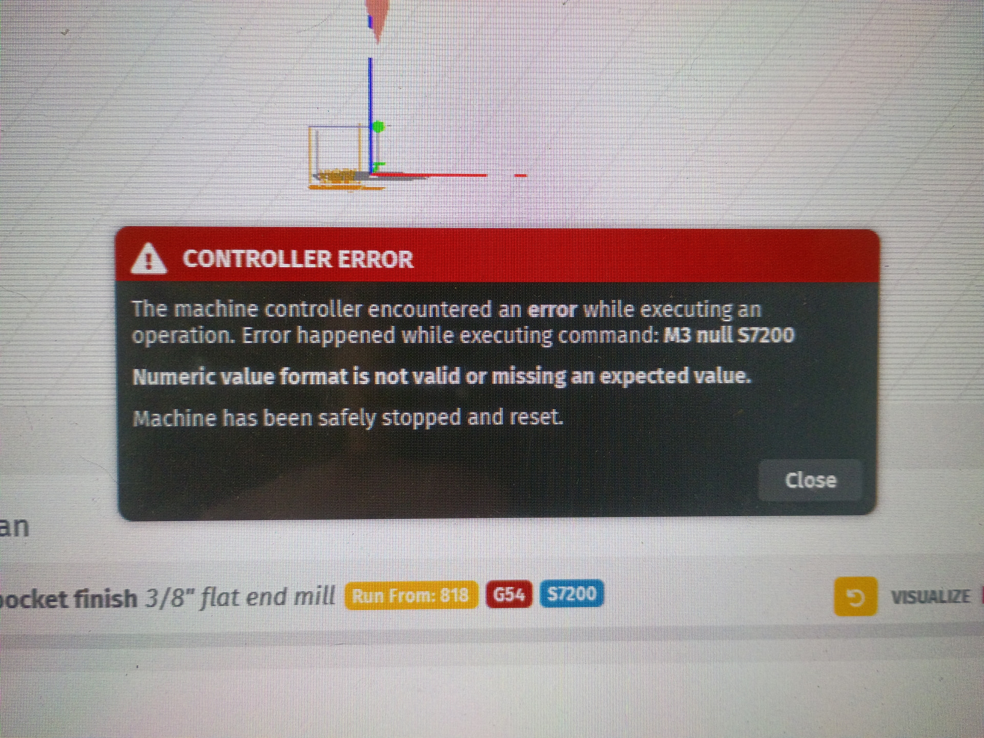

Start from line controller error
Ive never been able to successfully start from the middle of the gcode. I get this error. Any thoughts?
Sorry to say, me either. It has only happened twice to me. I just started over.
I’ve had this error a few times.
I was able to turn the spindle on first and then start from the line I needed. Kind of a sketchy work around, but it saved me having to cut air for 20+ minutes in those cases.
Oh thank you! Ill try that. Cutting air does infact suck
