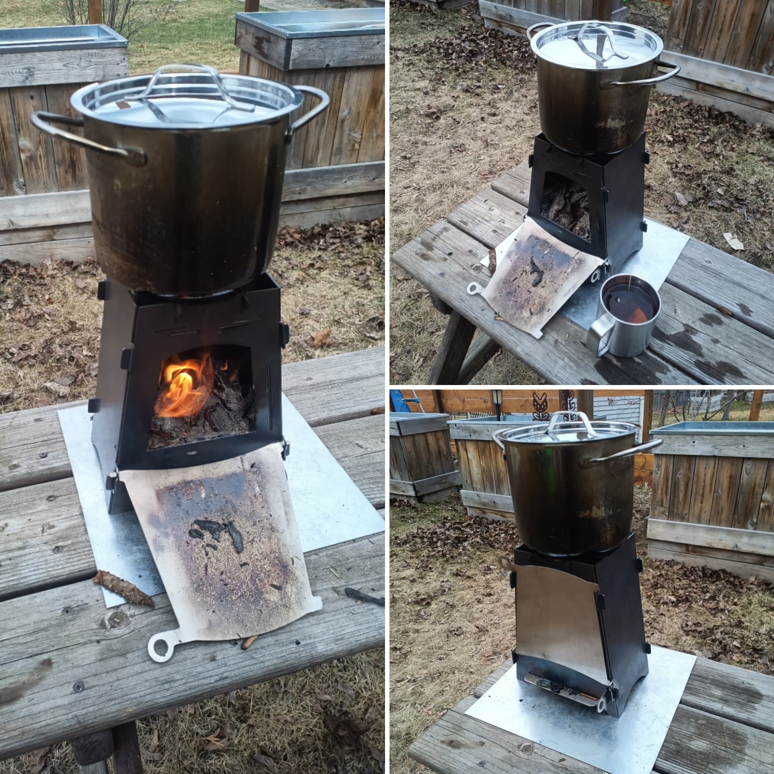

Here is another prototype stove.
Happy with the cuts and the clearance on the slots and tabs for this one.
Boiled some water made a cup of tea.
I’m going to do some reworking in fusion and come up in there another prototype soon.
I would have loved one of these when I was doing a lot of backpacking with my kids when they (we) were younger :slight_smile:
My kids have enjoyed these as I started to make and test them in backyard. Luckily we will be able to use them in the bush before the fire ban comes on.
Maybe a little heavy for backpacking.:muscle:
I’m going to do a few more iterations, post it and you’ll have the plan. Build one enjoy it in your backyard soon.
