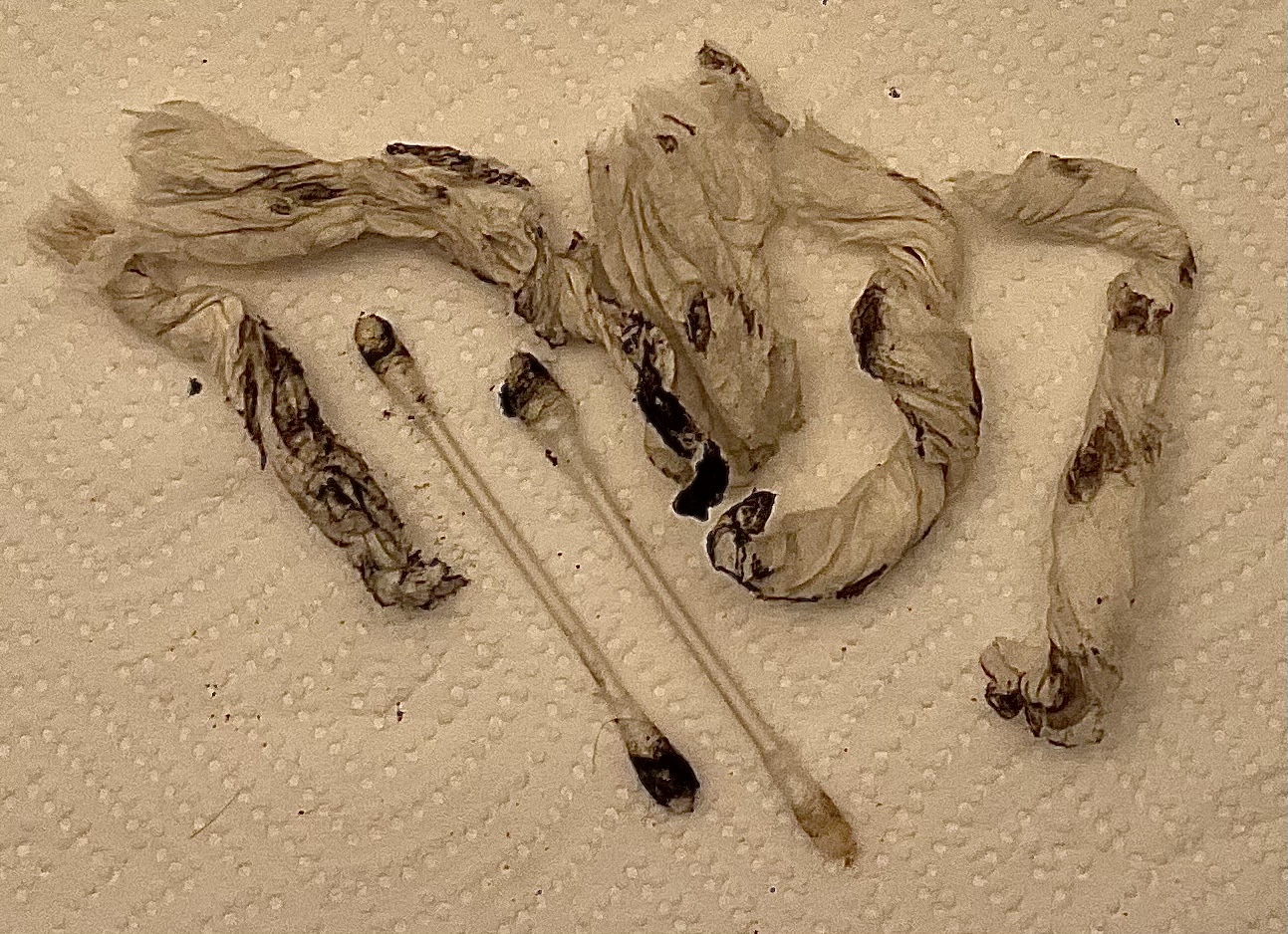

I would do more than wipe the inside.
This debris is what came from both ends of my unused spindle.

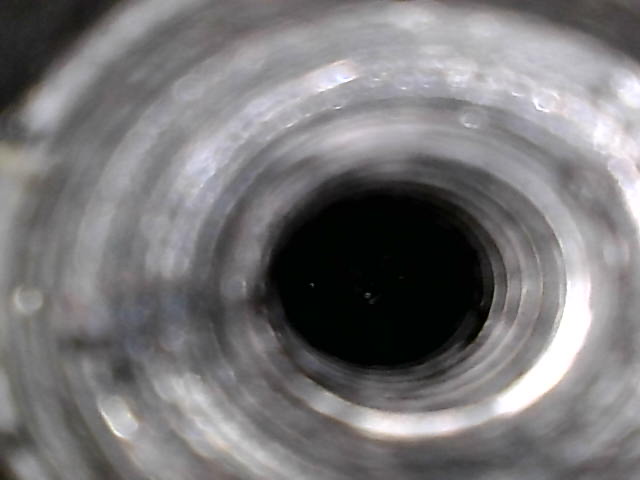

Not 100% clean yet but discovered some curious threads inside using an endoscope, possibly 1/4-20.
20230706213749
At present, I don’t have a proper dial indicator for accurately checking the spindle inside runout. But I got .0007” RO on the OD measured between the threaded portion and the wrench notches. Plus the thread OD measured almost .012” smaller dia. than safety3rd’s spindle. 23.80mm vs 24.097mm.
