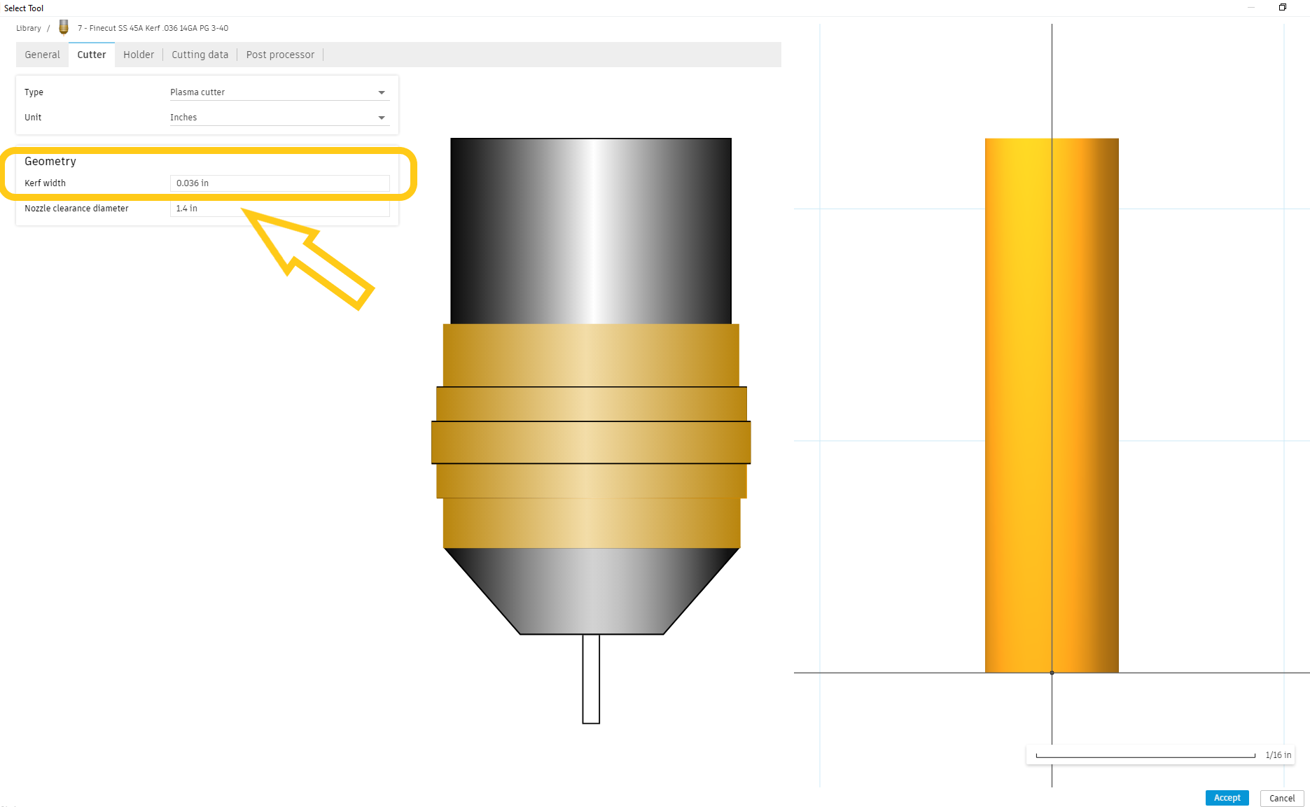

Today, I cut some simple exhaust flanges, two of the holes are 0.5" holes, and were drawn that way in Fusion. During toolpath generation, I used 0.060" kerf for the 1/4" plate being cut. The hole size came out at 0.45XX", so I adjusted kerf to 0.055", and then again to 0.050", and each time the hole size still came out to 0.45XX" diameter. Each time, I started with a new nozzle and electrode. Same air pressure. Same amperage. Same machine. Same everything. I am very confused and extremely frustrated, as I ended-up having to destroy two drillbits to ream out all the parts that I cut today.

Where are you changing your Kerf setting?
You need to increase the hole size by around .050", so decreasing the kerf by .010 is not going to get the result you want. Decreasing the kerf by .010 will theoretically give you a .020" larger hole. If you want a .500" hole that you don’t have to drill after cutting, you should factor in some taper to your design and program a slightly larger hole.

Is this where you are changing your kerf width settings?
and compensation type is set to “in Computer” ?
lf f360 kerf
I think it would failed to load in Firecontrol if it is set to “in control” anyhow

It looks like I made two major mistakes:
(1) Bad math, as 0.45+0.01 is not 0.50 :joy:
(2) Kerf angle on 1/4" plate is huge and
calibrating the kerf is not the same thing,
so I have to change the 3D design shape.
Thank you!!!
