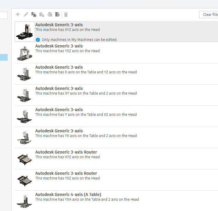

So, i am just wanting to make sure im choosing the best possible option here.
I have a model completed and have it setup in all area accecpt the machine.

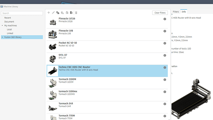

There is a few gantry router type setups that i am thinking i should choose. But they say they have a XYZ with a B on the Z axis. I am leaning towards the basic 3 axis generic at the top but i want to make sure that im picking the right one. My worry is that if i pick a 3 axis one it might not process the code for the second Y motor.
Anyone got advice. An exact example of what to use that works would help.
I plan on trying to build the MR-1 Dumbed down machine model and use that but id like to get this up and cutting first. Anyone that has such a model would be a life saver and i would be in your debt.

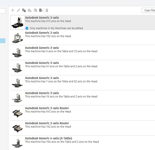

Welp heres the ares of models i was looking at.
I use both of the two top ones of the second picture with XYZ on the head, I haven’t had any issues. in my experience they both act the same
@WorkNPlay Thanks a ton, used the top xyz model and works perfect.
