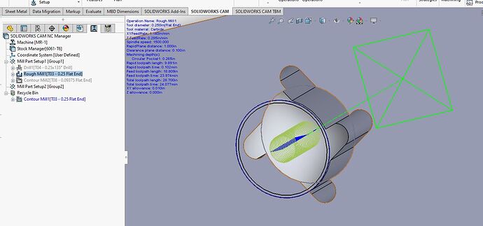

Hi, im complety new in CNC machining and im beeing reading this forum, but theres an issue i still cant solve.

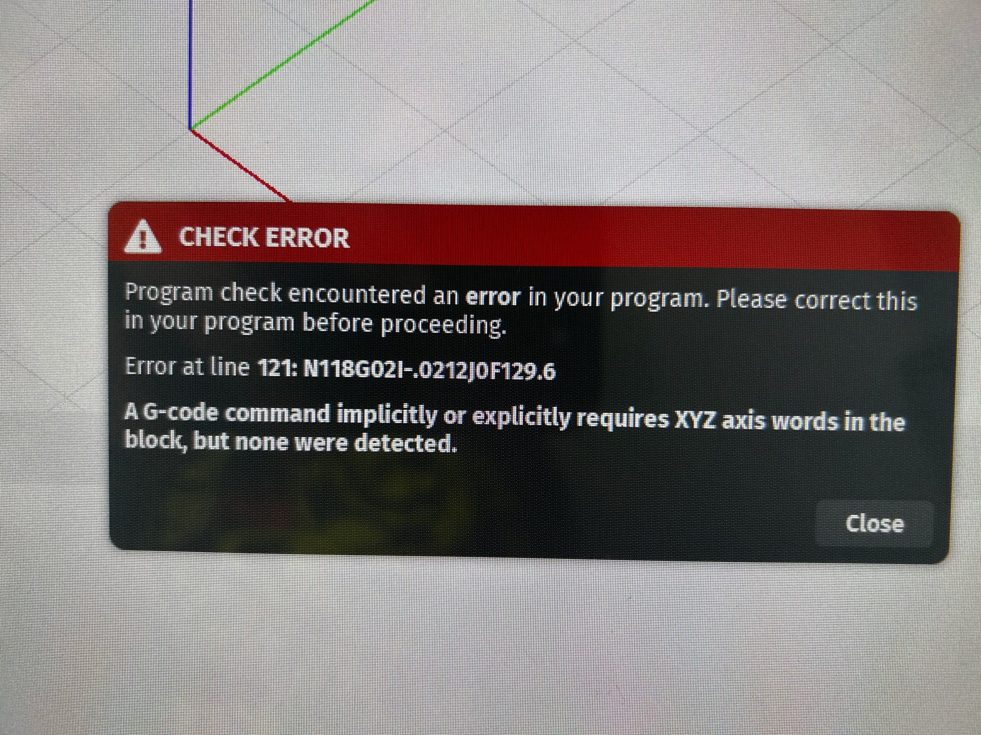

I cant cut circular pockets, cut control software gives me this error.
How can i solve it, wich is the correct Gcode in Cut control?

What post processor are you using because the Langmuir mr1 post they have on their site puts out code that doesnt use the N line numbers beginning when using solidworks. Here have an example of a circular pocket from a .25 endmill I just made that worked on my machine here.
.25 endmill 2 thou under 009054.txt (6.0 KB)
