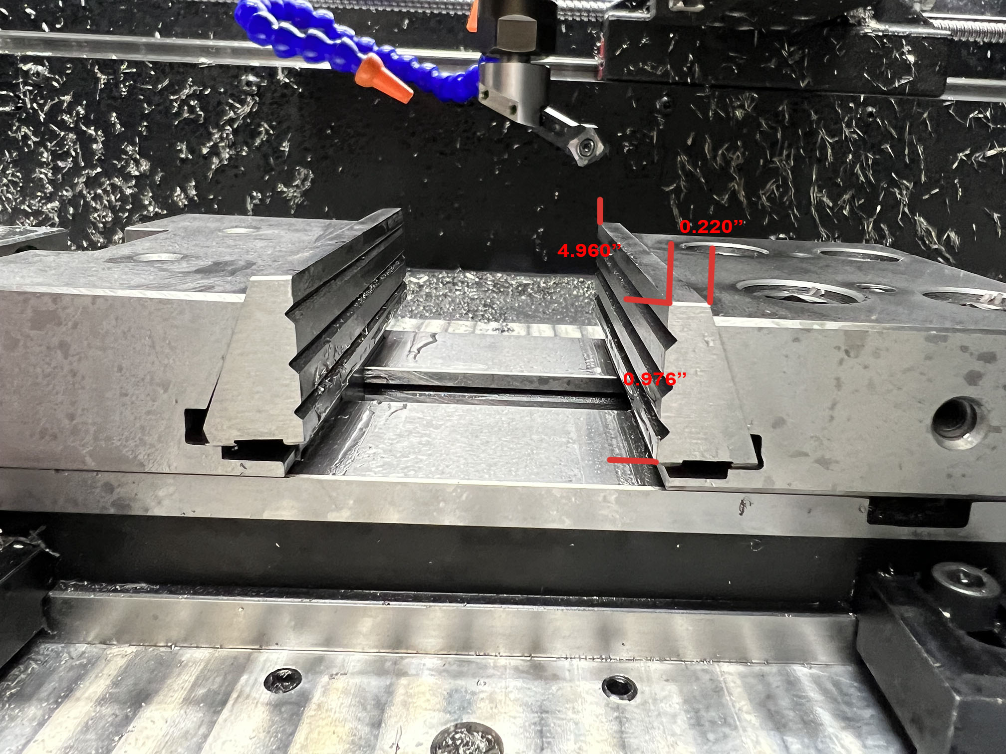

Does anyone have the dimensions for the jaws on the low profile vise ? i need to make a set of soft jaws but i am not near my vise at the moment.
Here are dimensions of the face and top edge if you are looking to make slip overs. If you want to replace the jaws with softer material, that would require disassembly and multiple measurements for the angle, bolts and bottoms springs.
Awesome thank you and the slip overs should work fine for my instance!
