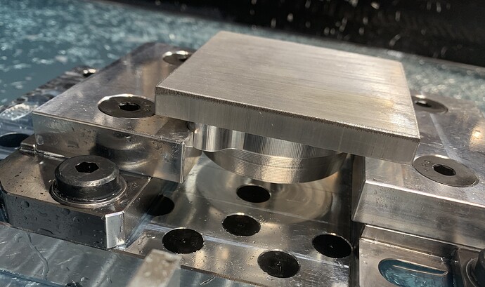

How are people doing softjaws on the low profile vise? Want to start making things…
I did my first softgels today. It was a lot of learning, but it worked out really well.
Airplane wheel cap is looking good.
Looks great! How do you tighten the vice? I made a set a while back but only replace the front of the jaws.
I just followed the video directions on SMW website. Seemed to work fine so far.
Looks great. I’m referring to the langmuir vise though. I opted not to get the SMY setup based on previous experiences. It gets the job done but is time consuming.
Langmuir- are you guys planning on making soft jaws available for your vise? Maybe sell new hard jaws with threaded holes to accept soft jaws?
yea, i would love some softjaws for the langmuir vise since my first cut i hit the damn harden jaws lol

A custom vise jaw made out of a material that is softer than your workpiece (instead of the usual hardened steel jaws machine vises are usually). You will often see them machined to match the profile of a round part, so that the can grip an in-progress workpiece and not marr the surface.
You still want rigidity, so soft jaws for steel parts are often aluminum, and soft jaws for aluminum might also be (a softer alloy of) aluminum, or hard plastic. Soft jaws for plastic parts might be made of soft plastic or rubber, and so on.
