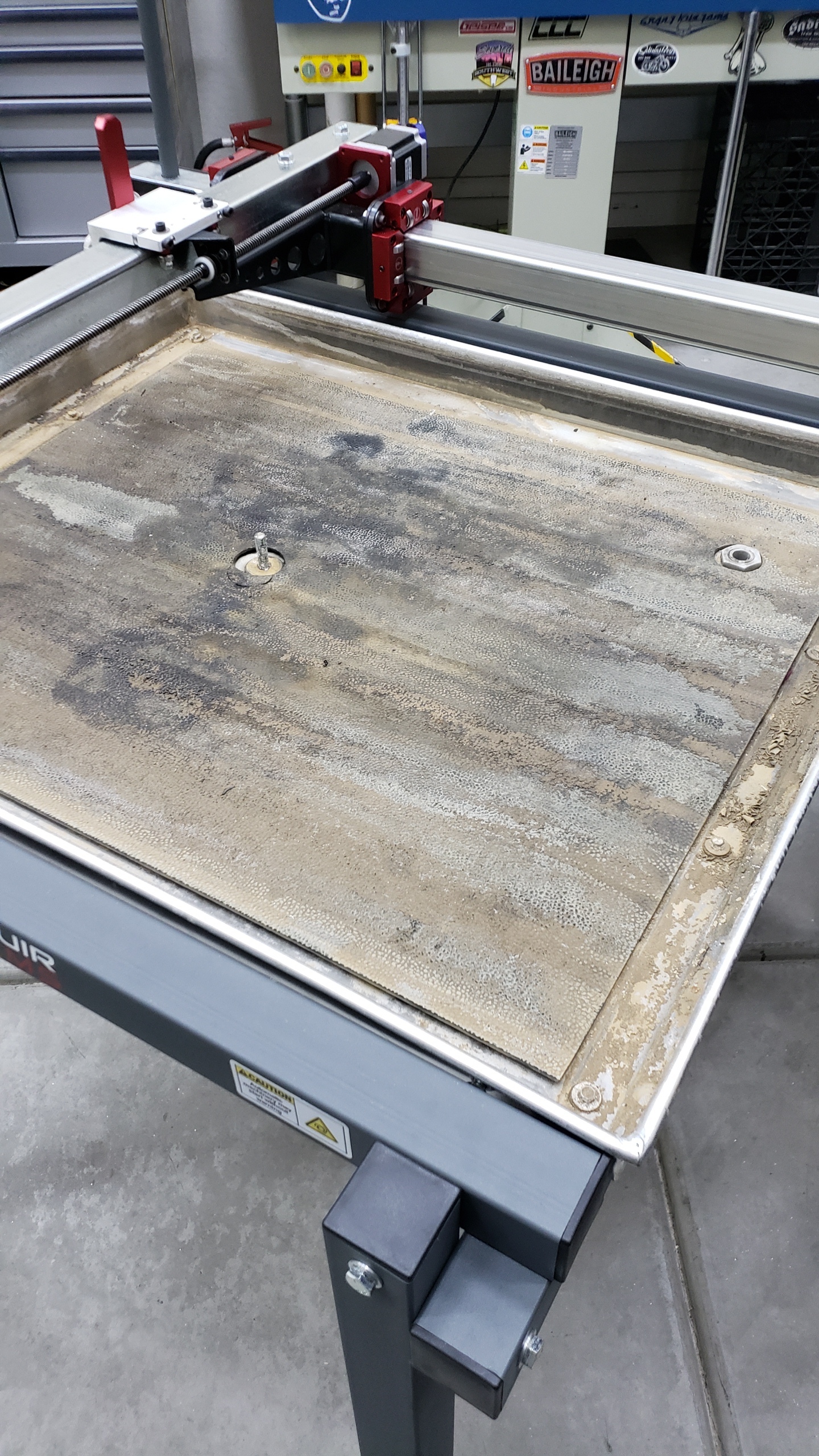

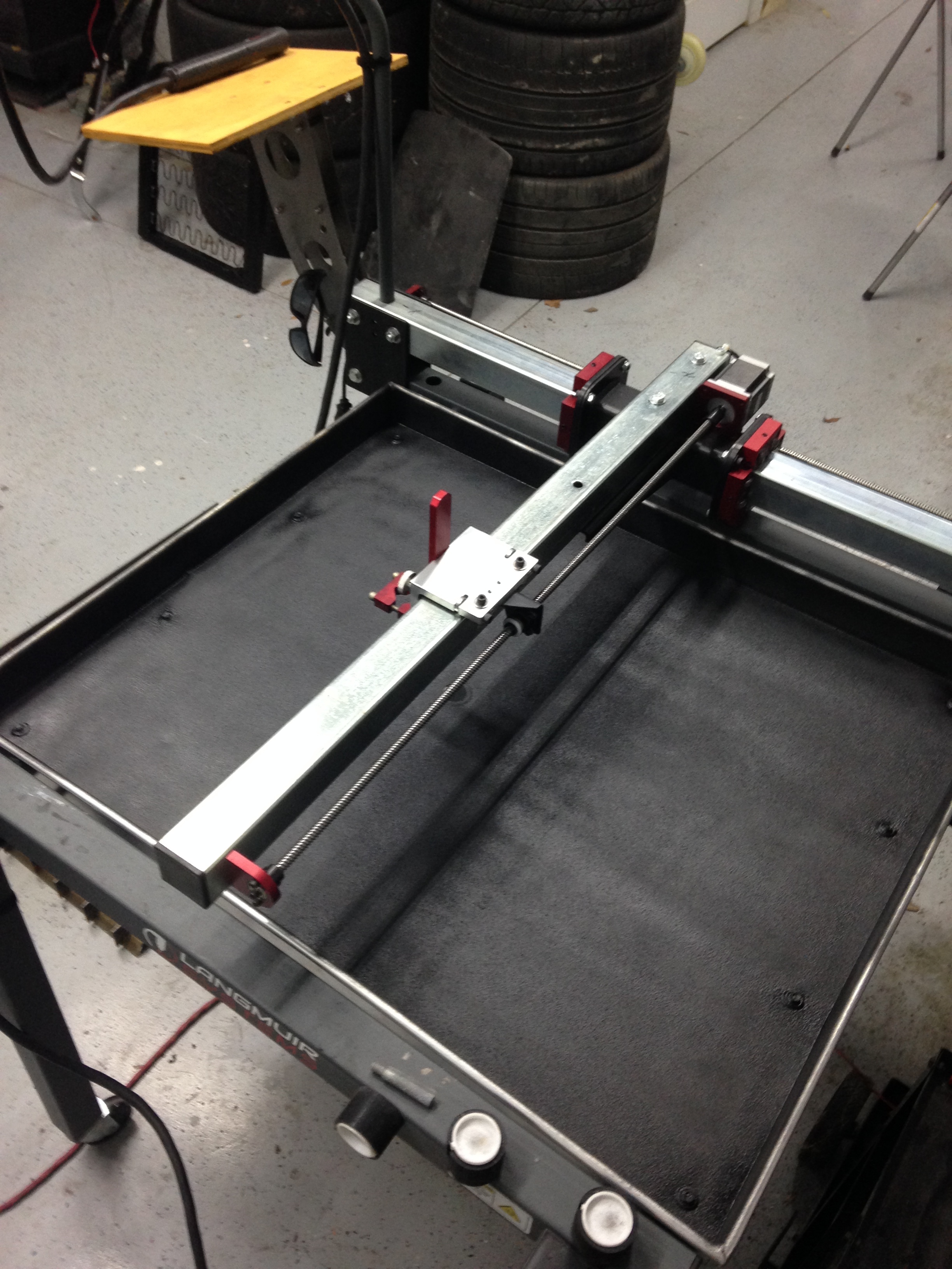

I noticed that too, not really pitting but some good and stuck on debris, that takes a good scrubbing to get off. Richard Horn was by today and noticed I have a thin rubber mat in the bottom of the tank (between the two slat rails). It makes it real easy to just lift up and bust up the debris once it dries over night. Nothing building up underneath either. or corrosion. I also don’t leave the mix (+8.5ph) in the table for more than a few days if I’m not using.
Mirage2991, have you checked the ph of mixed water?

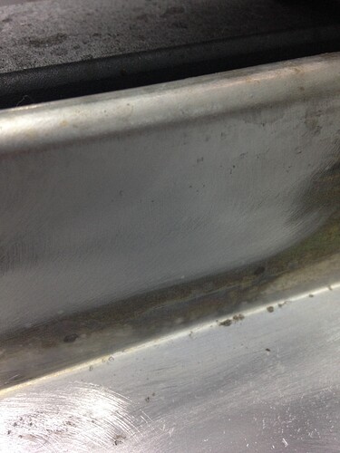

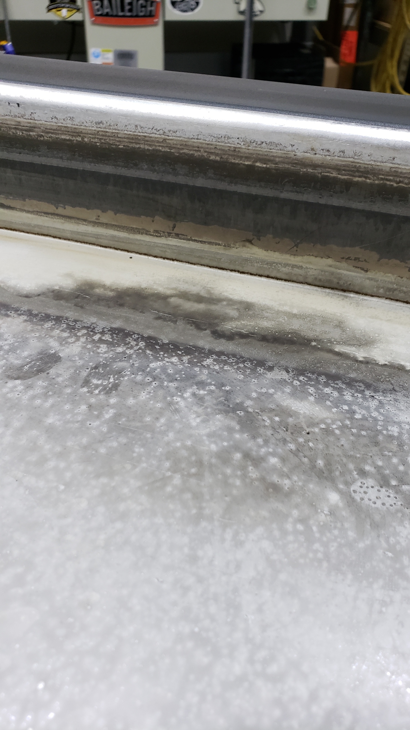

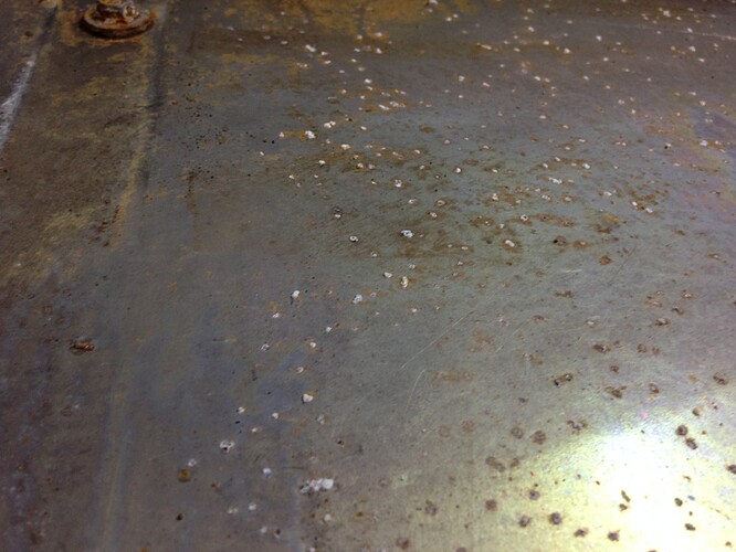

I have not checked the Ph of the water. I can’t stress enough though that the sides of the water tray even though they were submerged have no signs of pitting…no signs of anything other than a light tan appearance that I can almost wipe off with a rag.

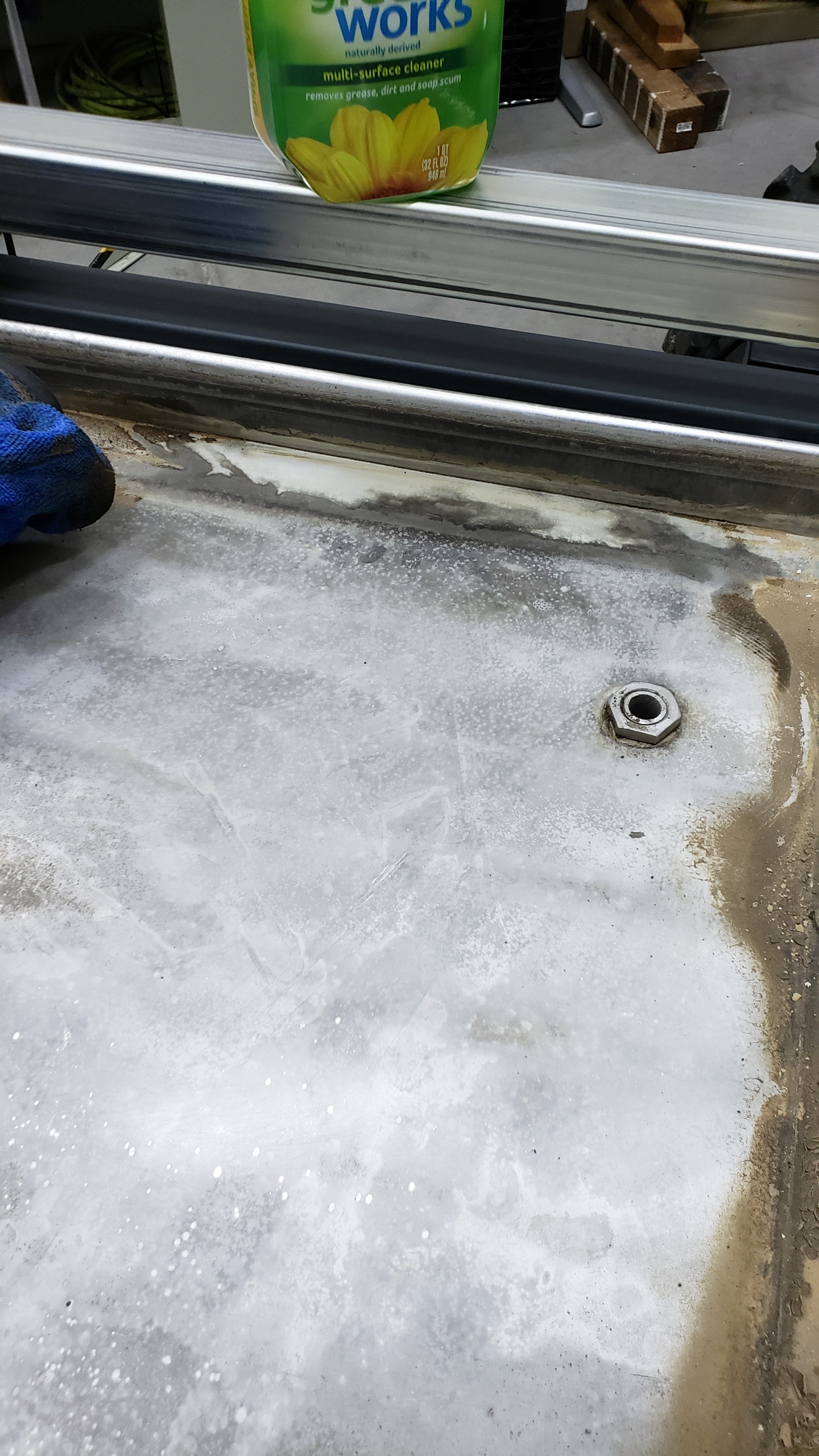

My table looks woorst than EdS’s picture above…I put some Navel jelly to see if it would help, didn’t do much, does clean the alum really well though, but nothing for the stuck on particulates…

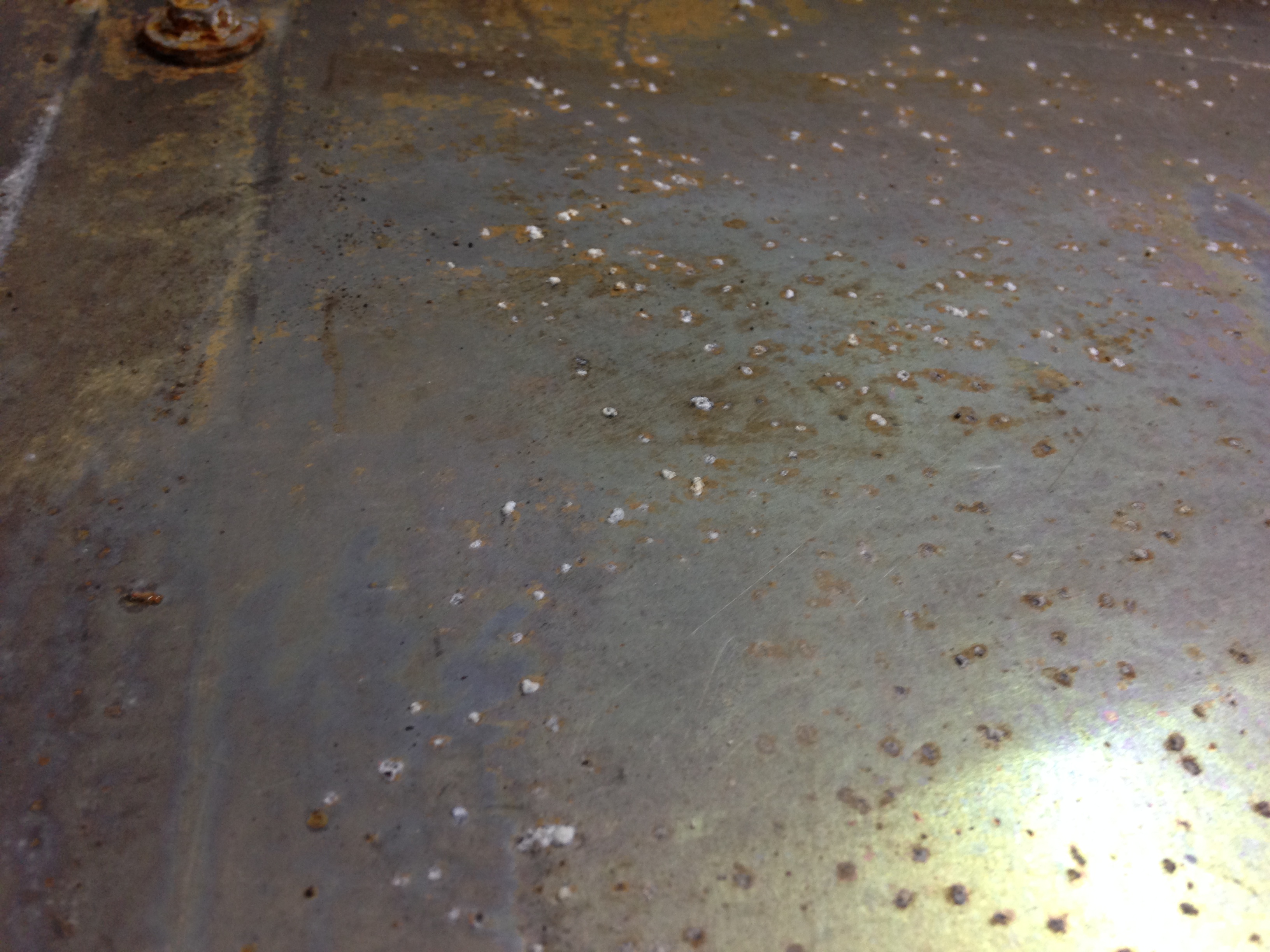

I think EdS is nailing it with Galvanic corrosion. Because this is happening at the bottom of the tray, and not the side, this is pointing out being Galvanic corrosion, which I’m not sure how you’d mitigate other than emptying and cleaning…at this point, one would have to wonder if we would have been better off staying with a steel tray.
The slats (steel) look great, little to no rust…no pitting.
I’ll take up my mat tomorrow and give it good wipe down to see if there is pitting occurring and get back to you. I do keep the anode clean and don’t allow much build up. I also don’t ground through the pan, but not sure that is a factor here though. Another thing to add, you really do need to have a proper ph if not running straight water. I also would think that the oxide film on the aluminum is doing better to protect it than cleaning it back to bright with a caustic and re exposing it to the atmosphere.

yea the Navel jelly was to try and see if it would help loosen the metal globs stuck on it, not an attempt to make it shinny again :slight_smile:

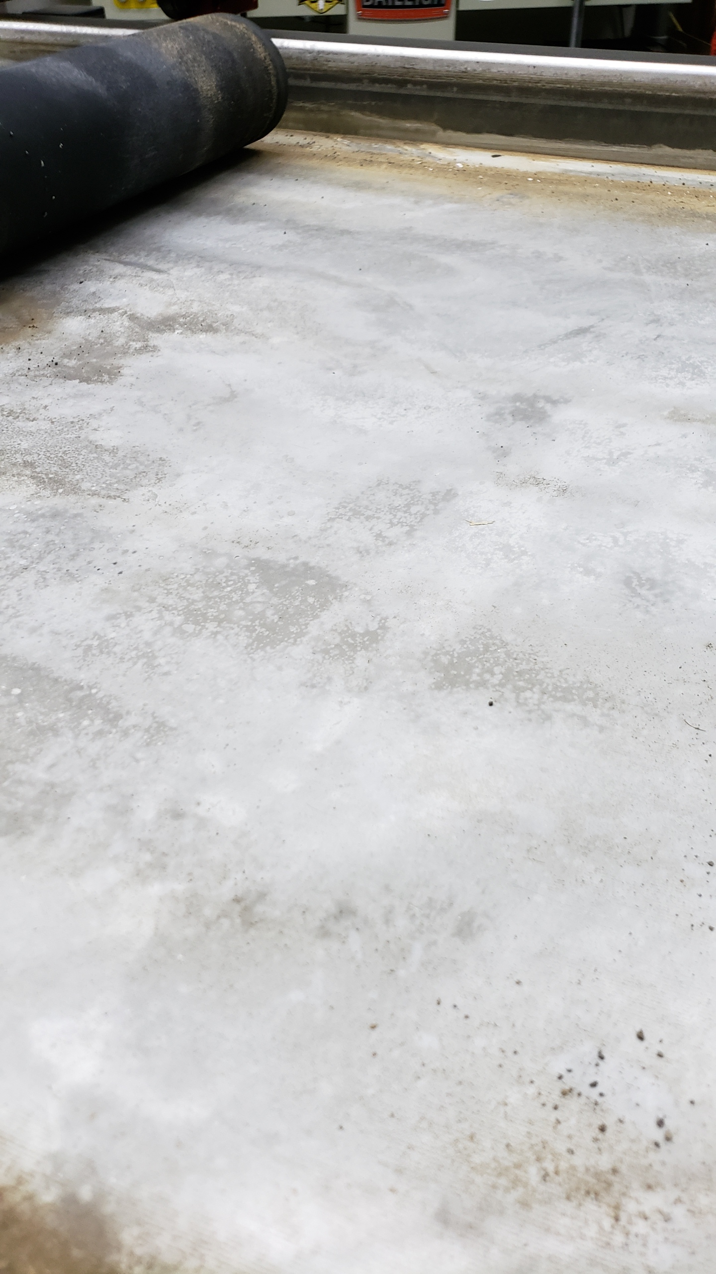

Got me so interested, I went out and pull up the mat. lol.

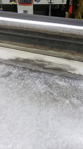

The gray coating is smooth and looks like the same as on the side of my dads AL fishing boat or my buddies pontoon (that he spent a month polishing on). slight_smile:
It looks ok under there with no pitting or the appearance of it breaking down. I chose the mat just because it’s much easier to vacuum out the junk. Kinda amazed or bewildered by the super fine brown dust that builds up.

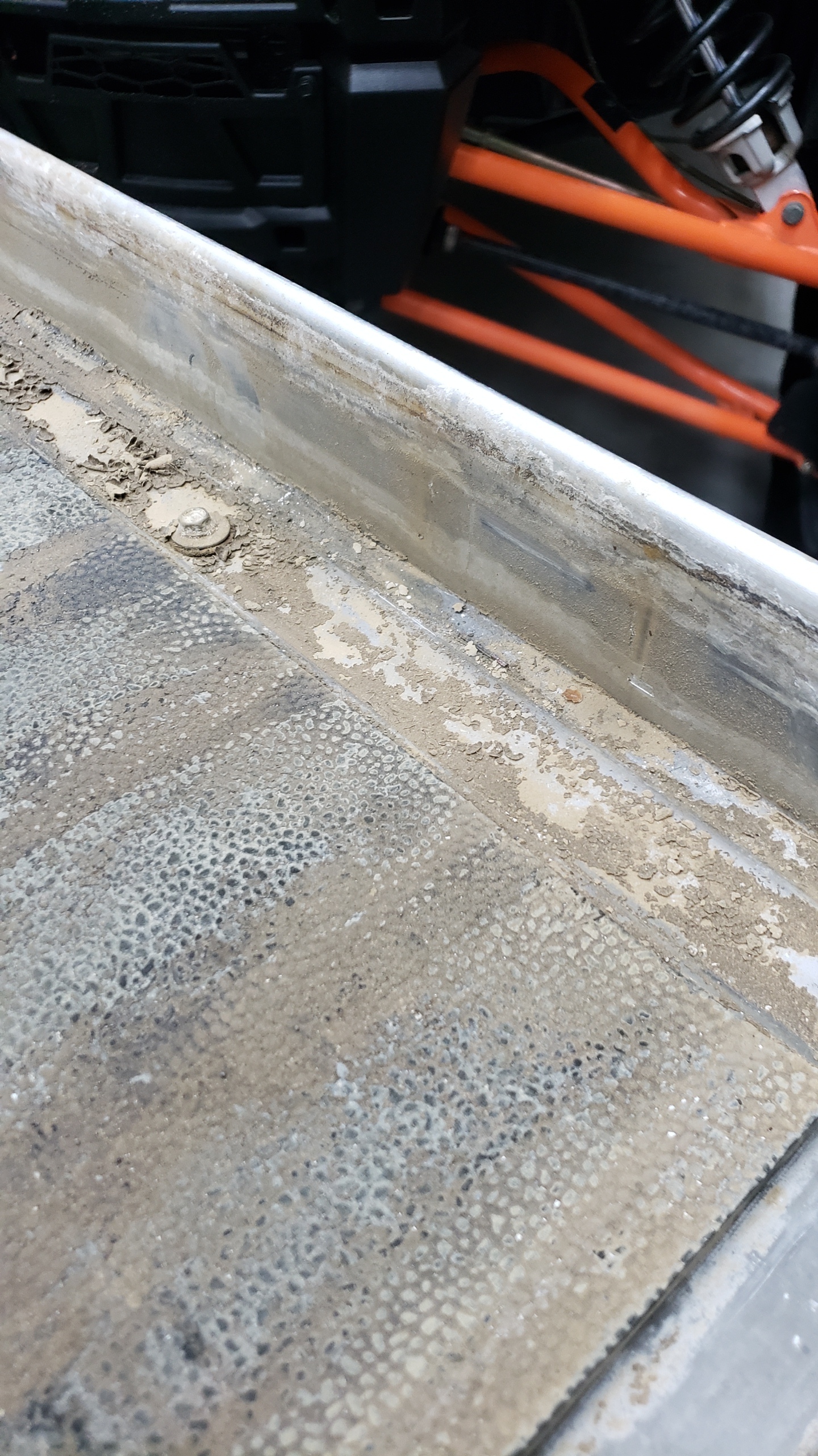

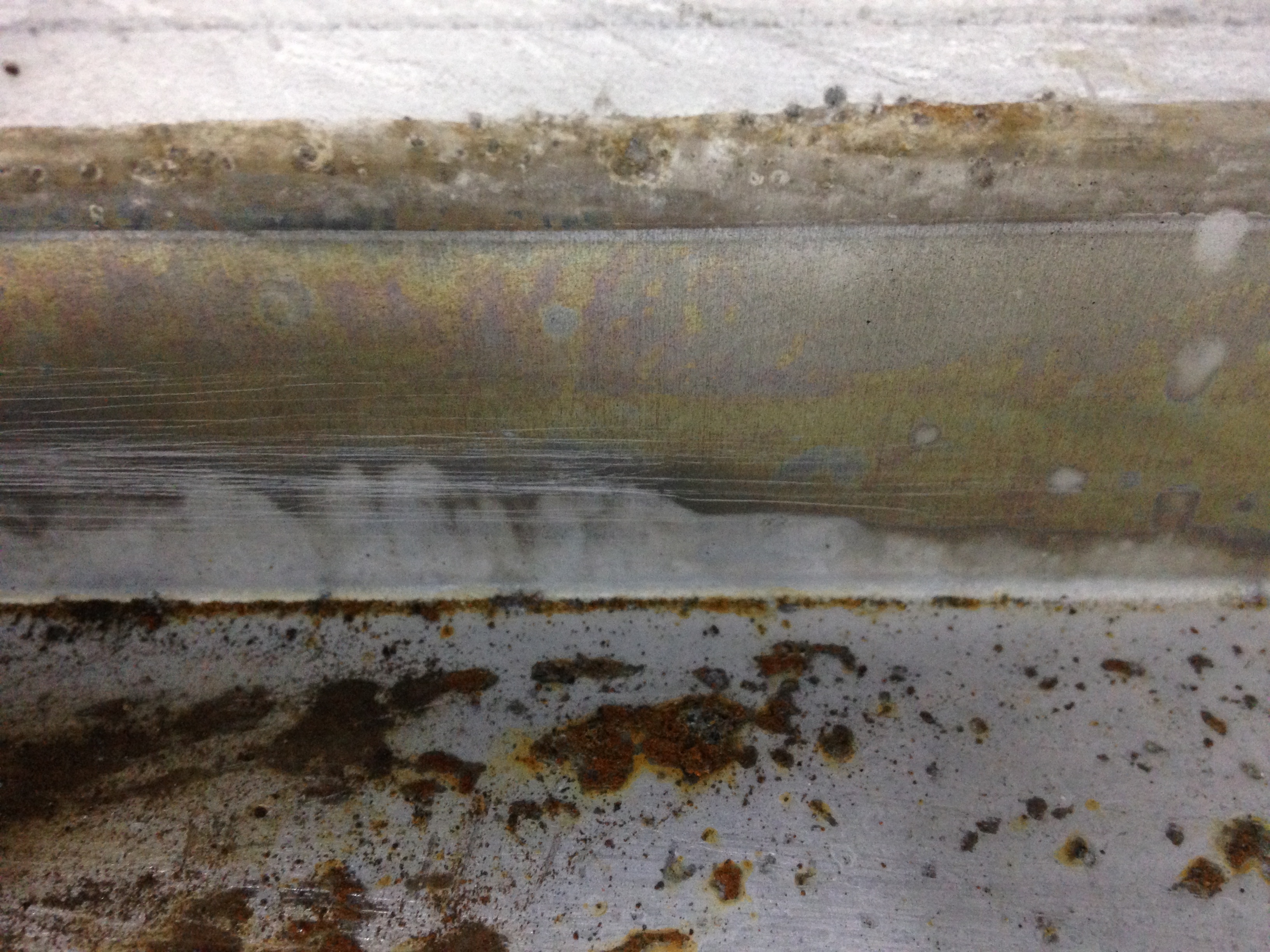

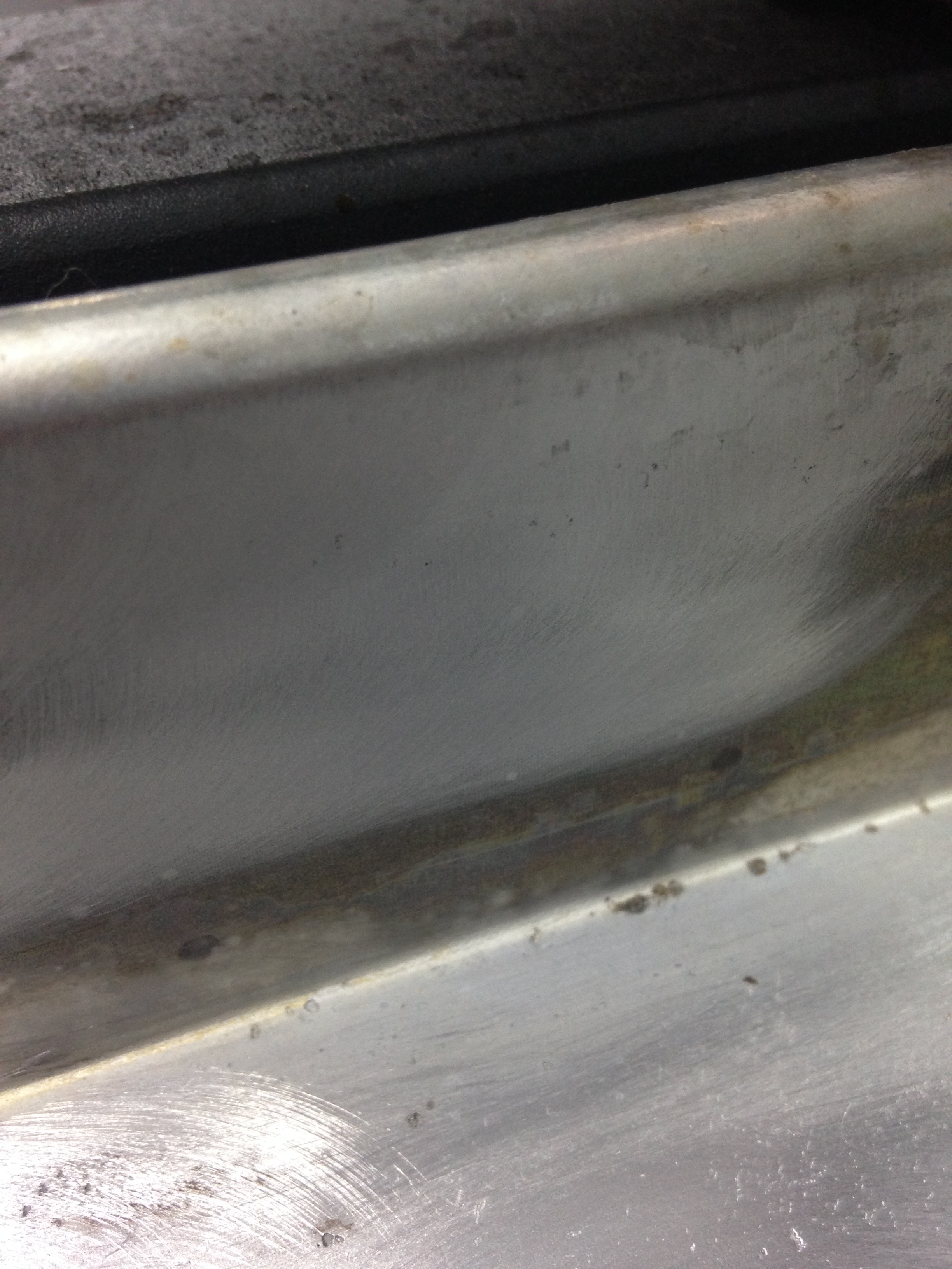

side of water tray, no pitting, while bottom shows embeded steel (brown). This is the corner i do all my cutting from
opposite side cornere where i never cut

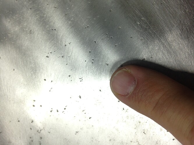

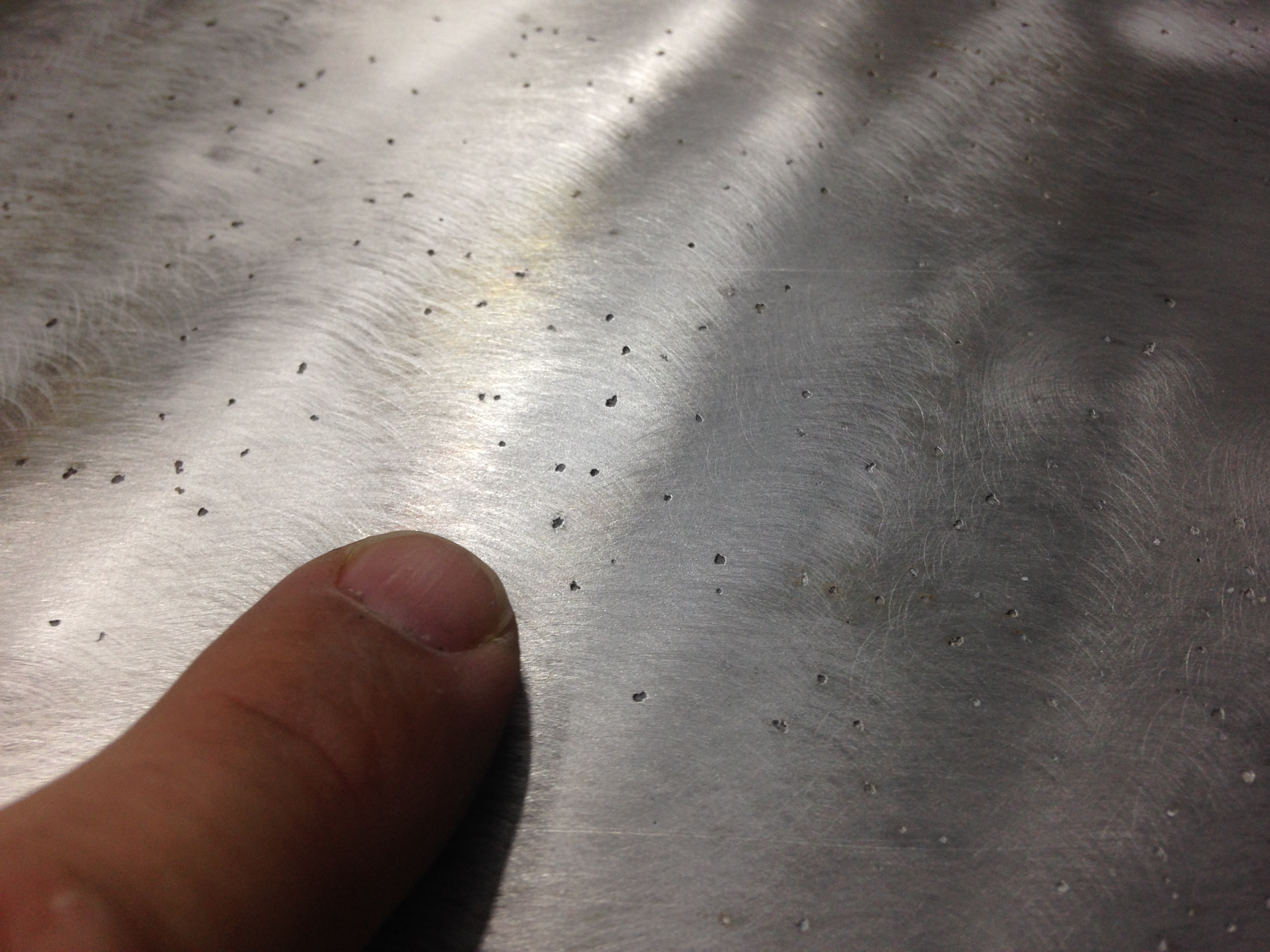

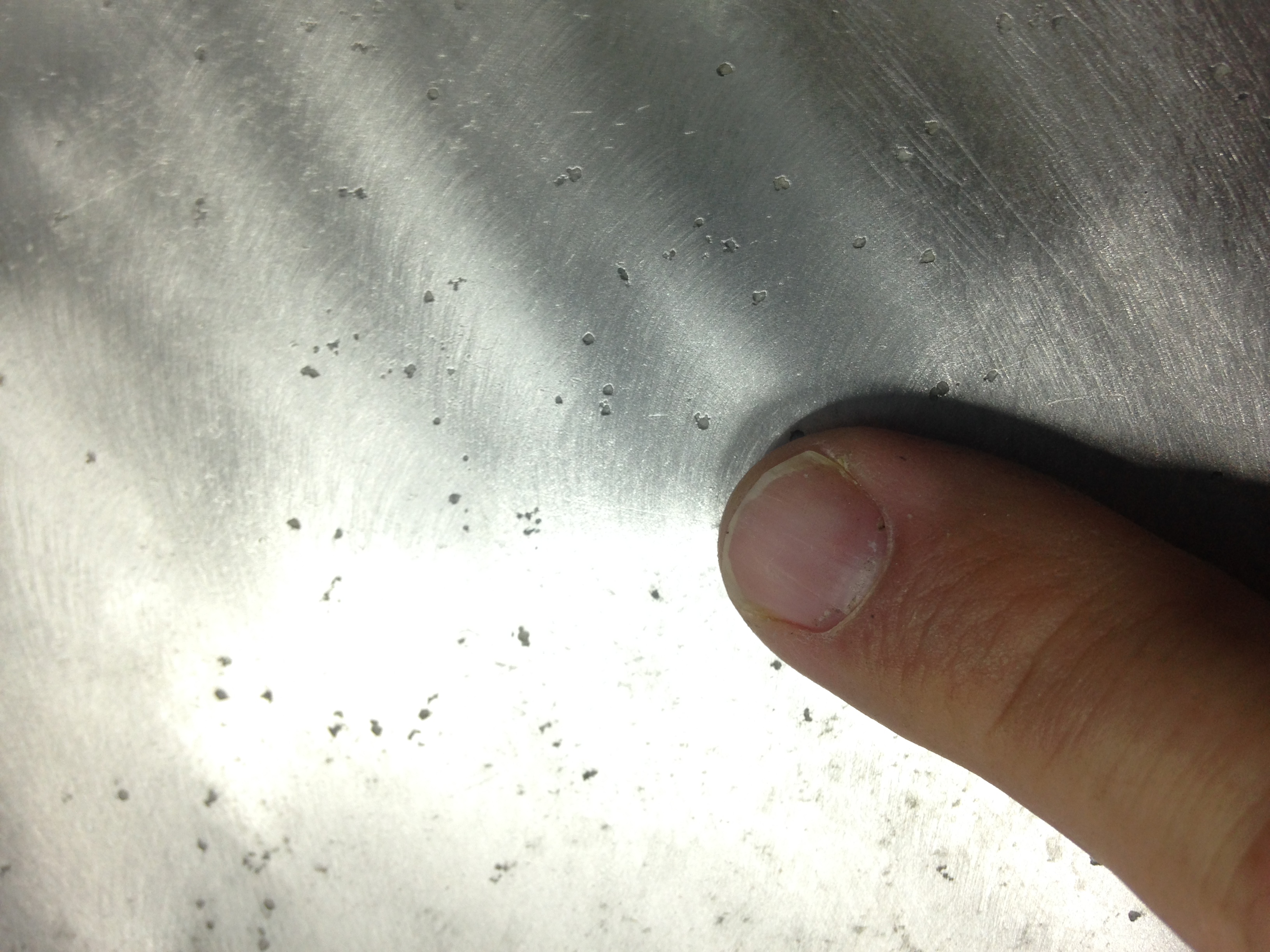

after using a cleaning wheel, same places as above, the steel will come off, pitting is left behind. The sides have little to none.

i have a can of bed coating i will be spraying onto it to mitigate the issue for now.
Straight water it is, and dumping it after use. Table was in water for 6 days, then 4 days dry, then 6 days again. Total cut time probably 5min.

all done. Drying out for 24h now.
Very nice man! Bet that will be the solution for sure.
I’m sure you are onto something with the Ph as well as having a mat which helps against galvanic corrosion. With my tray already pitting, I didn’t want to risk it. I have no idea how the canned sprayed bed liner will do (Lowe’s was out of flex-seal spray on). I also thought that Rhino lining the inside of the pan could be a good, long term alternative. With such a small area it shouldn’t cost much to have it done. Some to think about for next time!
