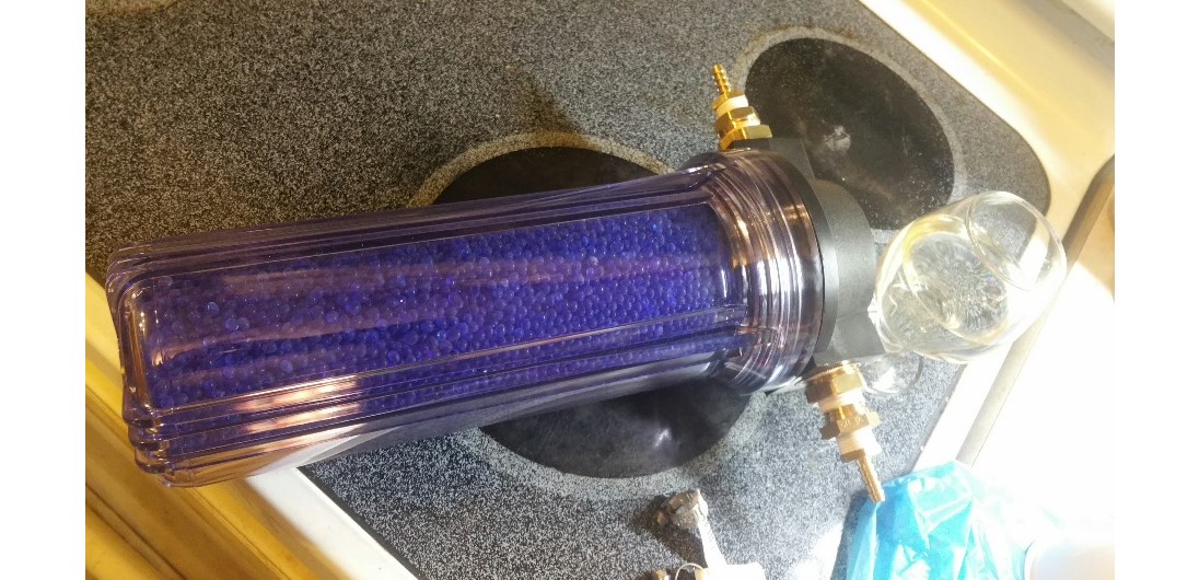

So last nights DIY project was a desiccant drier :non-potable_water:

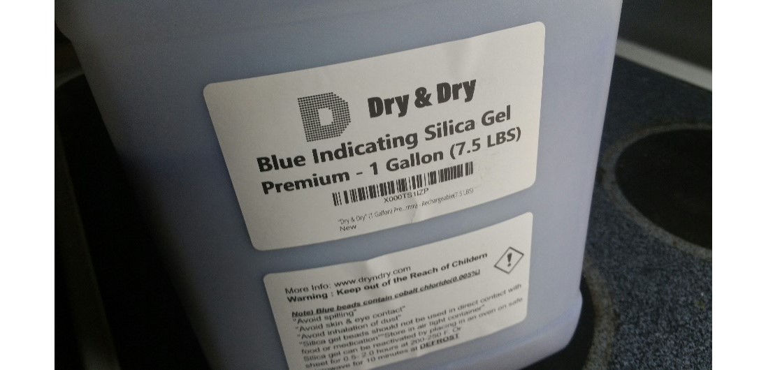

So take 1 of these off Amazon

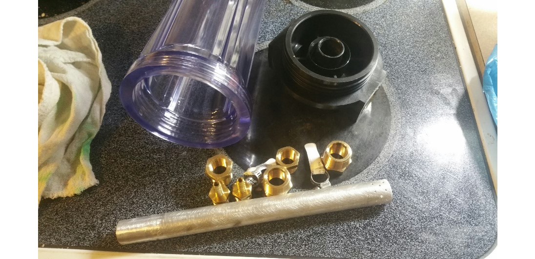

some of this also Amazon

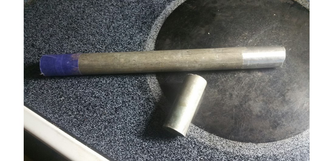

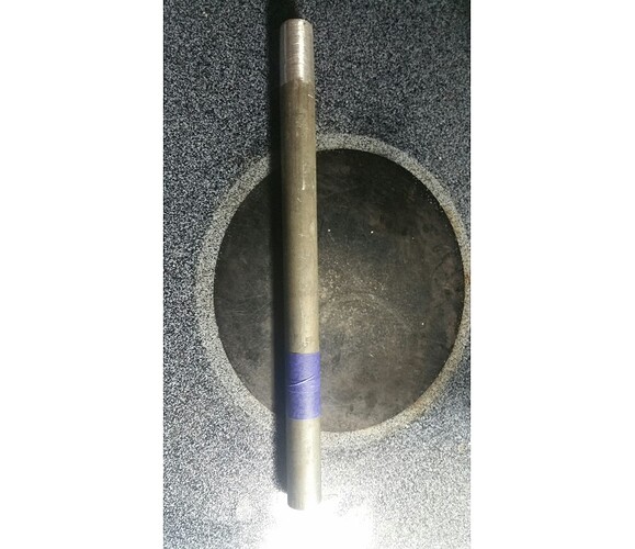

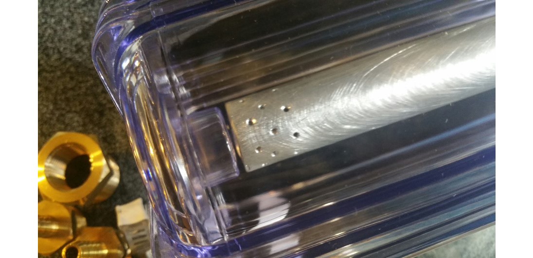

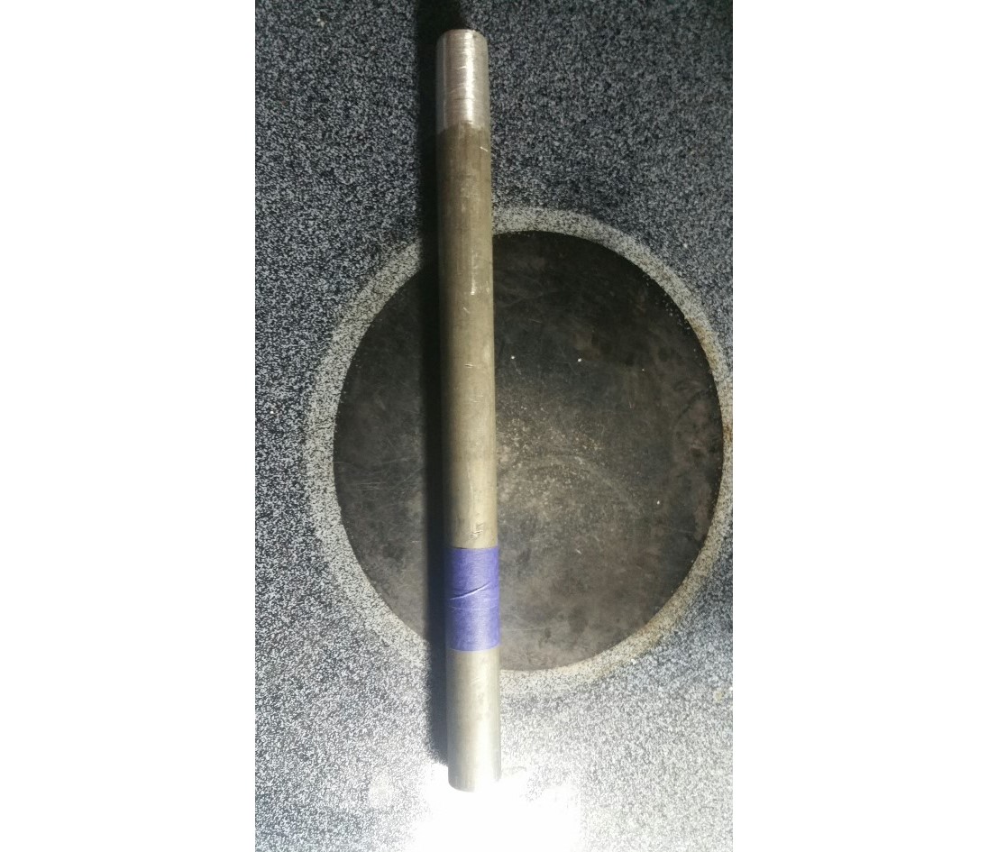

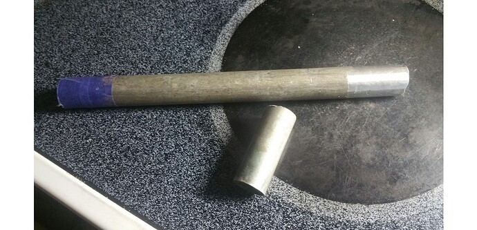

Find a pc of some kinda tube, I had a pc of Aluminum that was close in size, so I took it to belt sander and turned about .020 off of the od for a press fit into the filter lid. Also marked the length I needed
Cut off excess with cut off wheel

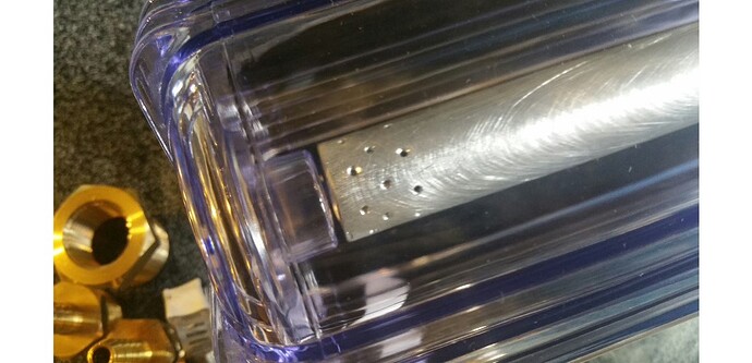

Grabbed the drill and a .062 dia drill bit and put 24 holes in the bottom of the tube
Lightly press tube in

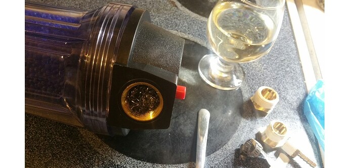

Test fit the assembly
looks good :+1:

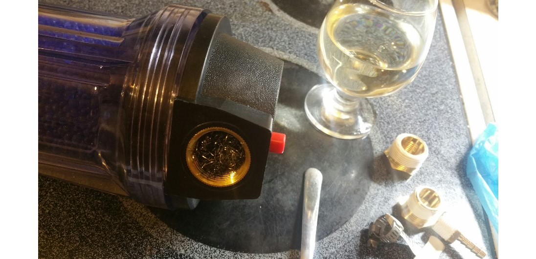

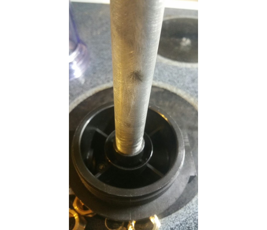

Next grabbed some random fittings and tape…

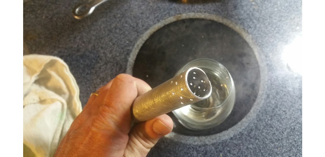

next filled with gel beads…ugh…this was kind of a PITA…BUT a small funnel worked great to fill through the output fitting hole

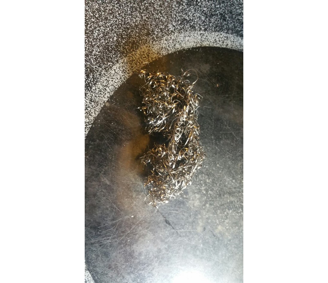

next was to grab the pc of SS steel wool
and insert it into canister and the fitting to hold in place
and walla!!!
