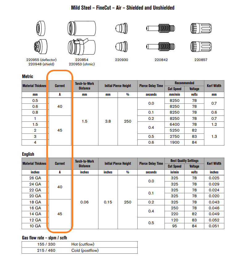

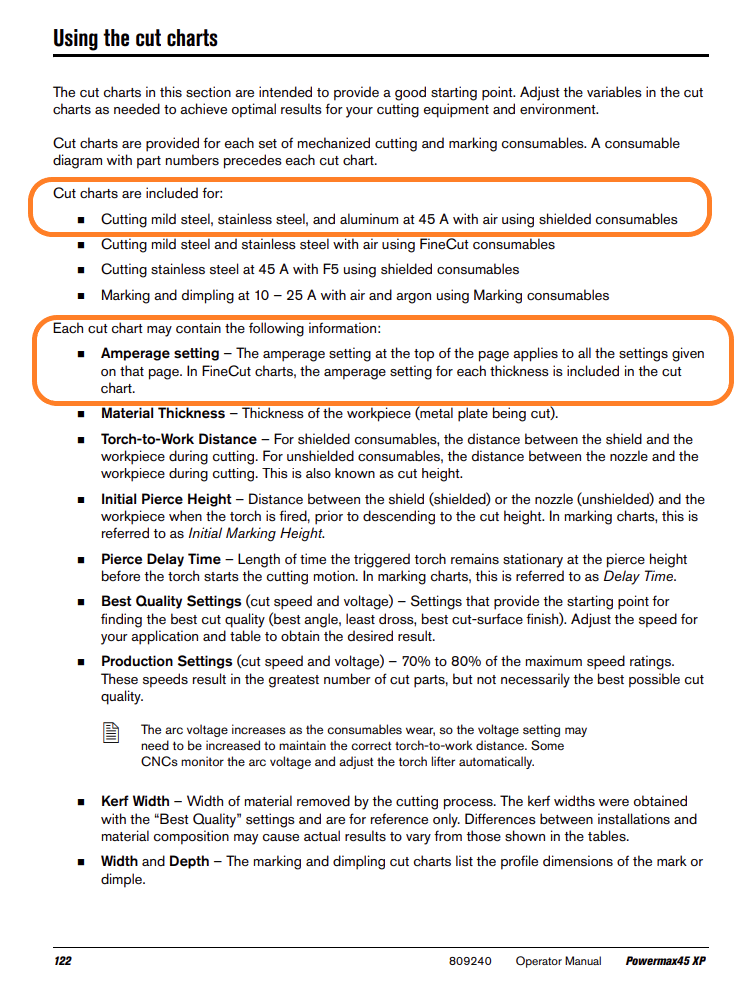

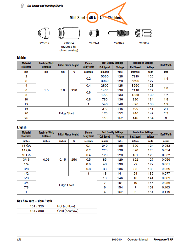

I bought a crossfire pro i have a hypertherm 45xp. Is there a cheatsheet for the speed to us for different material thicknesses ?? Like 1/8, 1/4, 3/8 and so on. I looked up the hypertherm 45xp and the charts the have are in voltage not amps?? And my other question is, in the fire control program. If i have the THC on and i up and down the voltage in that program does it control my plasma ??
Amperage is listed at the top of the page for most hypertherm chart cut.
For some of the fine cut comsumable it my be listed in the chart on the left.
They 'll have both. the voltage in for the torch height control and my be entered to the nominal voltage box in firecontrol.
it controls the cut height the torch.
check out this post it has some screen shoot that may help with the cut charts
