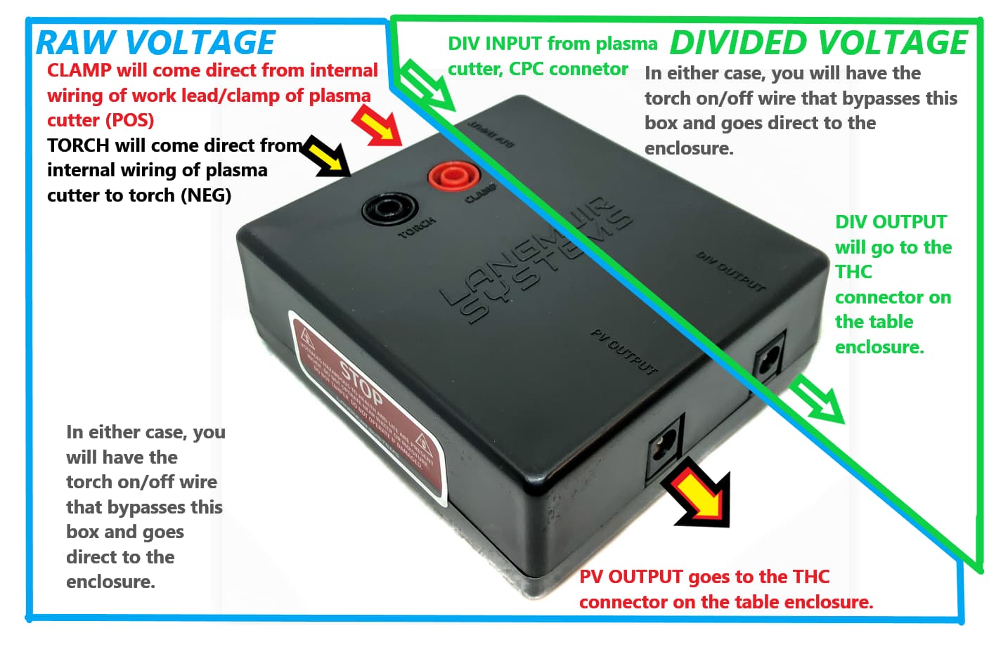

THC needs to be wired direct to the lugs inside the Everlast not the CNC port. Only the trigger is wired to the CNC port.
The “smart voltage” is what the THC detects in the first 1/4" of each cut loop. It takes a voltage reading during that first 1/4" and then uses that reading for the rest of that cut loop.
If the voltage reading coming from the Everlast CNC port is fluctuating due to a failure of one of the components on the board, the smart voltage will not be correct.
For instance, if the Everlast voltage reading was 120v during the start of the cut, that will be the smart voltage value for that cut loop. If the voltage reading drops to 50v during the rest of the cut, the THC will keep raising the torch until it gets to 120v.
Open the machine and connect to raw voltage at the lugs behind the torch and clamp. Bad voltage readings through the CNC port is a well known issue with Everlast machines.
After you wire for the direct voltage, like David and George are saying, make sure those wires go to the VIM in the blue outlined section of the VIM module (“RAW VOLTAGE”):

Now the kicker is: Divided or Raw voltage, which is better?
If you could trust all cutters to do this correctly, it shouldn’t matter. The more expensive brands tend to give an accurate divided voltage. The cheaper brands can be hit or miss: That is when they say “Go with Raw Voltage.”

I then hooked up the THC to the Raw voltage directly to the torch and ground clamp of the Everlast. This didn’t fix the not firing issue, but it did bring the smart voltage up to about 85 volts instead of the 50 volts it was before.
