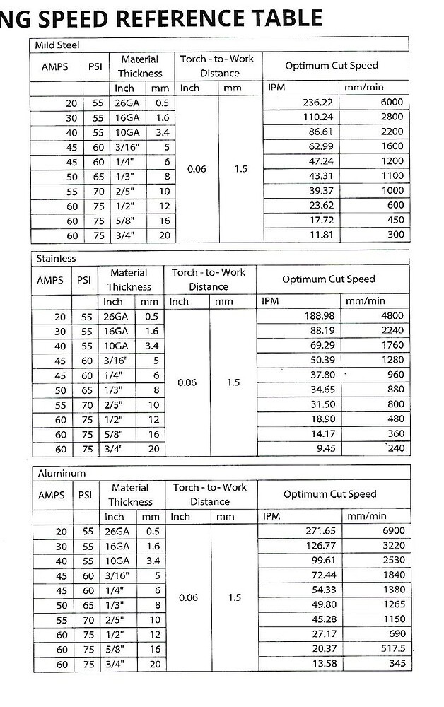

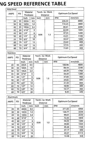

I Got this from another thread on here a while back has worked pretty good for me though it’s just a starting point, I mostly have been doing sheet 16 and 14 gage. do some testing to see what works the best for your machine with the material thickness, amps, cut speed (ipm), psi, cut distance, pierce distance and delay. My machine for example, I run a Everlast 62i with the machine torch 1.1 tip and thc, for 14g I’ve found what works the best is 35 amps, 100 ipm, 65 psi, .06 cut distance, .35 pierce delay and .15 pierce height.
