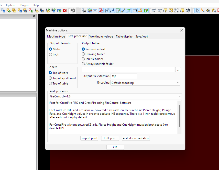

Is it possible that the software is not recognizing the post processer file because it is not stored in the right location on computer to create the Gcode?
In Sheetcam - Options - machine… does yours look like this ?

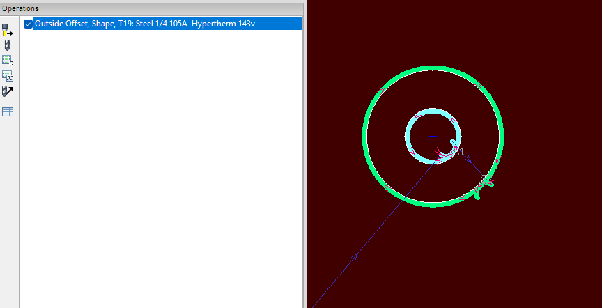

Then a operation that looks like this…
Once you have all that, hit the go button…
