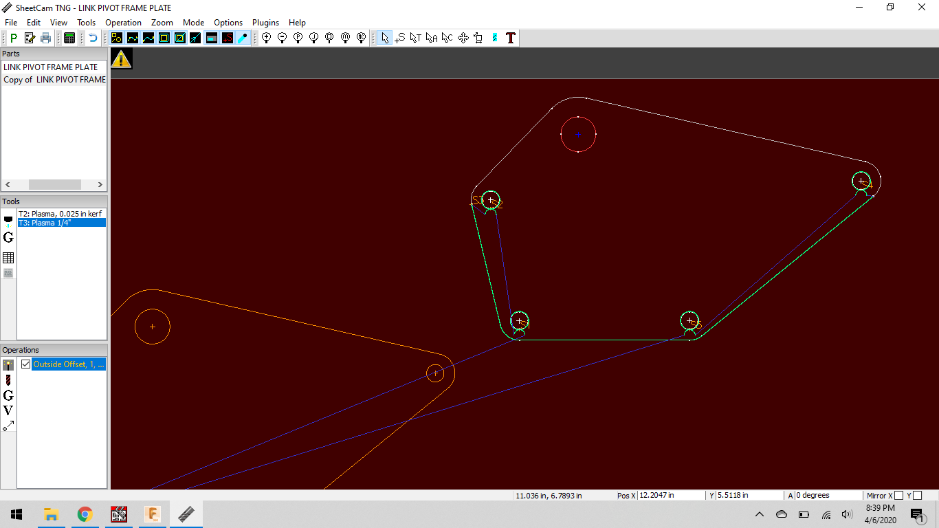

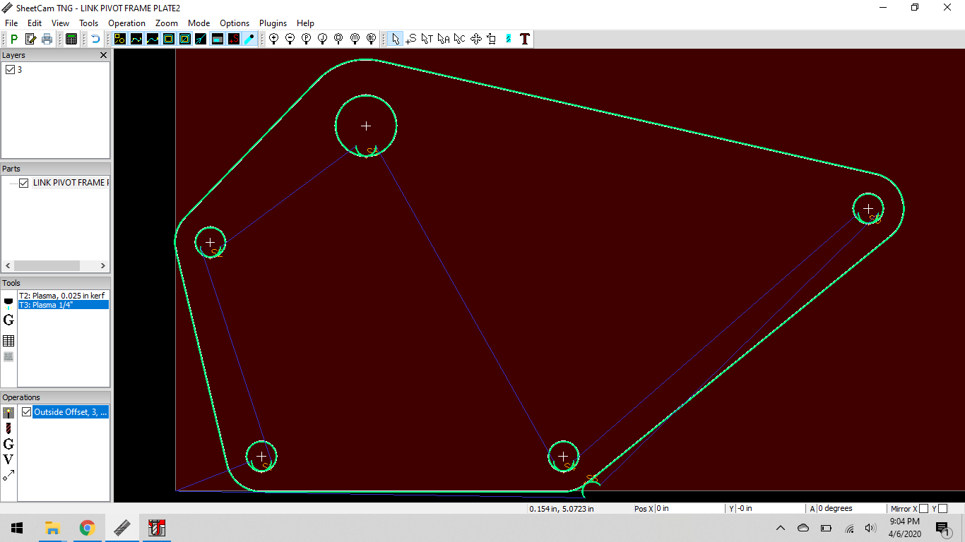

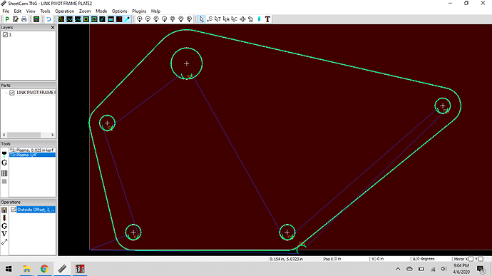

So i keep trying to import and create a toolpath with a part i drew, yet it fails to recognize half of it and wont recognize the larger 1" hole.
does anyone know why Sheetcam is going this?
Ive redrawn the part numerous times, made sure all the lines are joined and even imported it into Fusion 360 which recognizes it as one complete part.
anyone have any clue whats going on with sheetcam?
Try View -> Layer Tool and check what the layers are doing / how many you have. I suspect your drawing might have multiple layers, but not sure without looking at it in detail. If multiple layers, you may need multiple tool paths / operations for each layer. It’s also possible your paths are disconnected, but they look ok from screenshot. Or it could be something else :dizzy_face:…just a few ideas…
ok, according to your suggestion, its looks like there is two layers.
now i cant seem to figure out why the F its doing this…

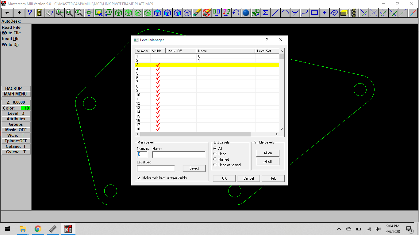

I export with Mastercam, like ive done on everything else ive drawn, i dont know why its doing this
Sorry - I’m not familiar with Mastercam, but someone else on here might be. I don’t remember off hand, but may be able to combine multiple layers into one operation in sheetcam - but having multiple ops is not hard to setup.

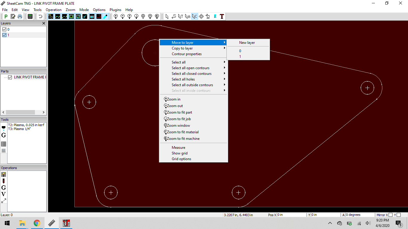

Sheetcam defaults each color line to its own layer. If you want them in the same operation just select the contour tool, right click and pick “move to layer”.

okay, figured it out.
mastercam has a feature where you can assign layers to certain pieces of your drawing.
HOW I DID IT?, i dont know. but i redraw everything under one layer and now its working.

Don’t want to put words in JDH’s mouth, but I think he typo’d Contours Tool…when it’s selected you can right click on a path and move it to another layer.

Definitely. I usually have an outside cut profile layer and one or more inside cut ones. Sometimes (especially for art pieces, I’ll also have a no offset layer).

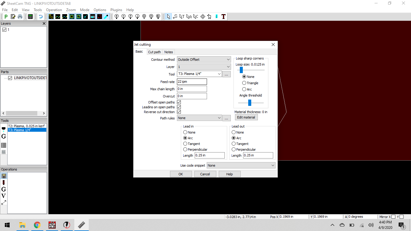

I typically use a lead-in of Arc with 0.12" distance. That lets the pierce establish and sweep gently into the cut and eliminates any burrs on the edges of holes due to piercing too close to the cut line or because the torch has too slow too much for a sharp turn onto the cut line.
But that’s not always possible depending on the size of the cut out. So for those I’ll setup a layer (& operation) where I tweak the lead-in down to the kerf width (generally 0.06"). If there are tiny cut outs that still won’t path properly, that’s when I setup a layer (& operation) without a lead-in and accept the divot or burr. Usually not a real issue for art pieces.
Then I order the operations so I start with inside smallest cut outs to the final outside cut out so I don’t have the piece shifting in the middle me cause I cut the outside profile and then try to cut middle parts out.
If things are really densely packed I will add other layers & operations to allow me to break up the order of cuts even more so I can minimize warping and give myself time to grab any tip-ups.
A lot of this is personal preference but it helps minimize problems and sometimes some post-processing for me.

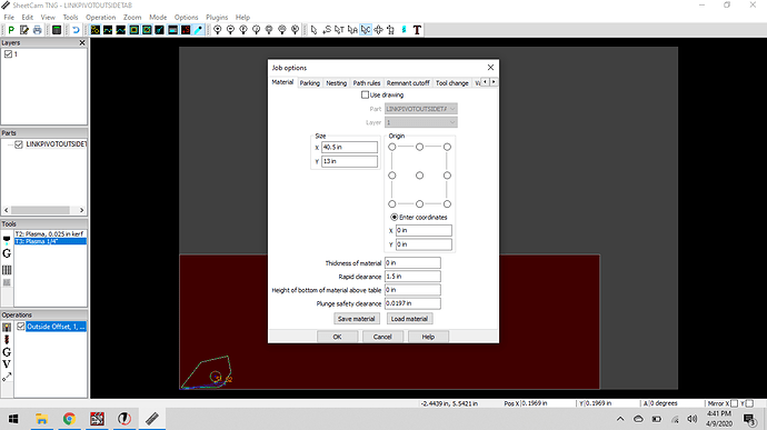

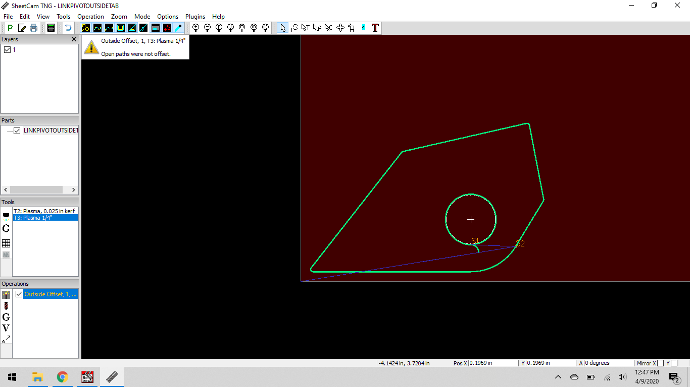

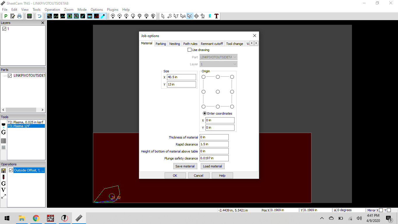

well, im having more issues with sheetcam again. it doesnt recognize the part as is, and keeps thinking the outside is inside or something, the hole keeps getting a lead in from the metal side and wont add a lead in for the outside

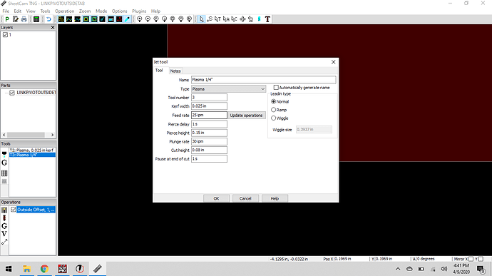

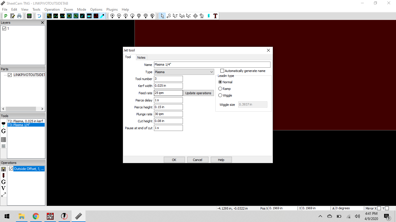

At a minimum you need to show us the SheetCam job settings. And the warning message says you have open paths, they need to be fixed.
i dont get why its saying its an open path, all the paths are complete.
if i chain the drawing in mastercam, its a complete drawing.
