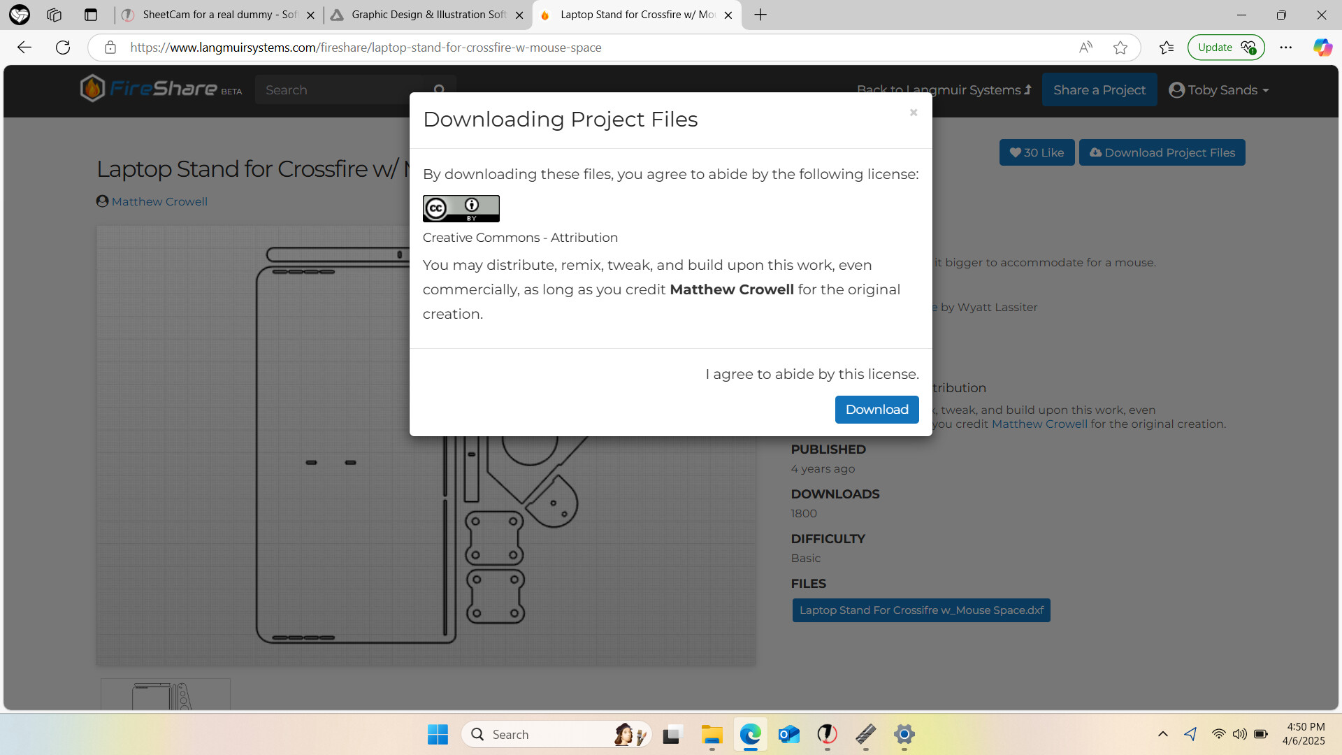

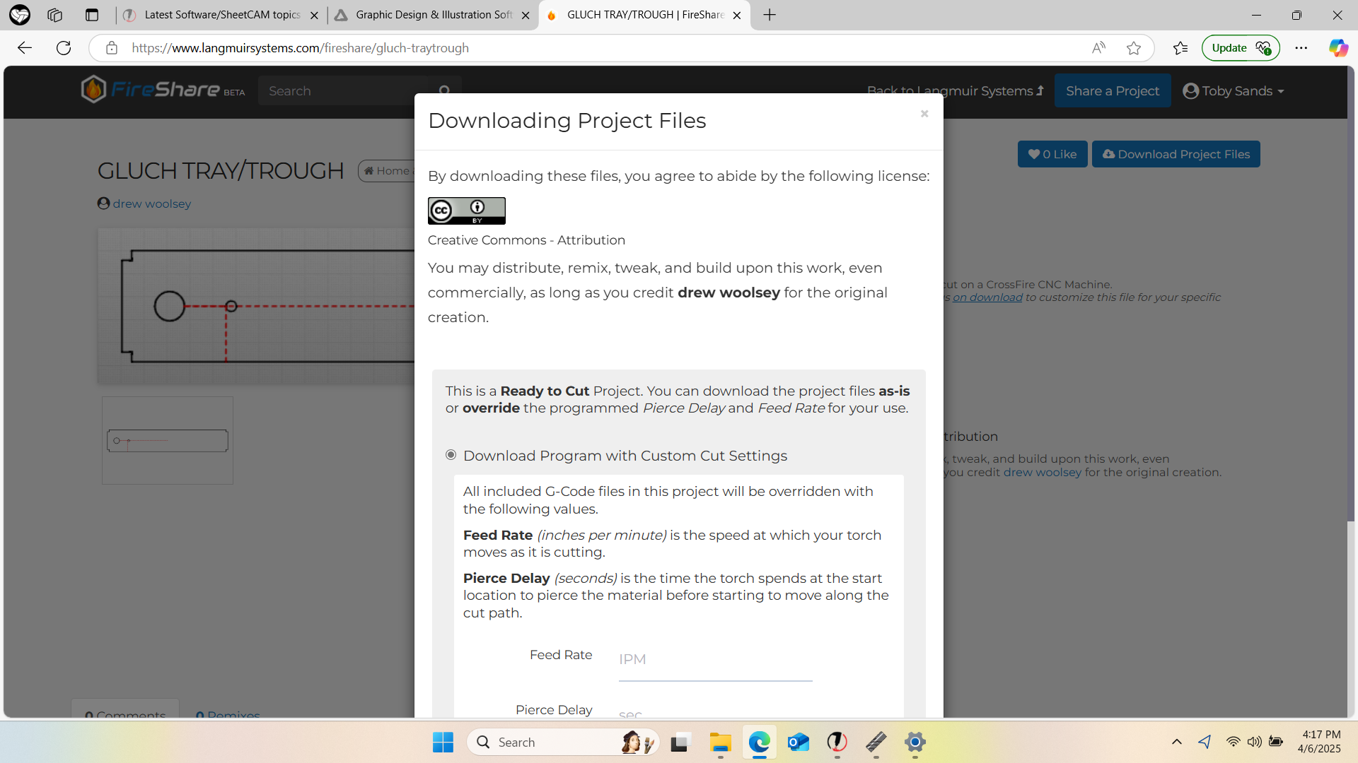

I’ll do my best to even describe this issue I’m having. I havent even attempted to do anything but cut things I find on Fireshare. If it downloads like this screenshot shows I can put in sheetcam and then to fire control succesfully cut it. If it downloads without this option it will not go to fire control. Granted I have absolutely no idea what I am doing. I hope this makes sense to someoone who can offer some assistance. FYI I bought sheetcam vs trying to use the free version.

It sounds like you are relying on NC and/or TAP files. These go straight into Firecontrol for cutting.
These are actual G code files, and the screen you see there just allows you to alter two parameters from that of the original program.
This allows one to cut the pattern out of a different material type/thickness as they will require different speeds and/or delays.
When you download an SVG or DXF, why not just take that to Sheetcam and process it yourself?
If I get this when I download (even if it says cut ready) it does not show in my fire control when I try to open a file.
Read my response.

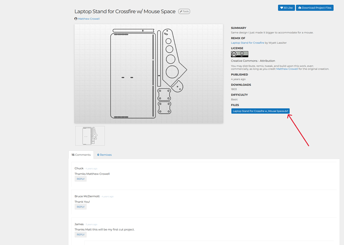

The screenshot you show there for the Laptop Stand is a DXF.
This file type is an image file, and requires the end user to create the G code for it.

I must’ve found the wrong one then because I looked up Matthew Cromwell and the download says dxf in the name

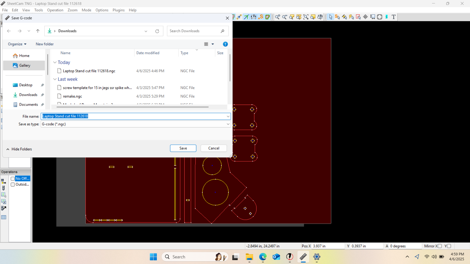

So you create and save from fire control you can find a .tap saved in your downloads folder?

Are you hitting the post process button?

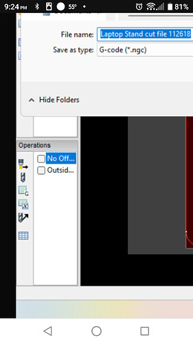

Can fire control see a .ngc file?
Usually sheetcam saves as a .tap and I think it can save a a .nc. looks like attempted to save a a .ngc
The issue wasn’t about creating the NGC/tap file.
The issue was not understanding the difference between a g-code file, and an image file.
If you look at the screenshot, you’ll see no actual cut paths are displayed as he hasn’t gone through using Sheetcam before. Hence the videos will help to create his g-code.
He has only ever cut files that he downloaded directly from Fireshare.
You have to turn tool paths on insheetcam. Look in the bottom left corner he has 2 operations created.
