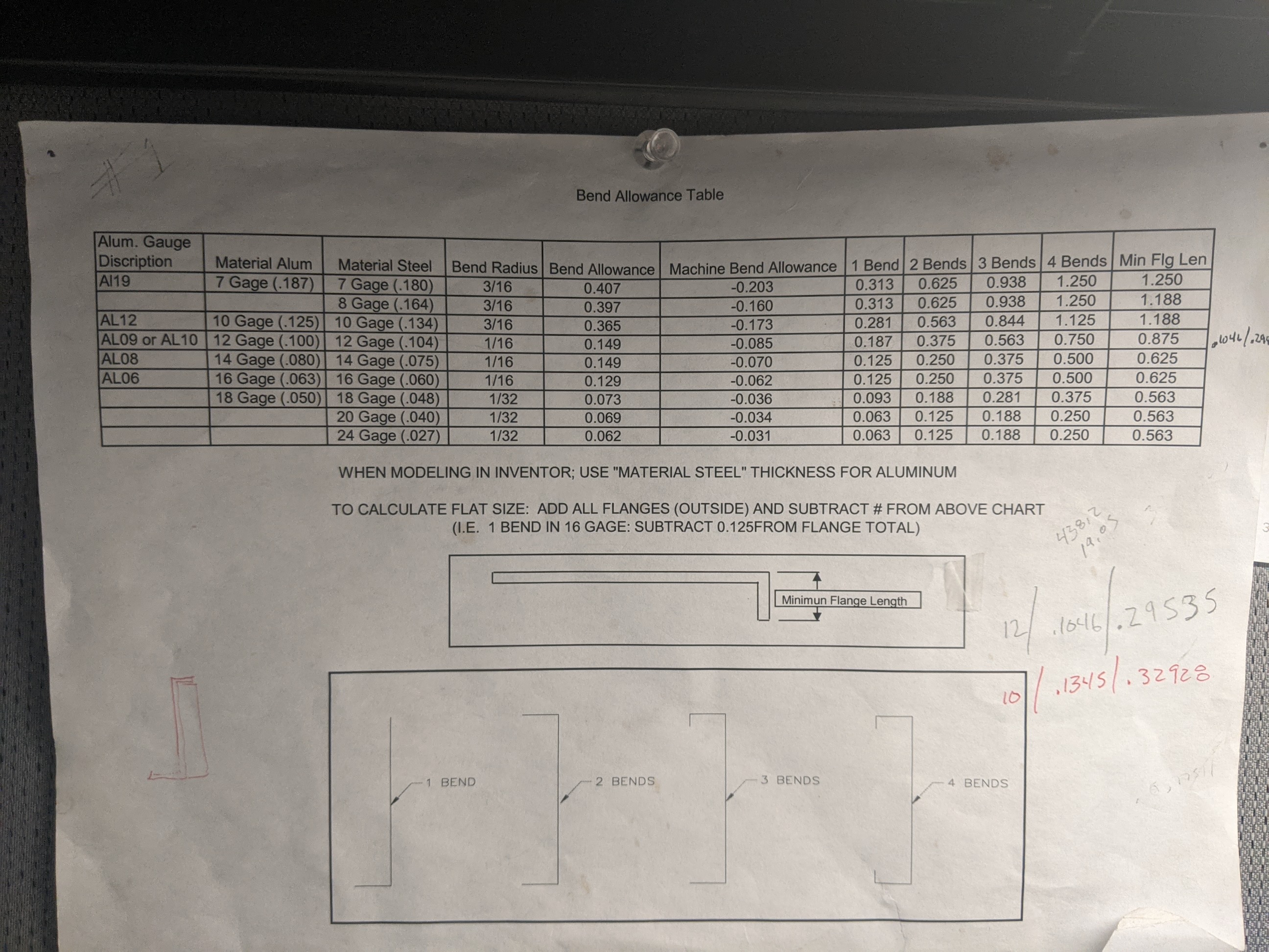

@Joel48 I went through my drawing to follow the steps in you illustration and when I get to part #5 in mine, all the inner corners of the sides of are touching, but they are not in yours, but eyeballing part #4 it looks like the should be touching, and in part #6, it looks like they are again.
I want to make sure I’m not missing something important. Did you move them apart for illustrative clarity? Am I missing something?
@holla2040 cool stuff! I’ll be glad to share what I learn, as I appreciate the help I’ve gotten from this forum. Outstanding.
Presuming you are working from the same flat pattern, you wouldn’t have the radius remnants you would see in an isometric drawing. I removed those radius remnants because they mean nothing in the context of the flat pattern.
Because I did that, it was necessary to extend those lines in both directions to end up with a square the same size as the K factor to put the round corner relief holes in the center of the squares.
I could have calculated where the corner holes were to be placed, but it is easier for me to make the square, add a cross line and snap the holes to the center of the line. That’s what I did, however, I didn’t illustrate drawing that line and deleting it after snapping the holes in position.
The bottom line is you didn’t miss anything important. You likely will find your own creative ways to reach the same conclusion.

I cut out a 3x3 inch piece of my .090 aluminum and set the setback on my Baileigh finger brake3 to 1.5x the material thickness. I did a test bend and it appeared to be a tighter radius than my original chassis supplier use, so I bumped the setback to 2 x material thickness. This provided what looks like a pretty much spot-on match for radius. The material length after bending is 3.15", so I’ll factor that into my drawings.
Pretty close to what we figure here. .1875 Our numbers are rounded so you can put a tape measure on it.
