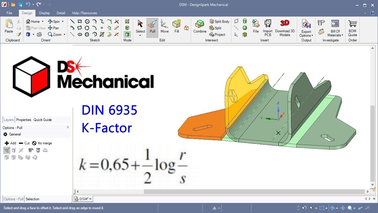

You can also try DesignSpark Mechanical. It has a sheetmetal plug-in. I spent a lot longer dealing with Fusion360 changes of features & license permissions because it has a nice sheetmetal component. When I came across the same feature in DesignSpark I stopped using Fusion and haven’t looked back. You design without regard to the K-factor effect. Just make the sides and things the size you want. Then you tell it to “unfold” your part and it uses the settings for your material to apply the appropriate K-factor and shrink the part appropriately. No calculations on your part needed and because it’s in the model as the size you want, you don’t have an issue when you come back to an older design to try to figure out what the sizes were and where holes went, etc.

Here’s a decent enough video on how to use it.
No dialogue but easy enough to follow the steps. I’ll look to see if I can find the documentation link too.
