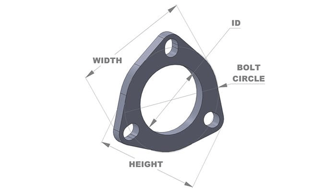

I would really love a 2 & 3 bolt hole exhaust flange shape added to this!
Has anyone ever added their own shape options to this library?

I assume you are talking about this sort of thing
The maths is a little tricky but I’ll see what I can do.
Do you need slotted holes? It makes things a bit more complicated to do that.
Hey thanks for the reply - those are what i’m talking about. The holes do not need to be slotted in the flange - they’re only slotted on the gaskets.
Appreciate the reply and help!
Before i’m corrected sometimes they’re slotted in the flange but we’re fixing junk impalas and fords here not making rockets. lol

The problem I see like this one the holes are not centered around the center hole.
OK, the next development release will have 2 and 3 bolt flanges with round holes or slots. It will be in the ‘Specialty shapes’ section.
The ‘Rectangle multiple holes’ shape can already be used for 4 bolt flanges.
Looking at the flange @Phillipw just posted, the new flange shape wouldn’t be able to make that flange because the holes aren’t evenly spaced. Does anyone know if this is a common pattern?

@LesNewell that was for a ford explorer not sure if any other car maker does this. I unfortunately had do do trial and error i cut piece out of 14 ga for a test cut. I had to go back and do a little tweaking to get it right before cutting the real deal
I think you’ll find on 3 bolt flanges that the 3 holes are all on the same “Circle” like this:
And yes they are fairly common on 3 bolt flanges.

your right they may be on the same circle but offset from the center that is why your drawing has slotted holes.
well the one posted wasn’t and they are directional when put on the vehicle
the problem is are they all on the same offset
