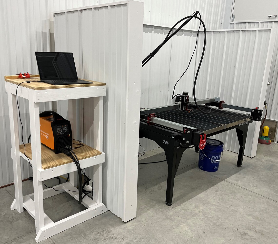

Heres my setup !!!
Nice setup.
Great idea on the partial wall separation.
Very neat and tidy!
