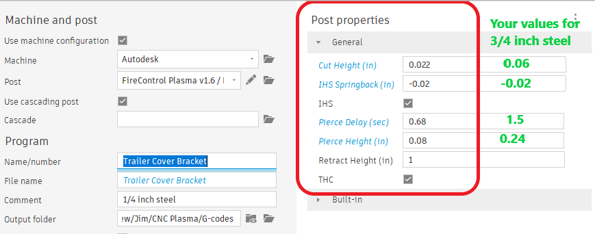

Hi I’m new to everything and purchased a crossfire XR in December we’ve been cutting pieces out in thin metal but when it comes to 3/4 inch plates can’t get it to pierce. If anyone has any recommendations on the settings to set the torch at it would be really helpful thanks. We’re using the hypertherm 85 plasma cutter

  1. Use new consumables. Your nozzle is already probably destroyed if you made a first attempt that did not go well. The additional spray back at the nozzle will widen the orifice and from then on, the stream will not be concentrated enough to cut well for that thick of plate.
  2. You have not really tested your settings perhaps as the thinner metal surrender more easily. What is really important is that you are at the right height for the cut. You might want to do a test cut and interrupt the cut to measure the distance to the plate. And notice that your pierce height should be 4X the cut height so you should be starting at around 0.25 inches.
  3. Use the nominal voltage instead of relying on the THC readings. (Ask if you don’t know how to set this).
  4. You should not have any springback set in the CAM. Are you using Fusion 360 or SheetCAM?

So keep in mind the following:
But keep those values in mind because when you get to the post processing screen, you will need to enter them:
That is assuming that your system is deciding on the correct heights. Trust me on the springback setting. Fusion will be adding 0.02 inches whether you want it or not. Entering -0.02 will effectively remove it.

Run this file and make sure you are at the listed cut height.
No really, do it. It matters to cut quality and consumable life. Once that nozzle gets even a little bias, the bevel it leaves is horrific
All is does is goes to a point and lowers to the .06 cut height and ends. Measure with feeler gauges and what ever difference you have make the adjustments to your correct cut height.
As stated above, either edge start, or pre drill holes (.060ish) at each pierce point. Dry run the program, press pause at the the cut start (it will do everything but move the Z axis, so pierce delay). Use a sharpie to mark where the pierce point is. In Fire control, go to the next rapid move to the next pierce point, click on that line in the progress view, then down below in the gcode list, click on Run From LINE. Then you can map out the next point. Rinse and repeat. When you are doen, reload the cut program, set your orientation if needed but DO NOT zero any of your axis again, or all your mapping will be for naught.
Slow your cutting speed down 15-20% from what the chart lists and inspect for cut quality and adjust as needed.
