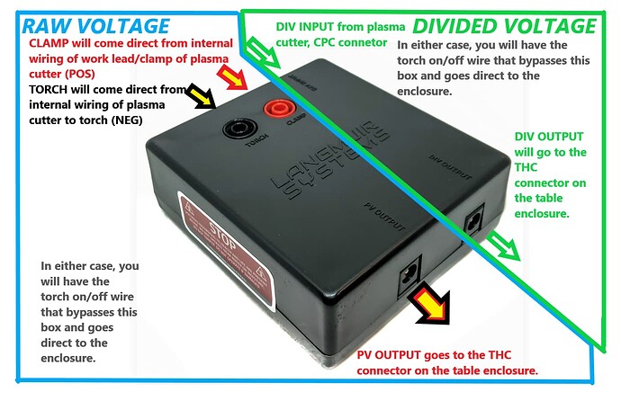

I have a Razor Weld Cut 45.
Yes, my wiring is as follows:
Div output → Electronics box
PV output →Plasma Cutter torch on/off
Div input → Plasma cutter voltage divider port
I’ve tried swapping the torch on/off and divider port with no success.
That’s your problem. The torch on/off goes directly to the electronics enclosure where it says “torch on/off”
It does not connect to the VIM (black plastic box).
You may have it wired wrong
