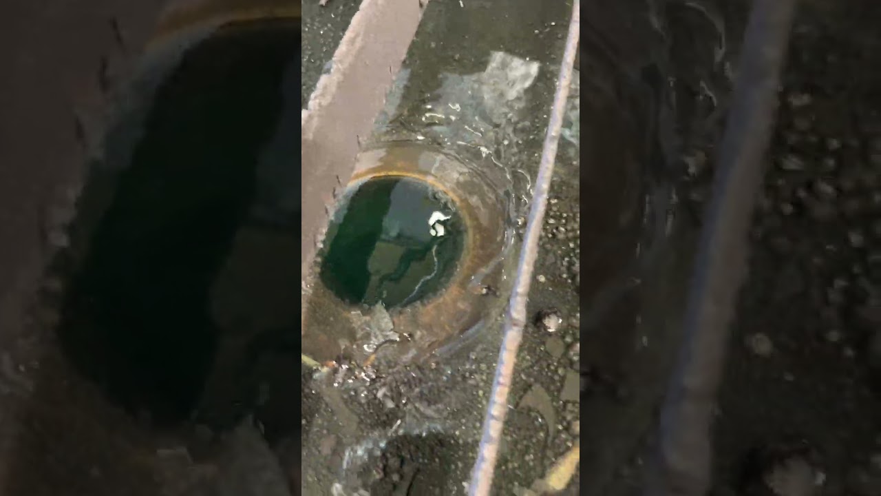

Hello everyone,
I’ve been exploring the option of getting a custom water pan made for my Langmuir Crossfire Pro, inspired by several discussions here. I’ve reached out for quotes with the following specs:
  • Dimensions: 41" x 52" x 2.5" deep
  • Material: Stainless steel 304
  • Drain Fitting: 3/4" NPT, centered
  • Thickness: 16 gauge
I’m including a picture: https://cdn.zappy.app/ffe9a8a2a5b466a57685cf3395feb51f.png from a YouTube video https://youtu.be/1p9CR-u120k?t=715 for reference.
So far, I’ve received two quotes:
  1. CustomATX: $930.25 (link)
  2. Texas Sheet Metal: $592.00 (link)
The video mentioned a price of around $175, which seemed optimistic. Understandably, the quotes I received are higher, but they’re more than I anticipated. Does anyone have recent experience or recommendations for sheet metal work, especially in central Texas, that might offer more competitive pricing?
Appreciate any insights or contacts!

I do like the pictures design with the channels so water goes to the drain but as mentioned the water table from Langmuir is fine but wish they would design them so they have the recessed drains to get all the water out

I would forget the small drain plug connection…have the hole big enough to put in a barsink drain…works great…faster draining and you can easily use it to make better recirc and filtration system
