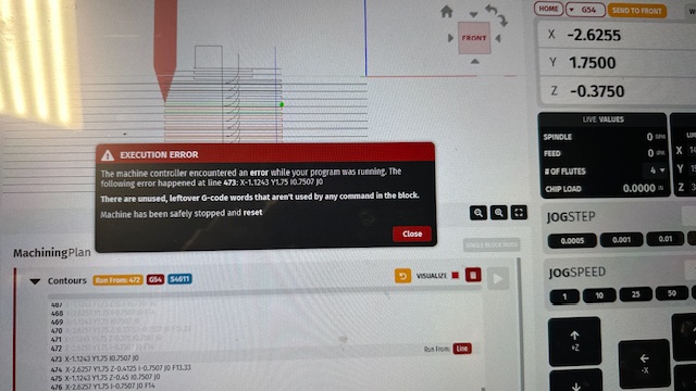

Am I the only one getting these errors? What does this mean? Every time I try to generate a run from line it is the same error on all tool paths? This was not an issue until this new 24.1 was loaded. If I start the path from the very start there is no issue.

I imagine they are wanting to look at the G code file, so the .NC file, or whatever file extension you’re using for the G code itself. Looks like maybe it is expecting a G02/G03/G17/G18 before that line, but without the actual G code it’d be hard to say for sure if Cutcontrol is missing it or if the G code needs modified.

The code itself looks fine to me. My best guess is that Cutcontrol isn’t happy with starting in the middle of those arc/interpolation moves.

Hey everybody, just wanted to let you know we have a workaround for this error code while we work on fixing the issue with an update to version 24.
This error code comes up when there is an extra G or M code or when one is missing from a line of code. In this case, the run from line feature doesn’t recognize that the line of code is supposed to be set to G3 movements. So we opened to program in notepad and manually entered G3 at the beginning of the line and were able to successfully start the program from there.
