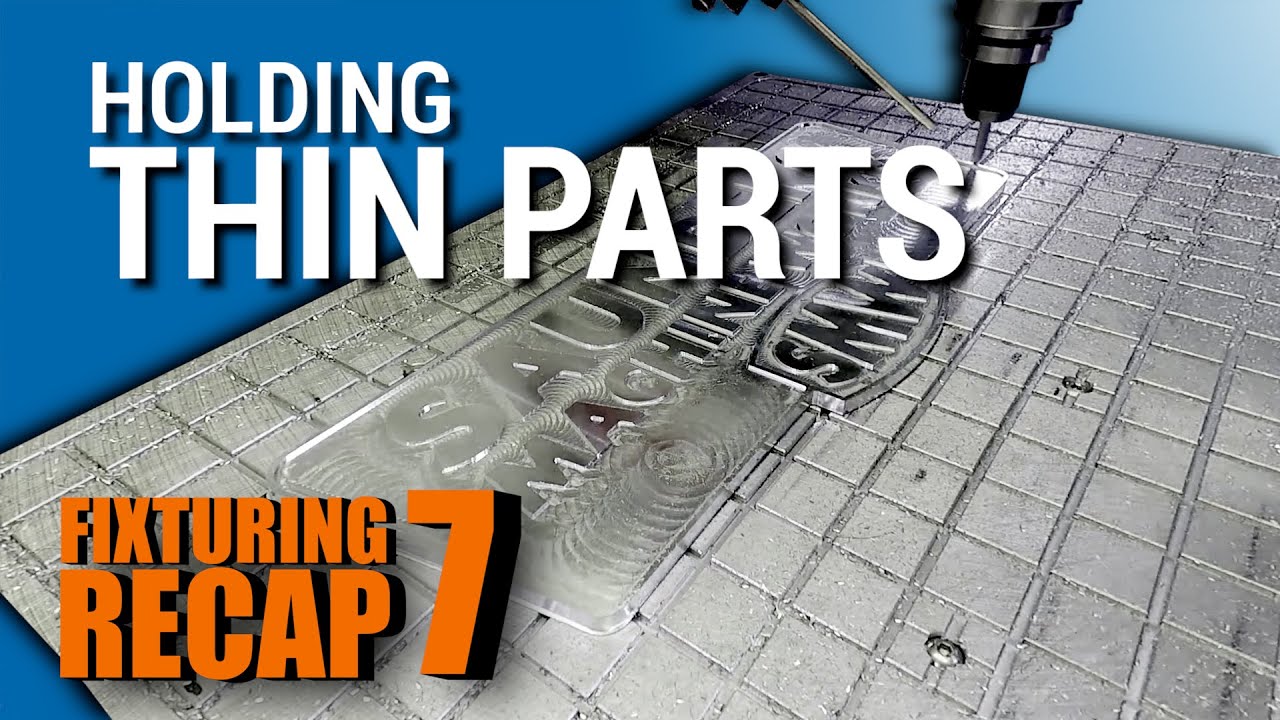

I stumbled across a video from StoneyCnC. They use some strong 3M tape and CA glue and stick pieces down to aluminum spoil boards. I’ve used this method a few times for aluminum and polycarbonate. You get a ton of surface area with the tape adhesion and the CA glue sticking the tape strips together.
I wouldn’t go hogging off bigger depth of cut with it quite yet, but for thin brass, aluminum or plastic it is a quick and solid fixturing method. Anything that’s thin enough to worry about edge clamping for sure.
