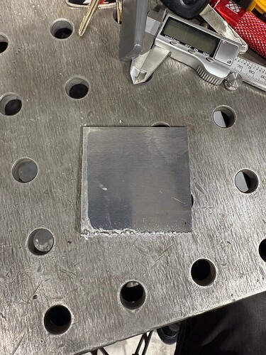

Rough cuts when torch moves from right to left
Im having a small issue when cutting something out but only when the torch is moving right to left.
I mainly cut 1/8in steel or aluminum
everlast 62i
tecmo consumables
70psi cut pressure
40amp
100IPM

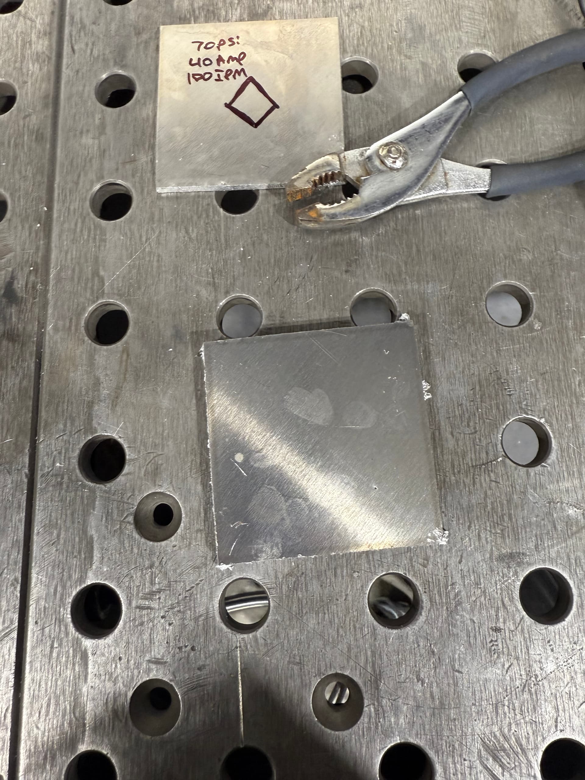

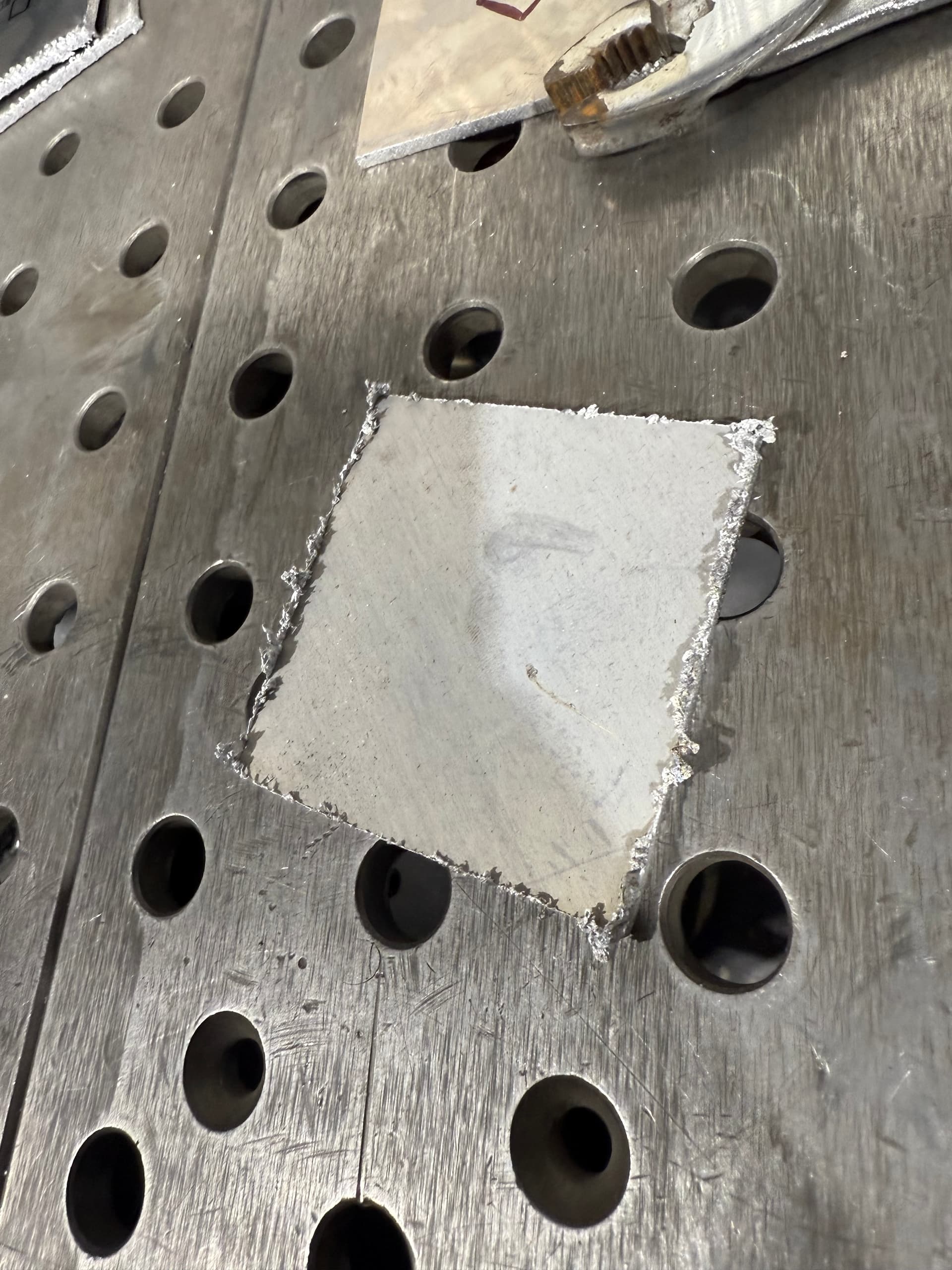

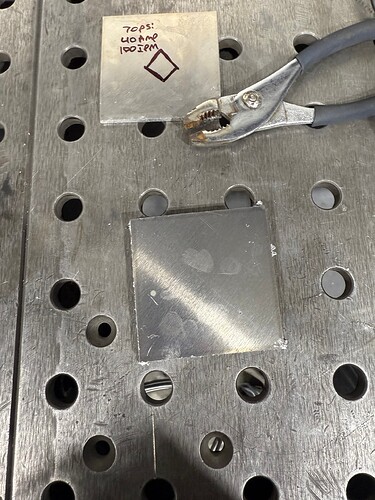

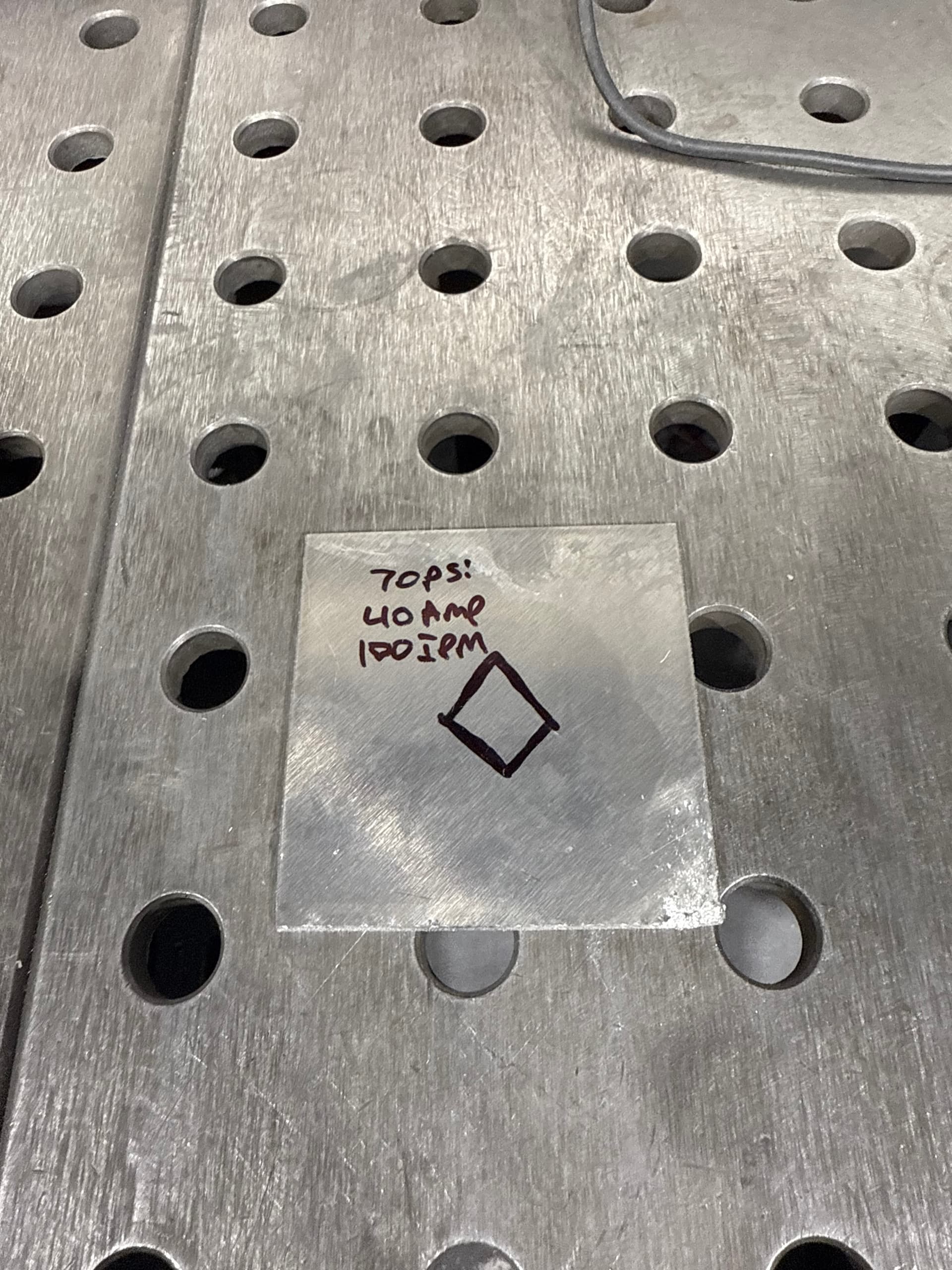

Heres a few test squares I cut out. The only difference was rotating the piece 45deg to try and not have any right to left cuts. One i bumped up to 110IPM but still got a jagged edge
on the last one I dropped my amps to 25 and IPM to 60. It was a lot better but lots of dross.
Increase amps to 45, air at torch to 70 psi and cut speed to 170 for 1/8” aluminum.
When you’re cutting parallel to a a table slat below it can have this effect on aluminum.
