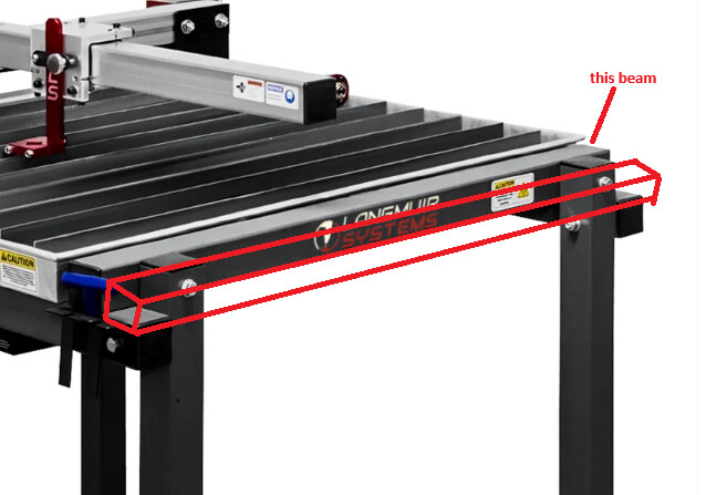

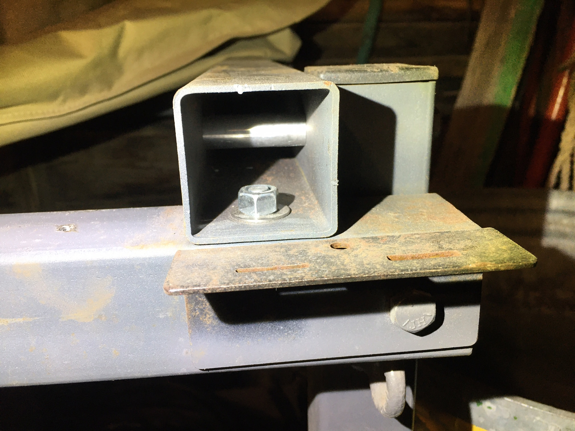

Only other restriction is this horizontal tube/beam that would get in the way. Structurally/in terms of alignment, could I swap this tube to the other side of the legs, (shown in red) to gain the extra two inches needed to fit the 30x32 pan? It’s been forever since I assembled the table originally, and can’t recall how critical all that is.
Otherwise, I may just weld/bolt in a shorter tube between the two legs. I have no problem modifying this table, as I’ve got caster plates and a shelf already welded on it.

Looks like swapping the tube to the other side could work. Just need to figure a way to bolt into that bottom tube. Thinking of cutting a 2” piece of 2x2x1/4 angle, and using that as the means to join the two. Gonna order the Vevor drain pan and see how it fits up!

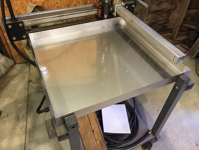

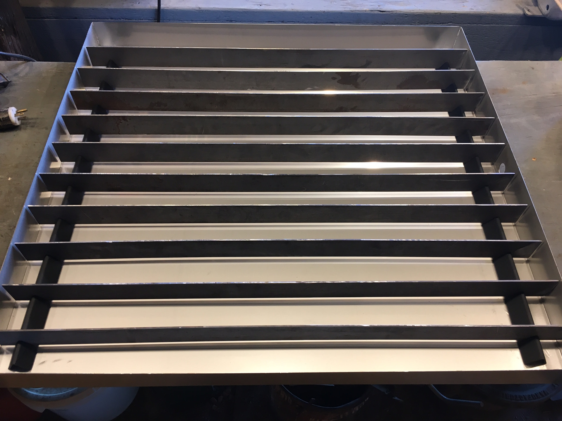

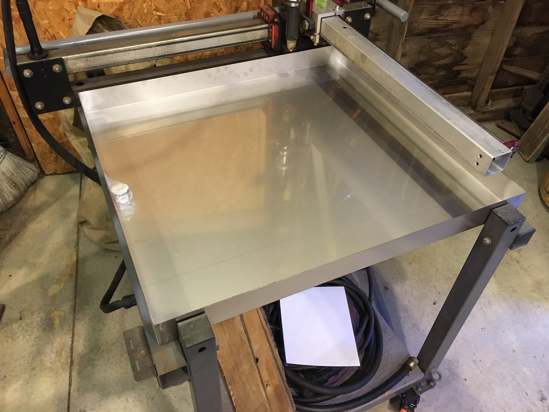

Seems to fit perfect with that tube out of the way. Pan is sturdy, flat, and leak-free. Trimmed the slats lengthwise to 31.75” and thats a perfect fit. The pan is a bit deeper than Langmuir’s, which is nice. Has a side drain hole punched in, and will probably end up using that.
Shouldn’t be too much trouble to relocate the tube. Just wanted to post this in case anyone else was curious how stuff fit up.
