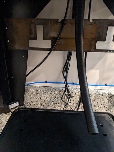

The fully assembled versions come with forklift brackets and I left the rear one on for added support between legs. This is taking up even more of the cable slack. I might remove it temporarily and see if it will buy me more room.

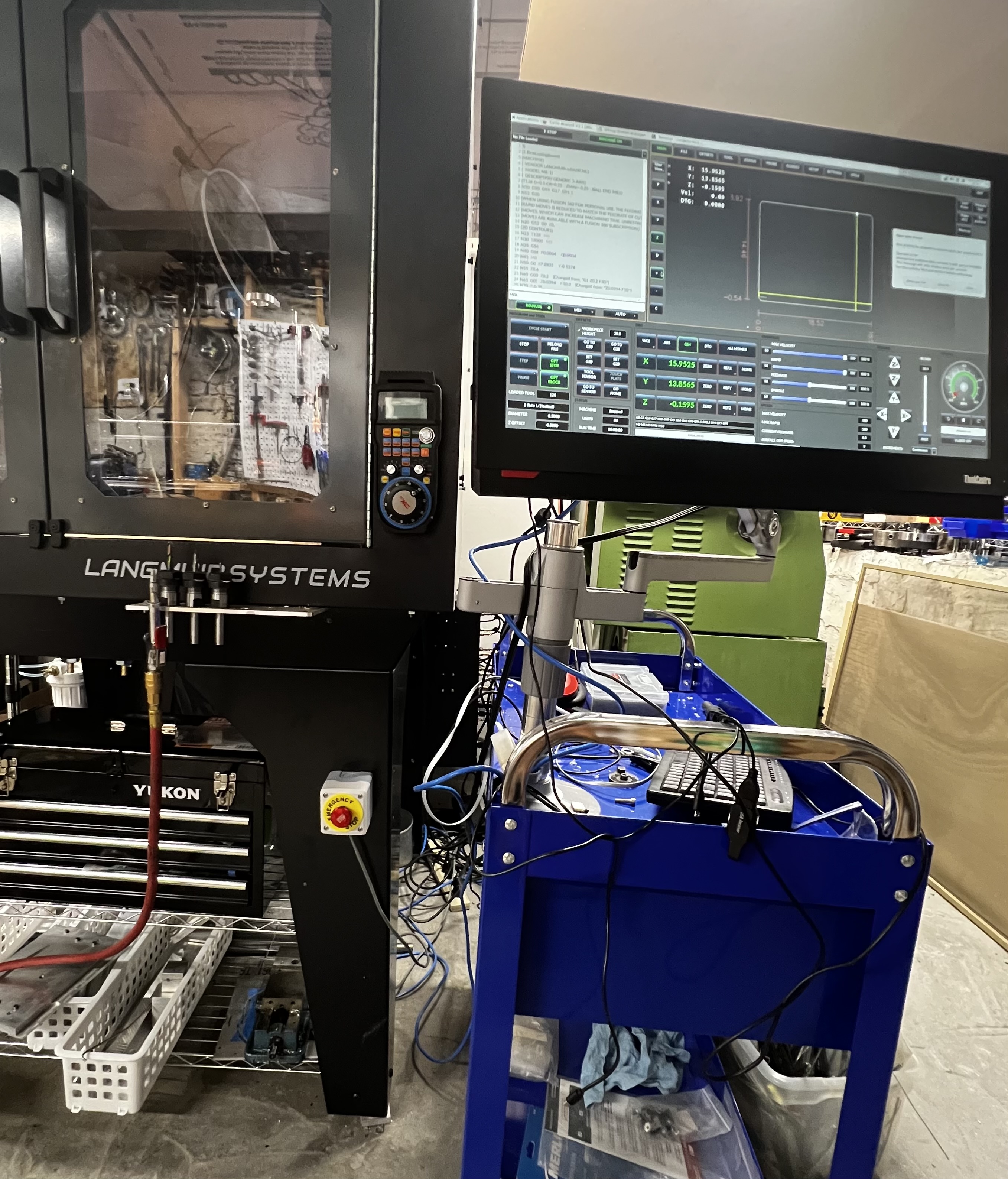

I have mine on the right-rear leg of the machine, turned sideways. You don’t need to do any drilling for this mod. This allows the enclosure to be about 6" inches closer to the wall and provides easy access to the cables. I moved the e-stop to the right-front leg of the machine where it is easy to access at any point during an operation.
I’m running LinuxCNC which is why the software looks different, but these changes don’t care what software you run.
I have my PC and monitor mounted to that rolling cart so that I can roll it out of the way when I need to access that corner.
I really need to clean up my wiring mess!
Looks good thanks for the pictures.
