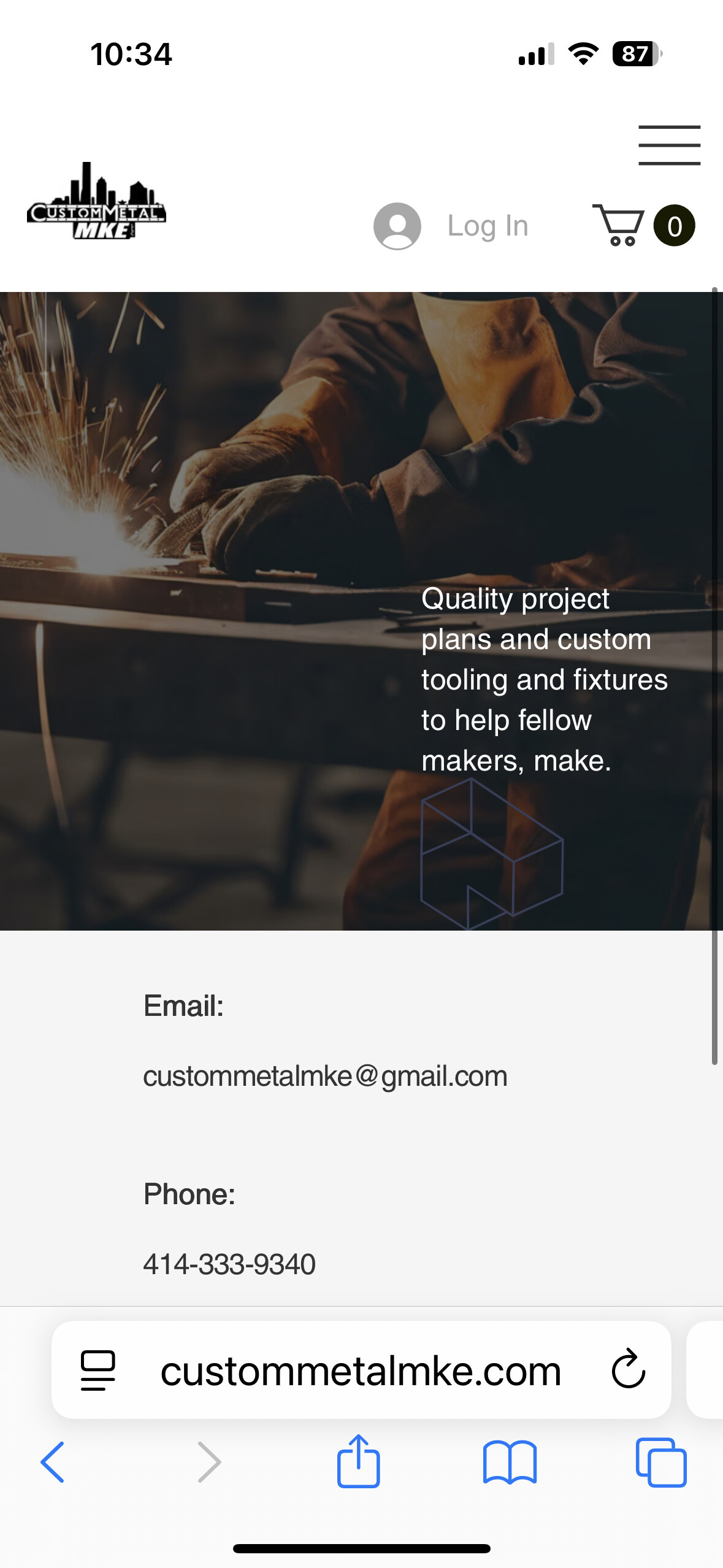

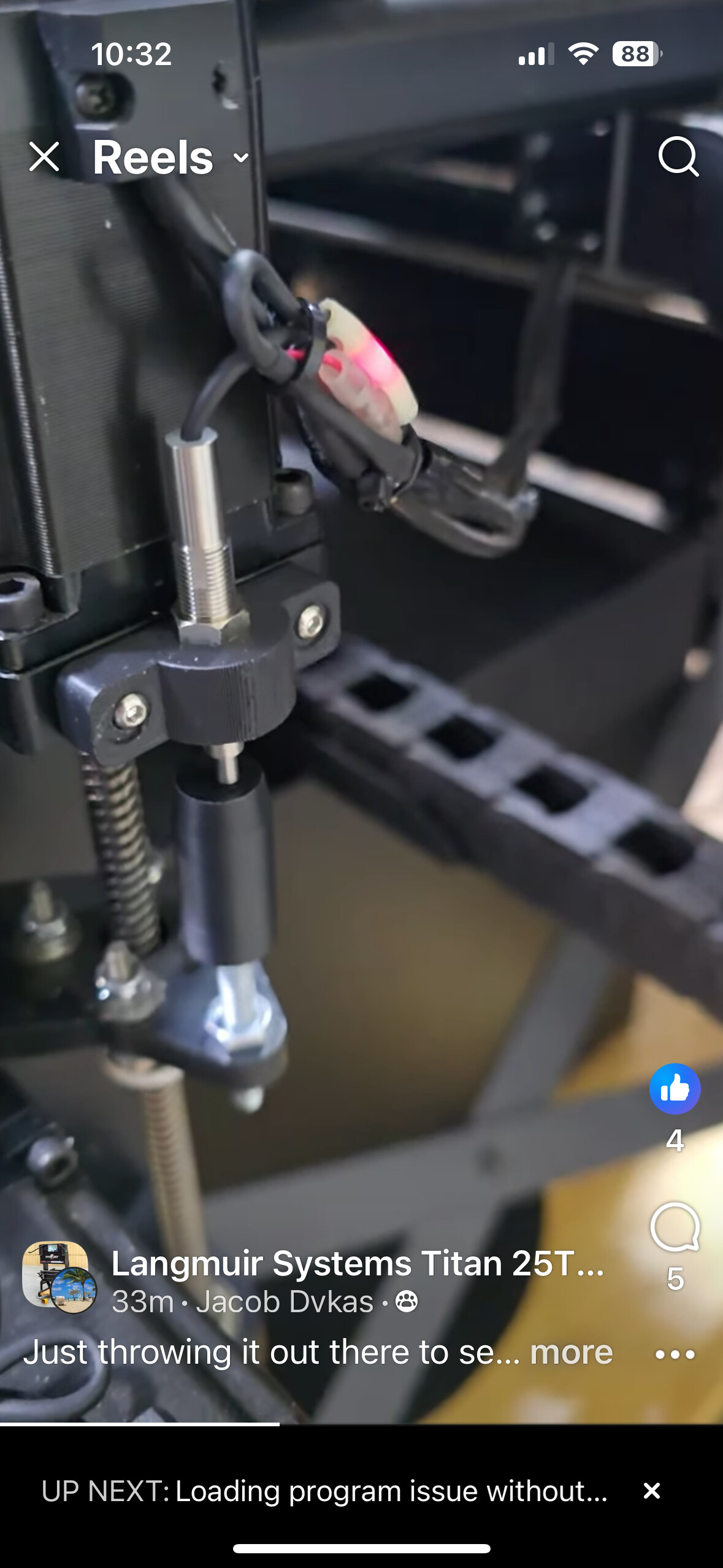

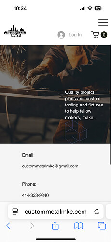

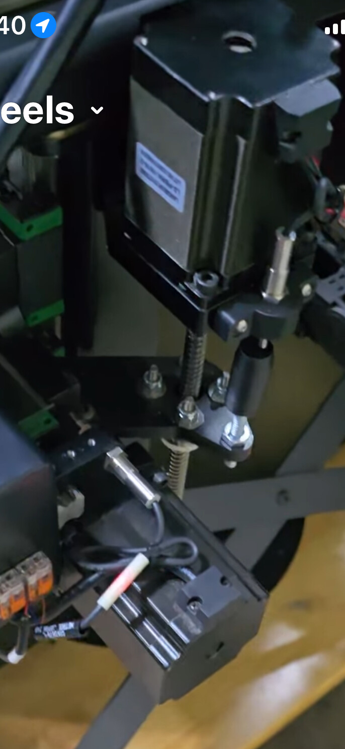

For those of you who are not on the Facebook group “ Langmuir Systems Titan 25T Owners” take a look at info below. One of the members has designed and tested a set of industrial limit switches for last 6 months with great results. It’s not a cheep fix but it will be a permanent fix. Feel free to reach out to him thru his website for upgrade kit.
The Facebook group got the idea from here: from the MR1 switch replacement.:grin: Bigdaddy won’t use Facebook, nor do they want me to. But I will say that @custommetalmke is one hell of a sheet metal bender…
I also purchased the same switches. Almost 60 each which I would have gladly gave LS. The only reason to buy the limit switch kit is the wiring. The rest is junk. Want to share your .STL files? The switches I bought are Metrol PN#CS067B-LR an CS067B.
