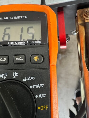

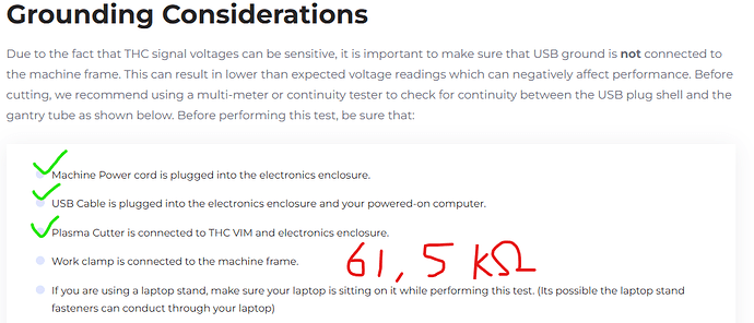

Reading 61.5 kOhm during ground check
Hi all,
just added the THC and finished installing and ready to rock.
as the final check, I did the ground check per instruction.
There is no continuity between USB cable and machine but when I attach the clamp to machine, meter reads 61.5 kOhm. I’m also reading transient resistance reading between control box screw and machine in M Ohm range…

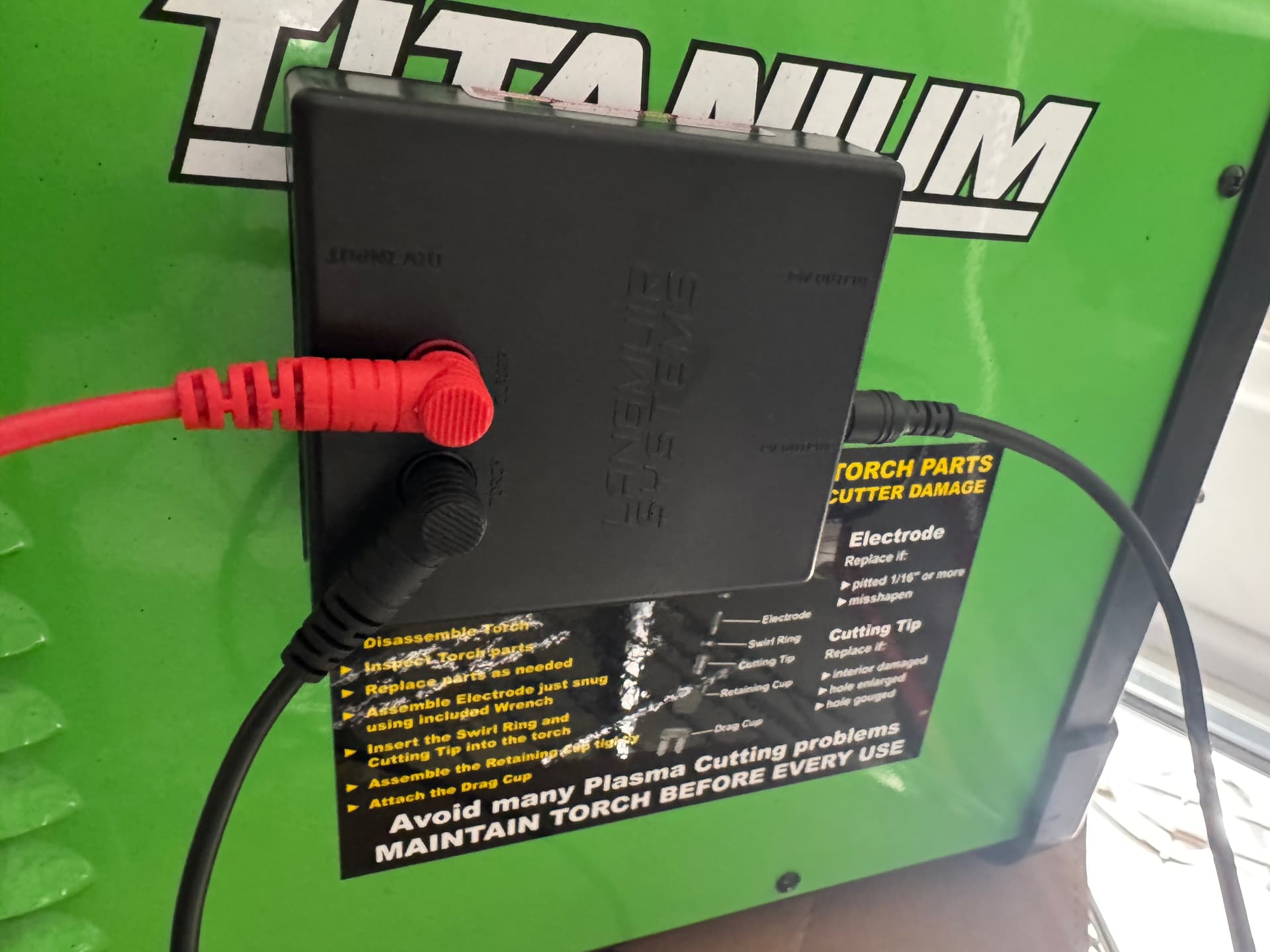

Titanium 65
raw voltage connection with pigtails and ring terminals
What happens when you unplug the Langmuir controller box? Next question: What else is on that steel rack that could be plugged in? My thought is that the service panel ground from your electrical system has created a ground loop.
There is still load when control box power is unplugged.
To be clear, it’s open only until the cutter clamp clamps to machine.
Nothing else is connected off the rack
I’ve basically gone down the list for checking ground. The load only shows when clamping to machine

I see. I can test it with cutter off the rack to rule that out. I will also take a pic of the internal connections to make sure I didnt mess up anything.

No resistance when I unplug the vim with clamp on machine.

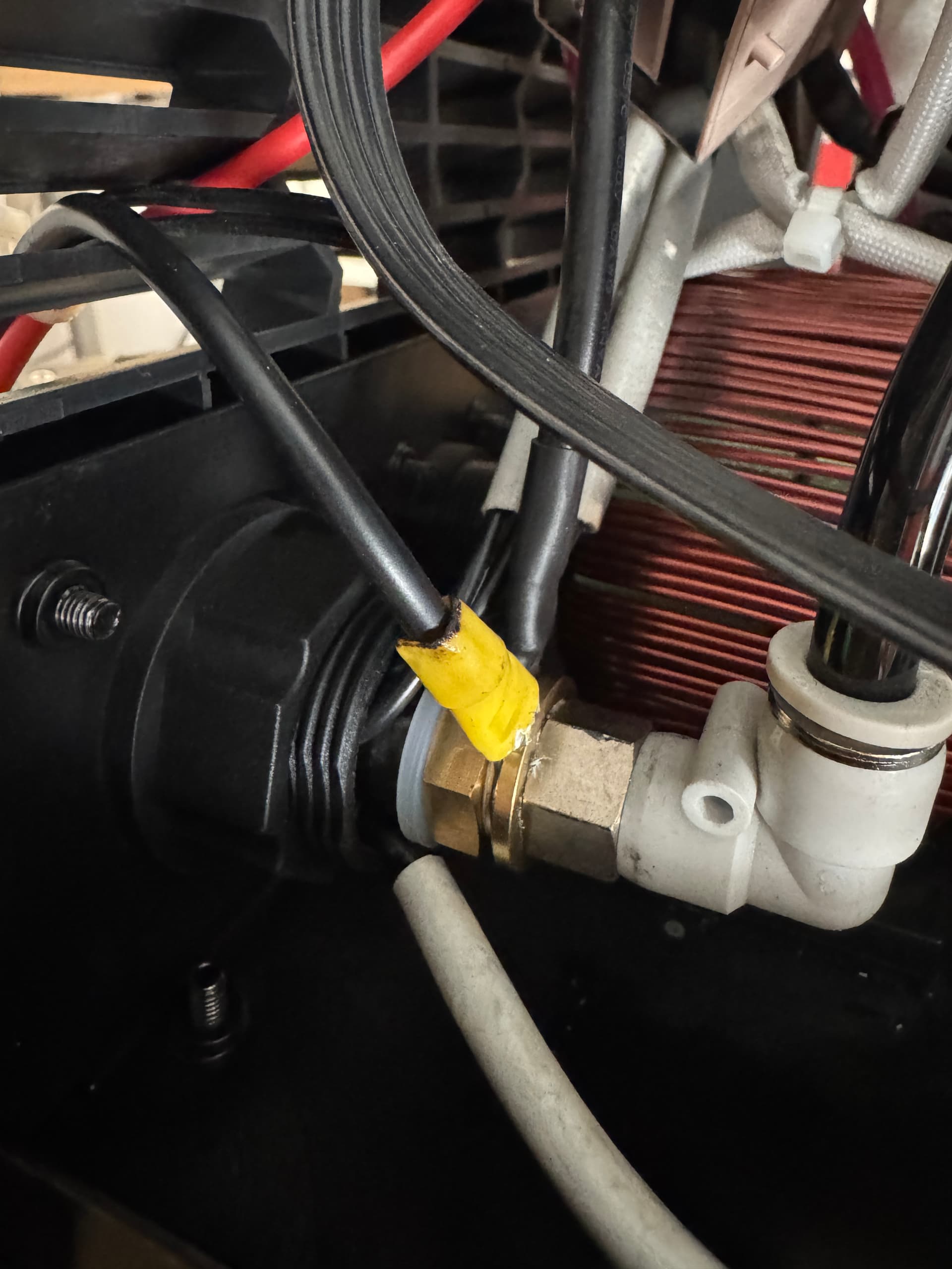

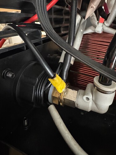

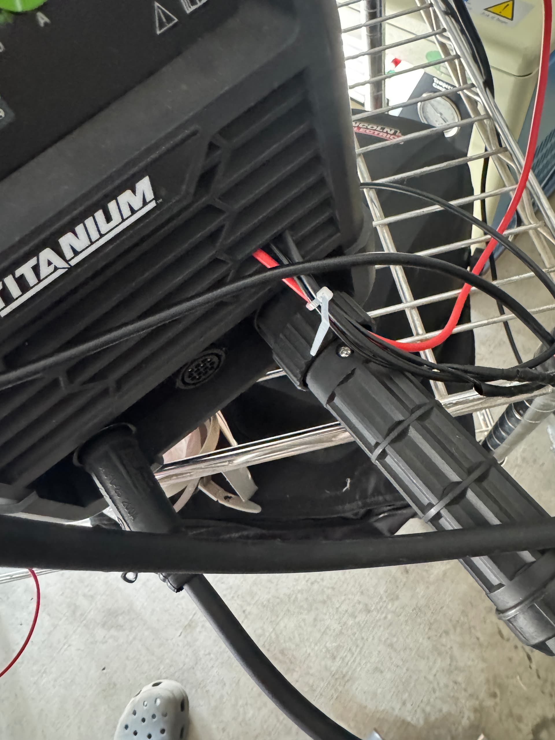

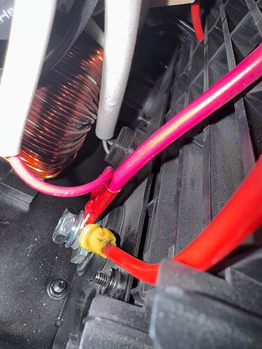

The red wire with yellow insulator is the raw voltage connection to clamp. The black wire with yellow insulator is the raw voltage connect to torch. The yellow insulator appears burnt because I tried melting it slightly to seal. The other small black running through vent is arc on/off
Others are factory connections.
could anyone confirm my connections are correct?
Yes, they look correct. BLACK to torch and RED to work clamp.

THC live voltage test failed, 0V.
Called Langmuir, Raw voltage reading nominal
VIM output voltage nominal
didn’t wanna troubleshoot further so just shipped a new THC board.
Ensure that the front panel hole for the USB is enlarged before installing the new board. Hopefully, you will be on your way to happiness.
