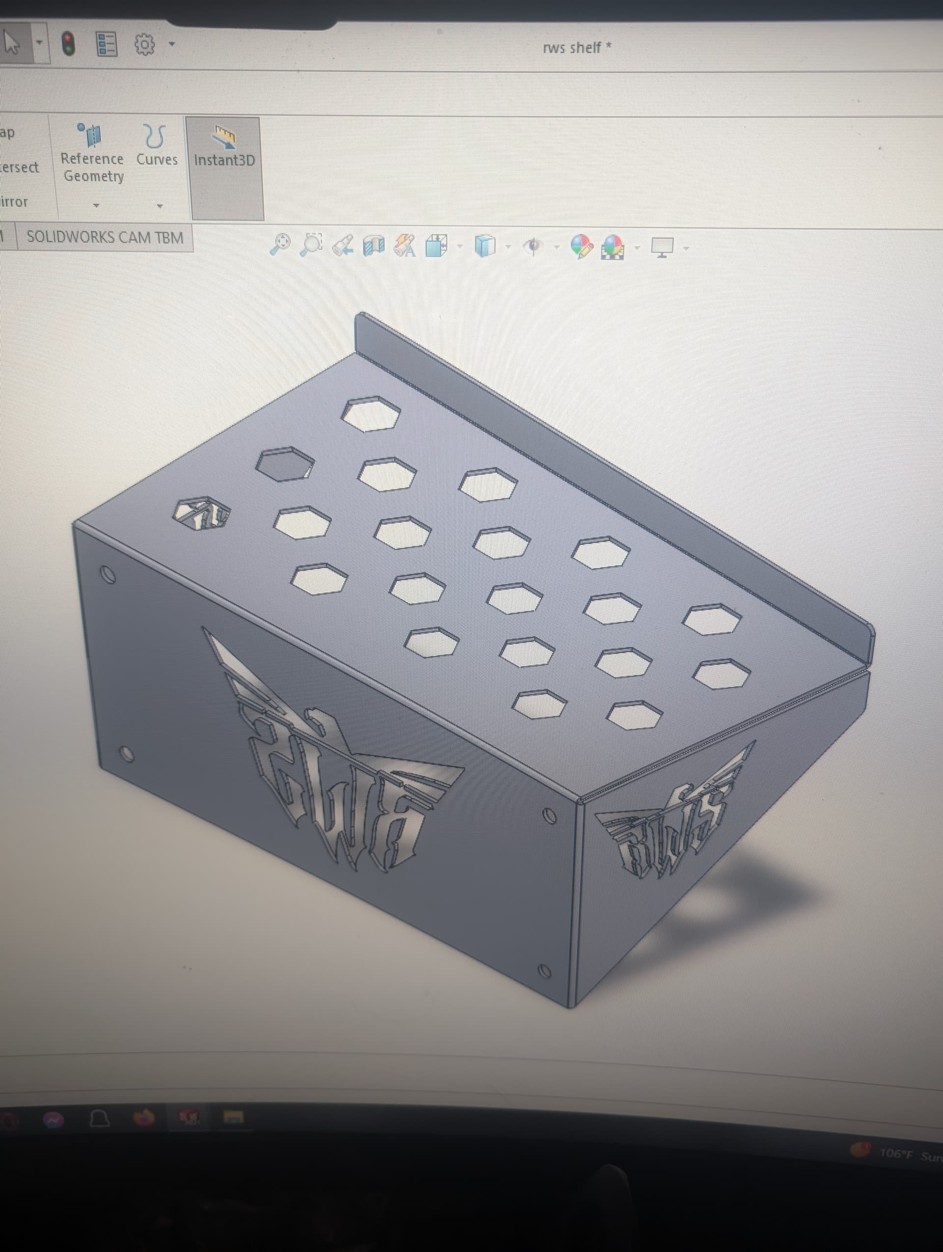

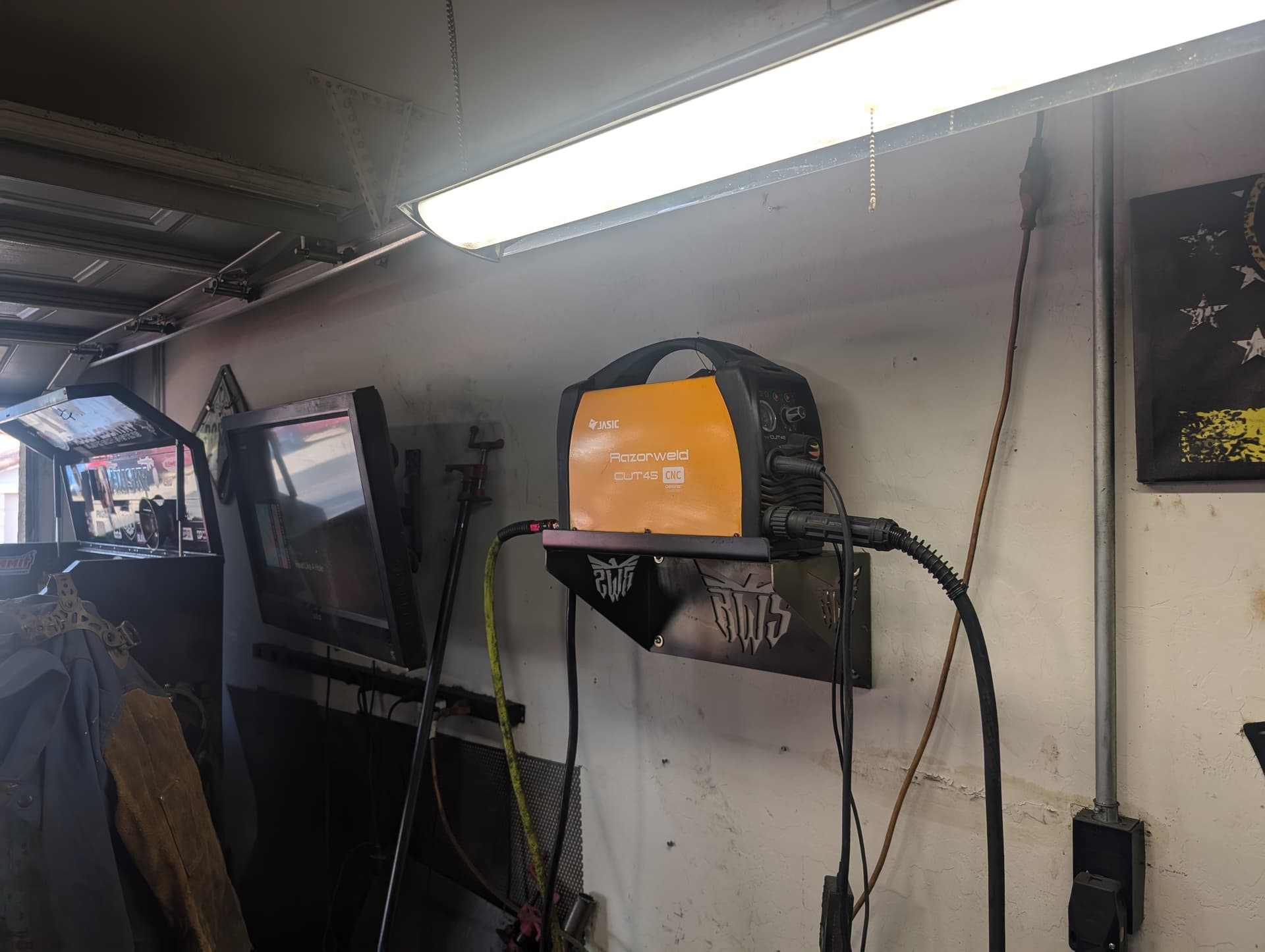

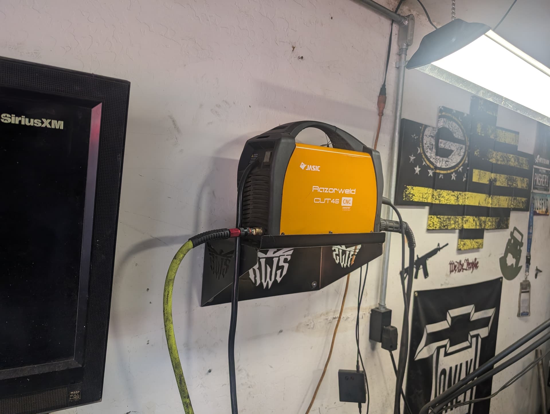

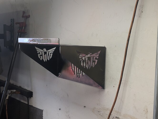

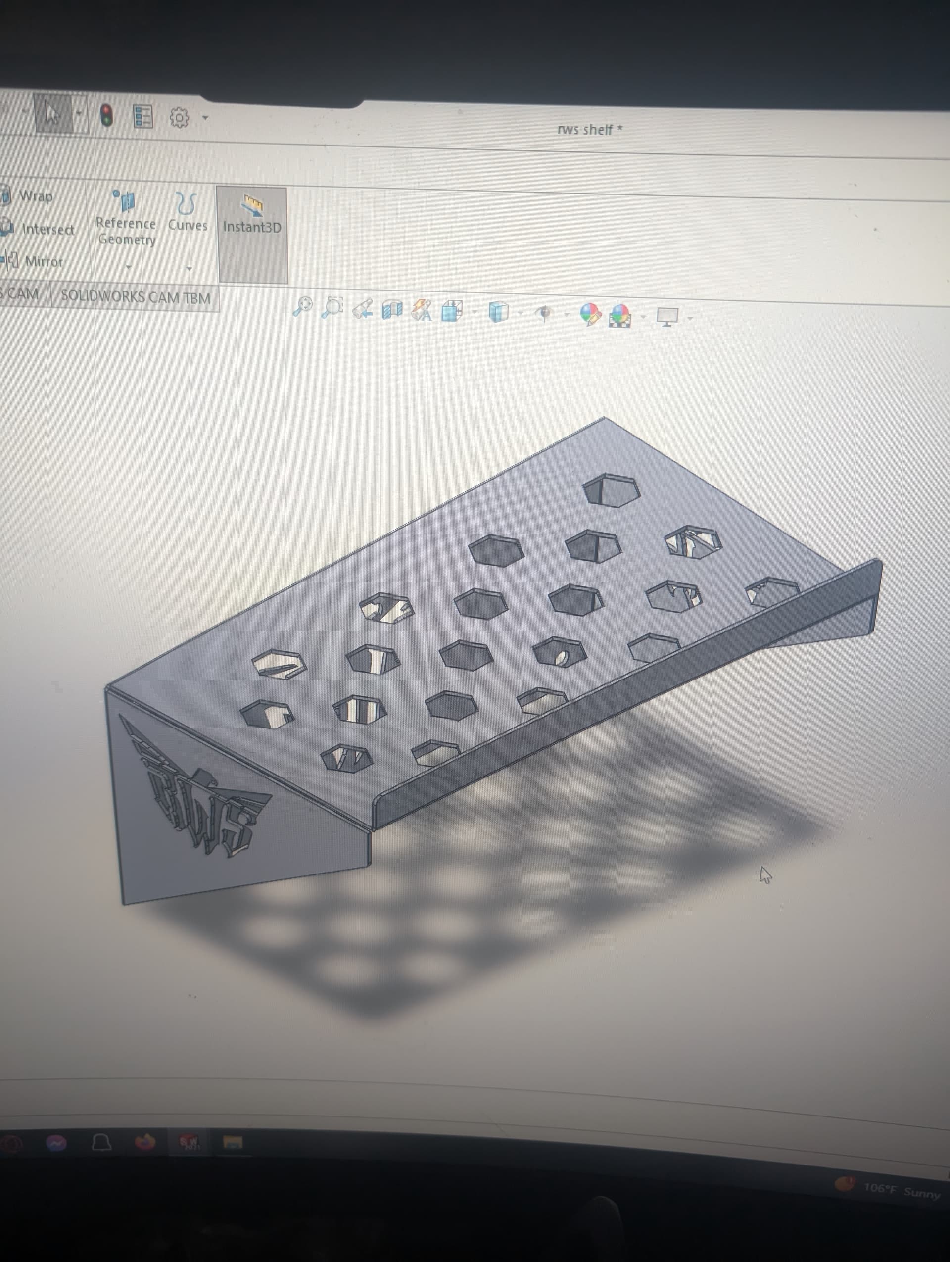

Finally got around to deigning and building the shelf for the plasma cutter, still need to get an aux fan, I was recommended a special fan for plasma cutters from a buddy of mine that I want to look into. He says it hooks up to the air compressor and pushes air through the machine, I have to research it more and see. But I’m happy with how the shelf turned out
looks good! Remember anything that uses compressed air to run puts more strain on your compressor.
