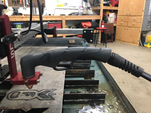

This is probably a dumb question but how do you know if you have the X45 or not? I ordered my table in May, the plasma machine came a bit after that and the table was delivered in July. I am going to attach a picture of the torch that was sent with my machine because it doesn’t really look like the pictures of either torch. Thank you in advance!
That is one of the X45 torch’s. There is two X45 torch’s.
Thank you!!
