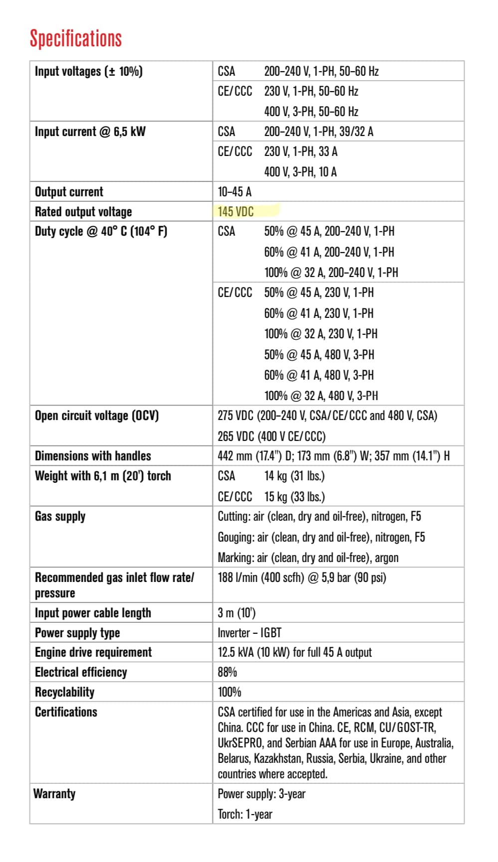

Its NOT the amps that make the difference between say a Hypertherm plasma cutter and others. A Razerweld 45 puts out 45 amps, A Hypertherm Powermax 45XP only puts out 45 amp. The difference is in the wattage output per cutting amps. I don’t have the specs on the Razorweld 45 and the Hypertherm 45XP on hand. Maybe @TinWhisperer can give use these.

As @mechanic416 said electrical power is measured in Watts.

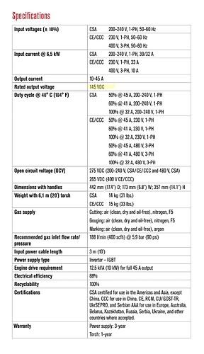

The output voltage for the hypertherm 45XP is 145V
Watts = 145x45=6525W
For the CUT60 the output voltage is 104V
Watts= 104X60=6240W
I have searched but haven’t been able to find the output voltage for the razor weld.
I’m sure @TinWhisperer has it on file somewhere.

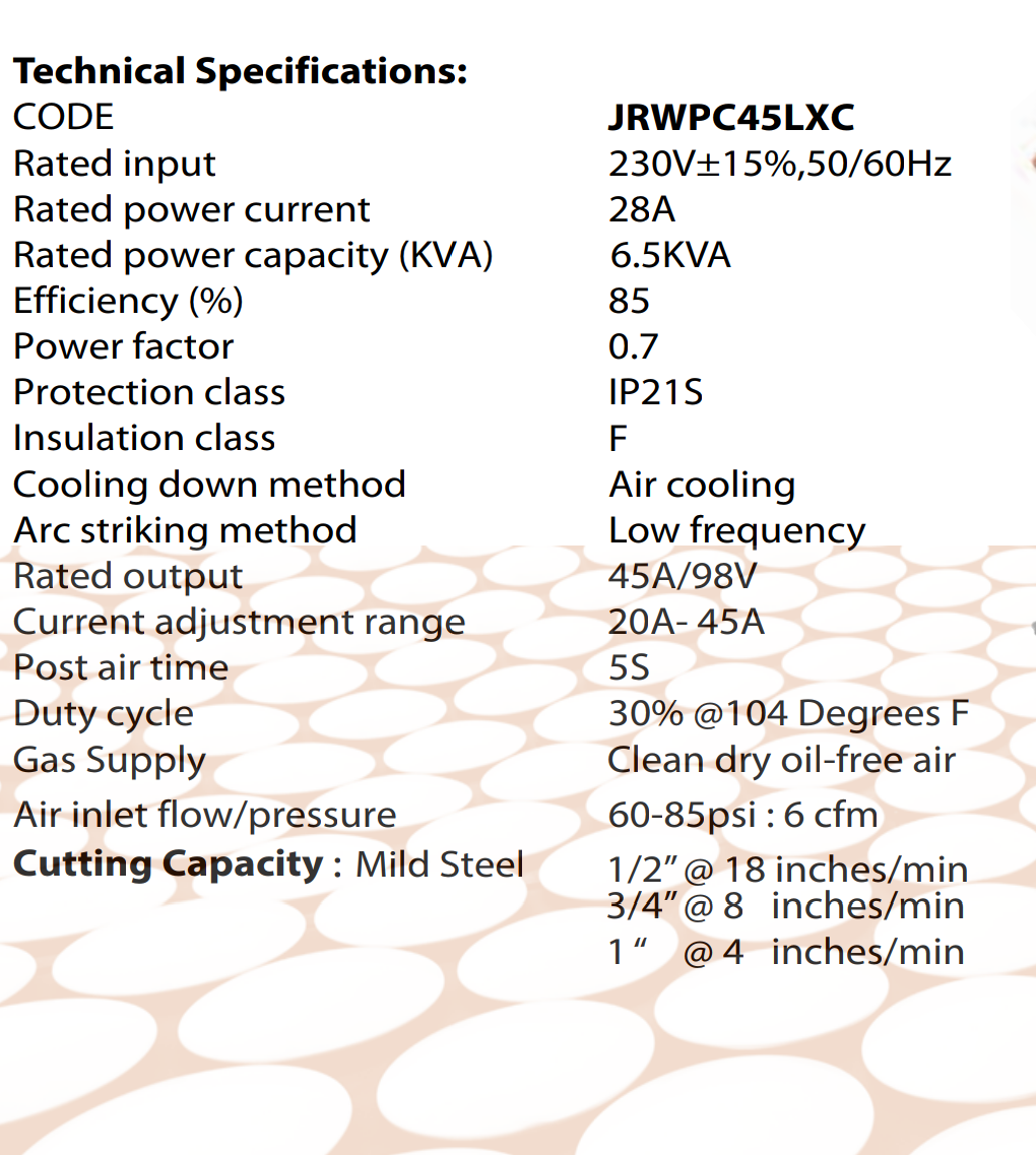

Looks like the razorcut 45 is 98 volts = 4410 watts

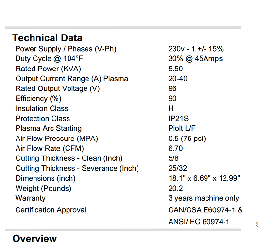

Here are the razor weld specs

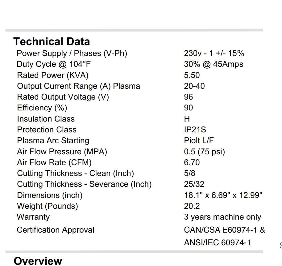

Must be mis print in the manual where it says 20 to 40 amps.
Also it technical spec sheet says outside of 98v and the manual says an output 96v.
There is definitely a few discrepancies between the manual and the technical data sheet and what’s written on the web page.

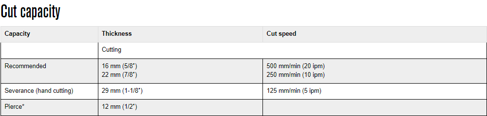

If you want to pierce in 1/2" you’ll want a 65 amp machine. Most manufacturers spec max cutting thickness as edge start. The ht65 says 1" edge start and 5/8 pierce. I’ve only done one piece of 5/8 but it did pierce ok. I’ve done a fair bit of 1/2 and no issues.
The only issue I’ve had with running 1/2" thick at 65 amps was when the cut traversed the water table seam, at which point it cut deep enough through the seam to cause a leak. I was able to TIG from the back, with lots of warp, but it came out close enough that I was able to clamp it down and keep going.
I have no experience cutting more than 1/4 inch mild steel but the literature for Hypertherm 45XP states:
Hypertherm is not in the business of inflating their numbers to sell units.
But, I will agree, if you are intending to give your machine a steady diet of 1/2" steel, the 65 is a better choice.
