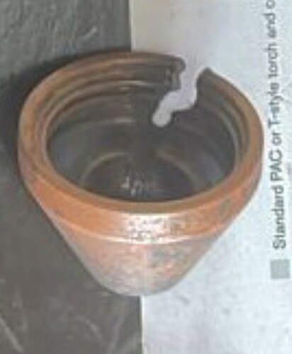

Thanks for replying. I’m attaching some pictures (hopefully, since its my first time on this forum) for you showing the machine, torch and consumables. Hope that helps.

Those consumables have definitely reached the end of their serviceable life.
It looks like the halfium blew right out of the side of the electrode. And did the deflector shield fall off while you’re cutting? is that how you cut into it like that or was the nozzle so badly deformed so the arc wandered that far?
So I picked this machine up from someone who was leaving the country. This is my first plasma cutter. Have a lot of experience with CNC routers and we were looking to expand in to plasma.
In essence, we have no idea what we are doing :joy:. Managed only one cut so far then discovered the damaged parts.
