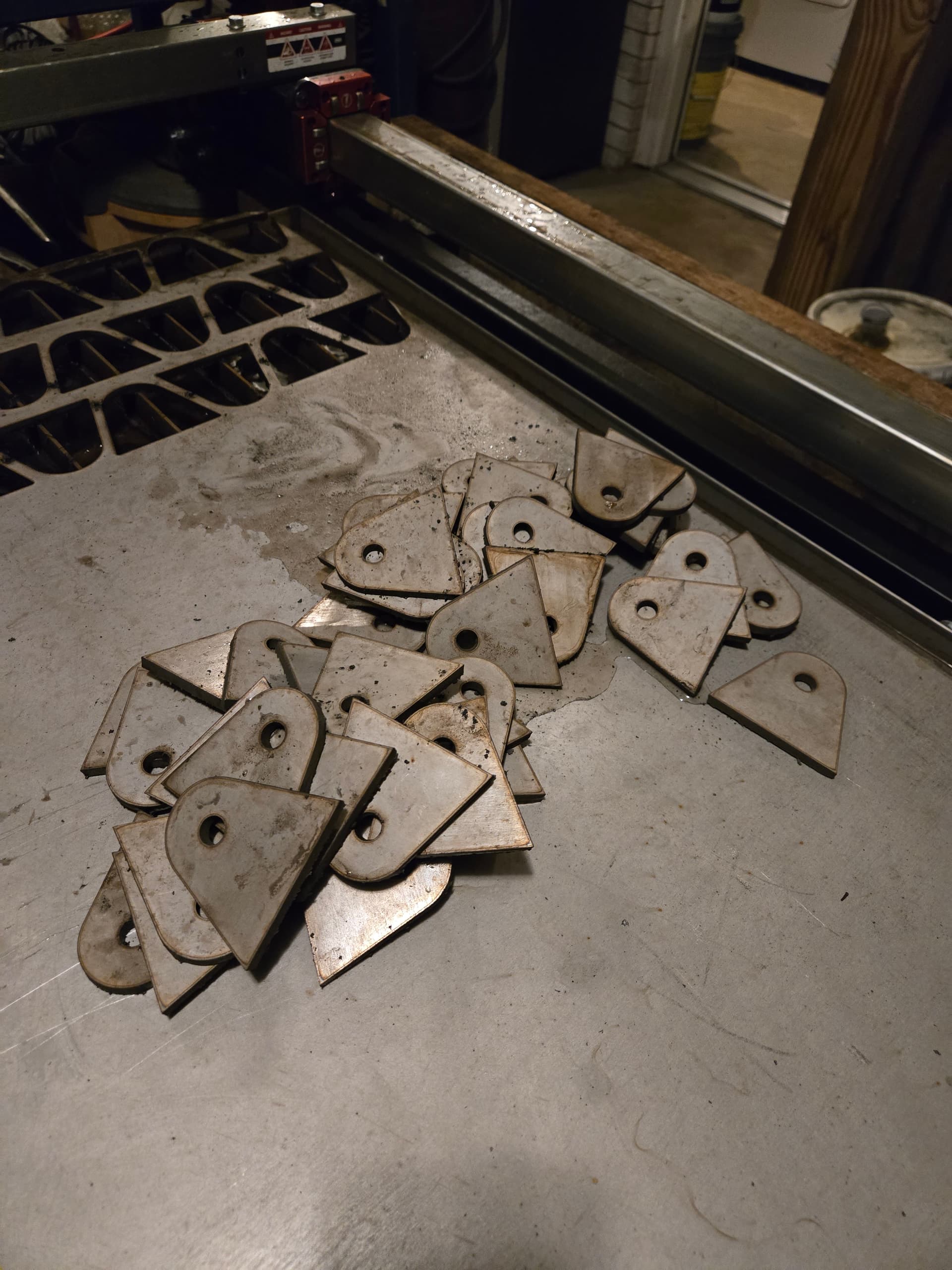

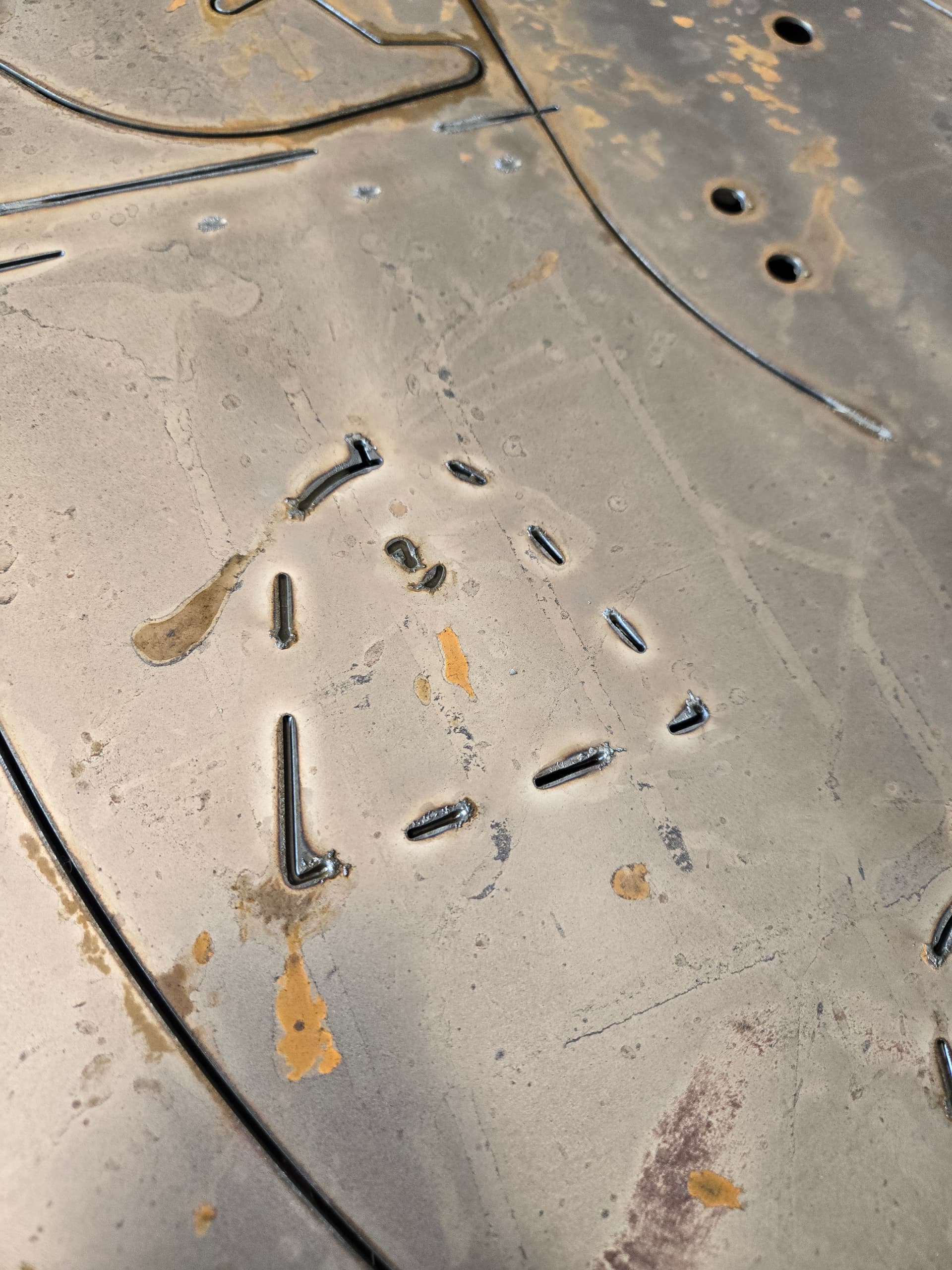

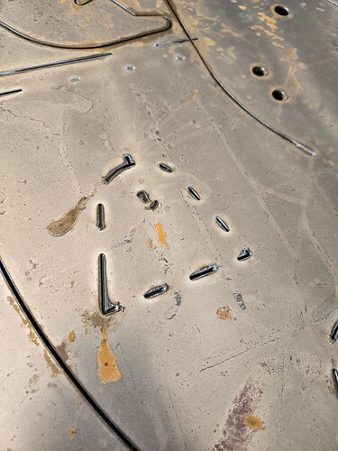

Thats what i was saying, even the firecontrol files are cutting the same as my files. One of the pictures posted are of the straight cut file

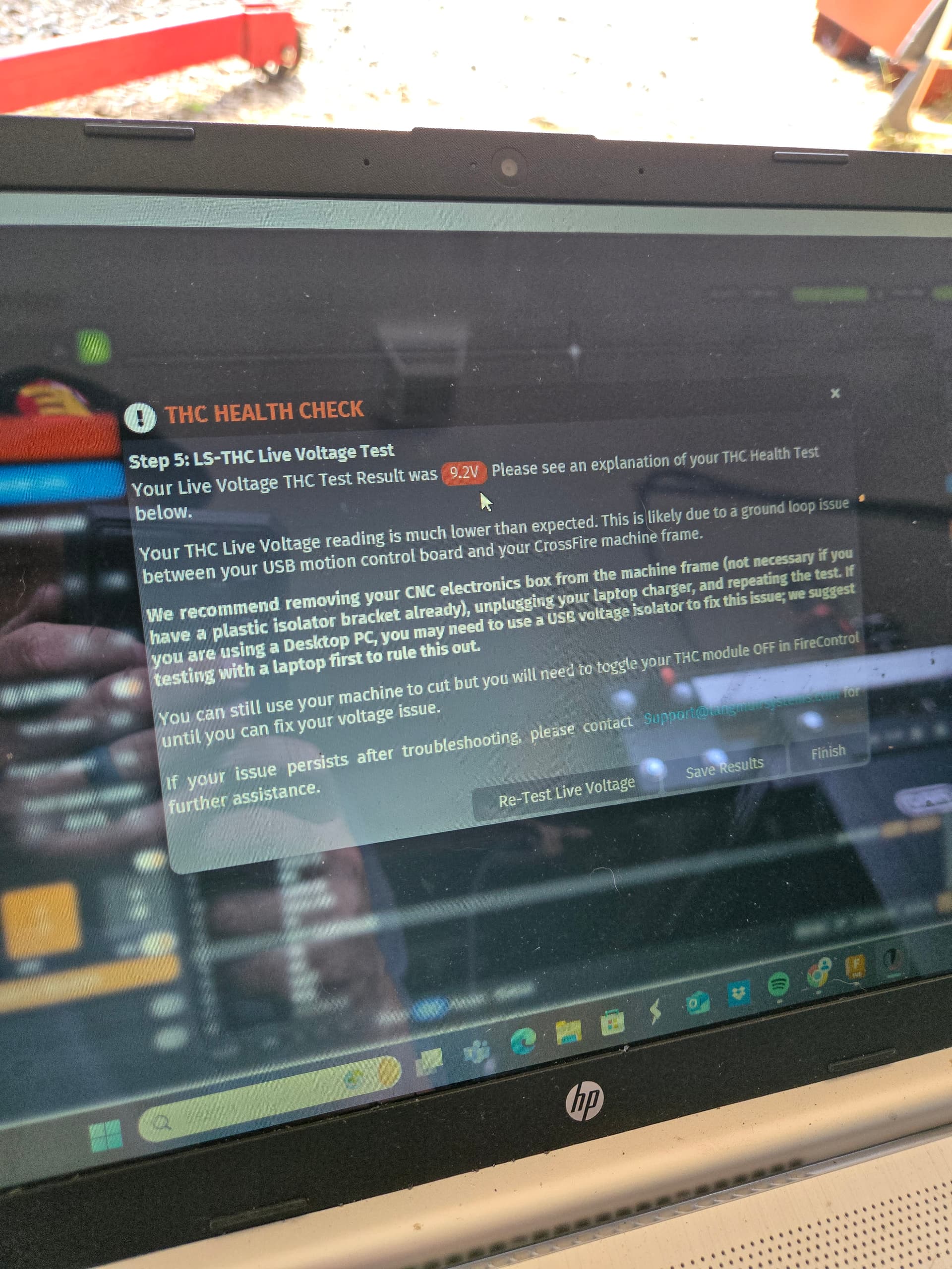

I need to bring my multimeter hope from work tonight to ohm, but once again it stopped firing right, did a thc test, the test failed, took the cover off the control box, loosened a couple munting screws(although it has the plastic insulators), thc test passed but still doing the weird cut thing, did a thc test again and it passed but with a different voltage reading than before. Idk this thing is doing some random spirratic stuff. This morning I cut 10 small light tabs back to back with no issues, then started doing it again
We need to get the multi-meter. Something is likely touching inside the Langmuir controller. Make sure the printer-style USB does not touch the housing. We have seen it before.

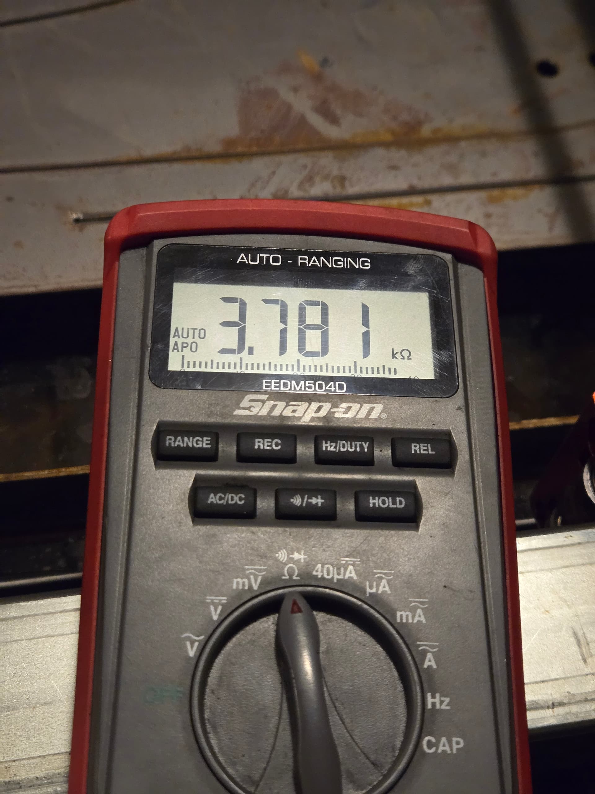

So I am actually getting a tiny ohm reading, about 3.78 kiliohms, but nothing on the “continuity” setting. The usb connection isnt touching the case also

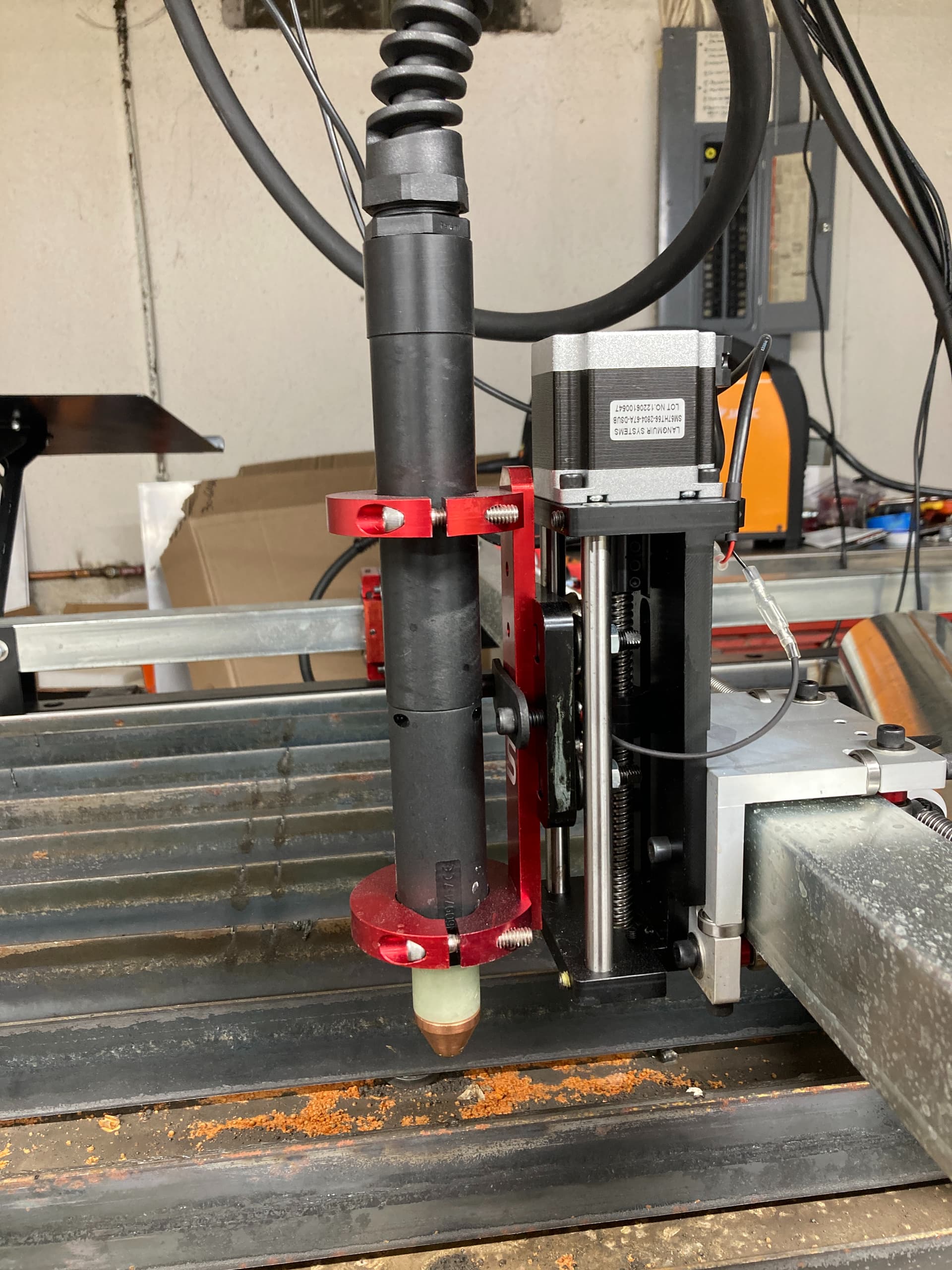

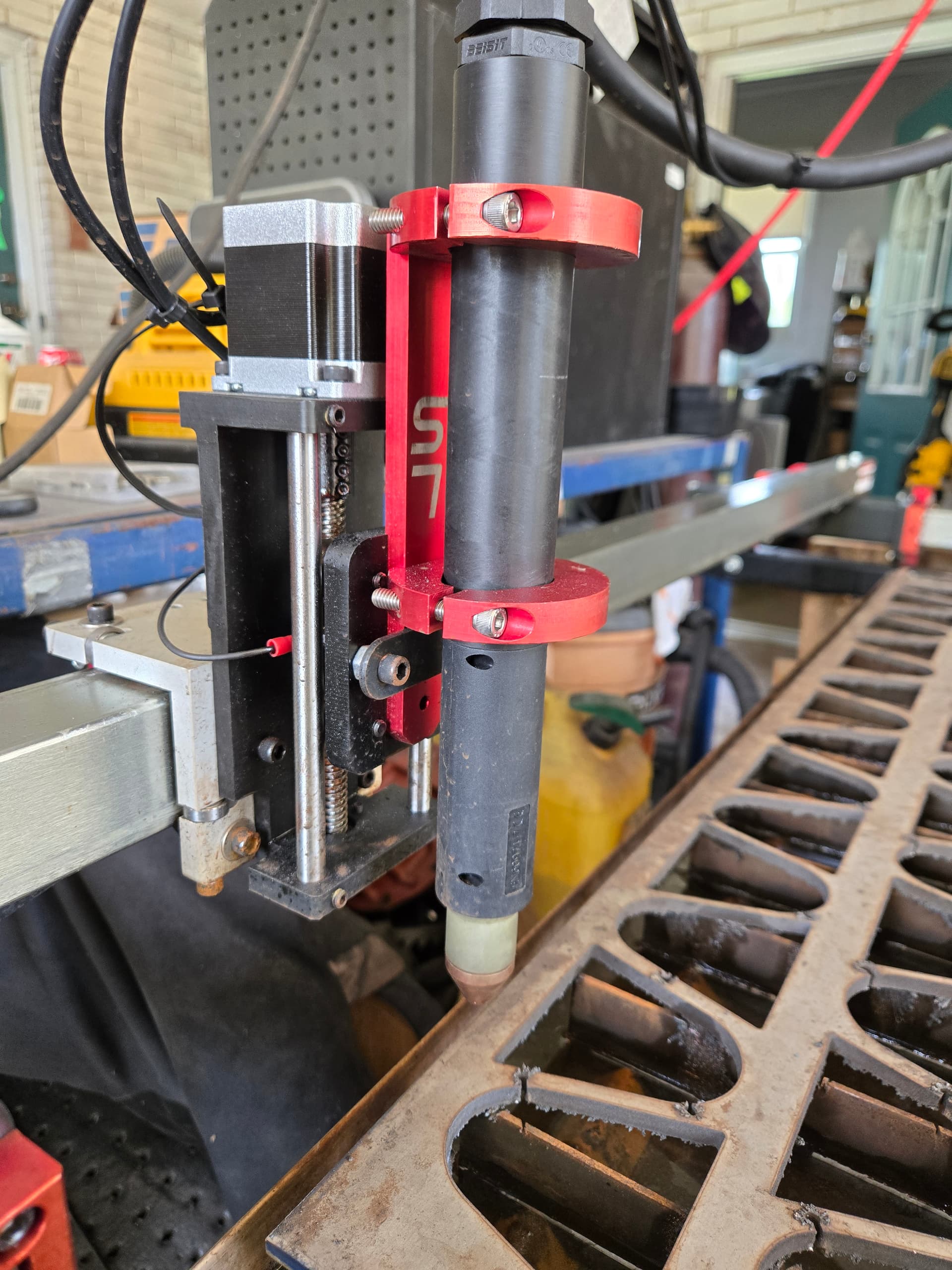

Sorry guys, I’m a little late to the party and I don’t want to hijack this thread, but…

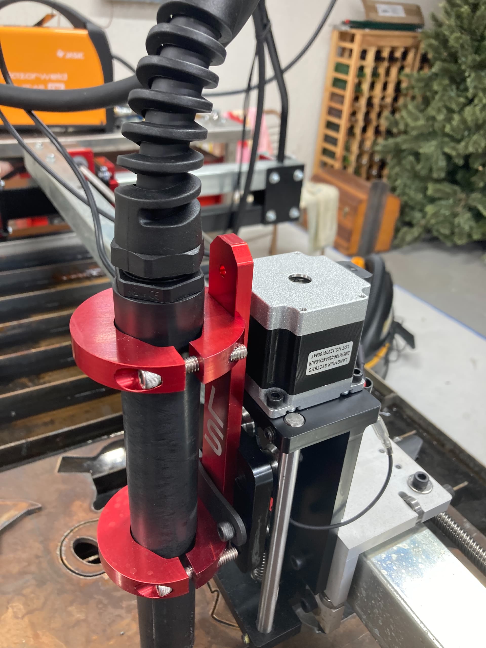

The above post by @Bigdaddy2166 intriqued me. So here is my Razorweld 45 torch setup.
Apparently this is wrong?

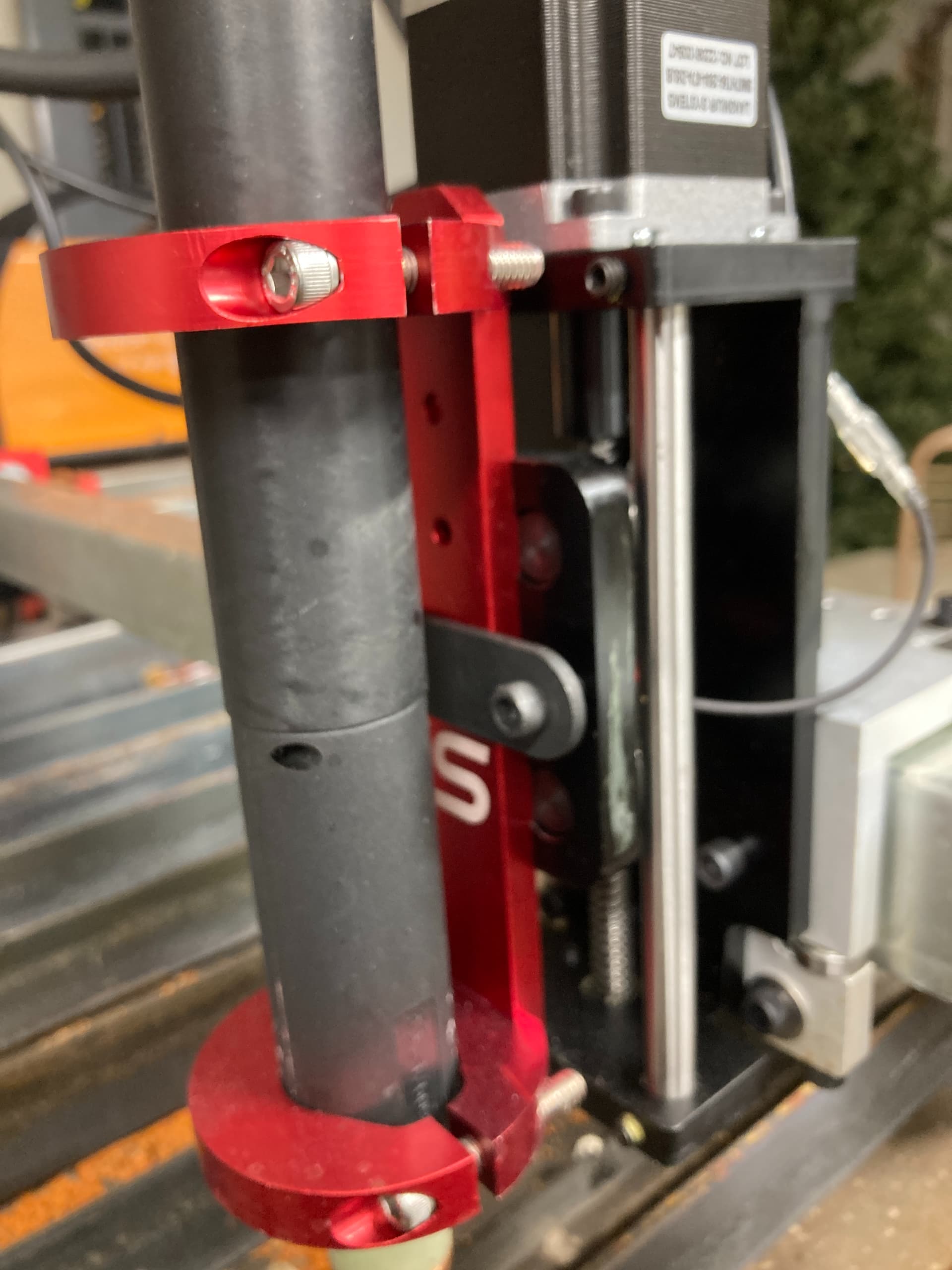

So do I move that “bottom clamp” to one of the upper holes instead of using that bottom hole?

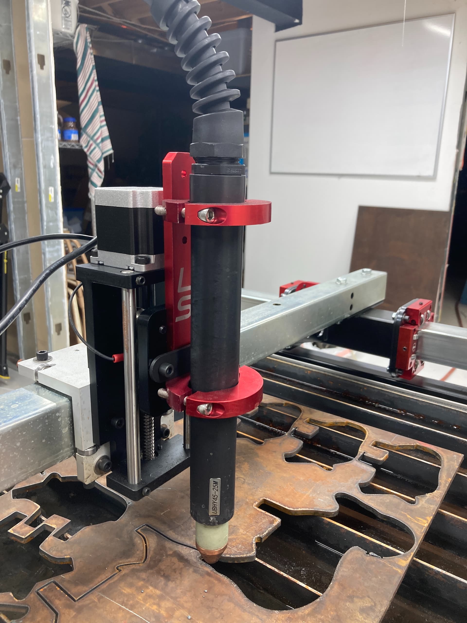

Move the red langmuir clamp up on the carriage and re-secure the torch, as shown in the picture. Then send @mechanic416 a dollar. :sweat_smile:
This electrode must be able to move up and snap down. Clamping it where you had it could bind up the electrode and cause misfires.

Also as far as the torch mount goes, I actually turned mine upside down and moved the one clamp up a few holes, worked out well
Thank @Blaisehudson
Dropping the top mount point '1 notch" worked for me.
