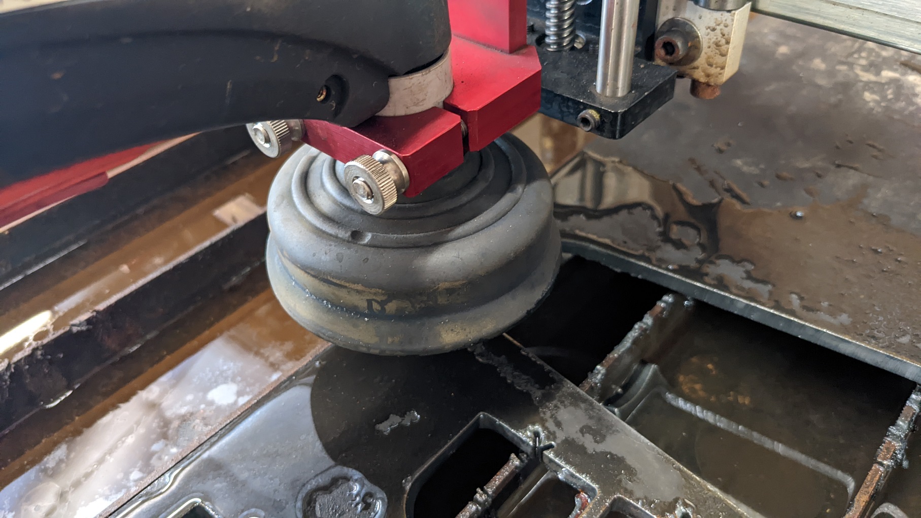

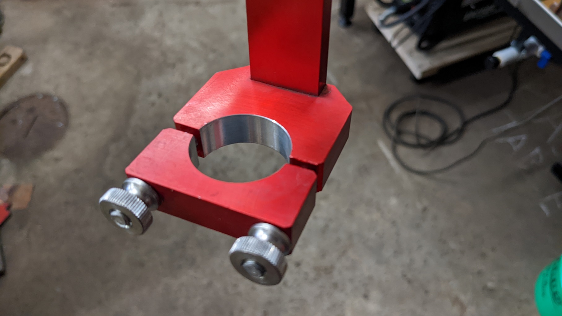

Thought of another thing. The CM82 torch is really too big for the LS holder. Found the torch would shift out of square in the holder. Didn’t want to risk damaging the torch by over tightening the clamp. So bored the clamp true to size. While I was at it, studded and added thumb nuts. Makes for easy tool-less parts changes and excellent repeatability.
