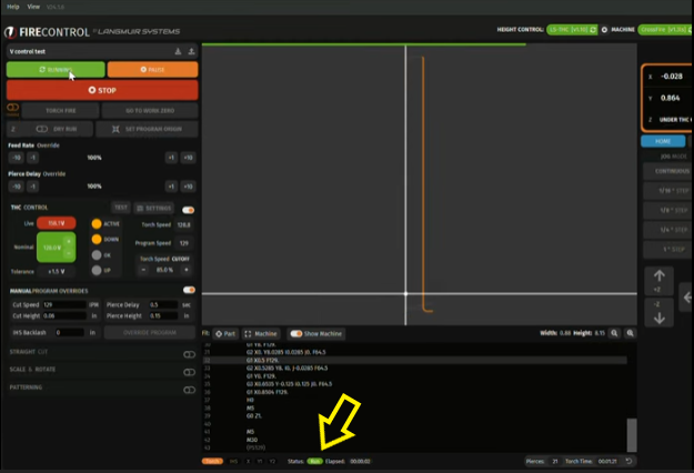

Problems with bevel, maybe THC
It looks like it’s trying to push down the entire time to lower the cut height . Is something mechanically preventing it from pushing down the Z access?

What’s also bothering me here is during the straight line cut test I’m measuring 3.5 volts which undivided would be 175 volts. However during the THC test it’s reporting 56 volts.
Can you supply the gcode? Or perhaps tell us during the course of the file, how many times did that torch actually touch down to the metal?
The reason I ask is because the IHS light came on 7 times during that operation.
I am now re-reading that you were just cutting a straight line. You likely have a break in the wiring for the IHS line or the contacts are loose. Check and see if that wiring is loose. Every time the light comes on, FireControl is telling the torch to lift up 0.06 inches. Since your voltage is reading too high, the THC is telling the torch to lower. They are fighting each other.

That screen recording was not a straight line cut. That was a rectangle. My voltage tests I describe later in the thread were done using a straight line cut.

Yes. Turns out it would be the same thing as it was only cutting one contour. The gcode for the rectangle only required touching down once to establish where z=0 was. That is the one time that IHS light should have come on. All of the other times it came on were because the IHS circuit was erroneously telling FireControl that the torch was hitting the plate.
Jim is on to something with the IHS light coming on. That indicates that there is a problem wih the IHS wiring or the IHS switch is getting hung up on the lead screw and opening every time the THC tries to push the torch down, which tells Firecontrol to raise the torch again.

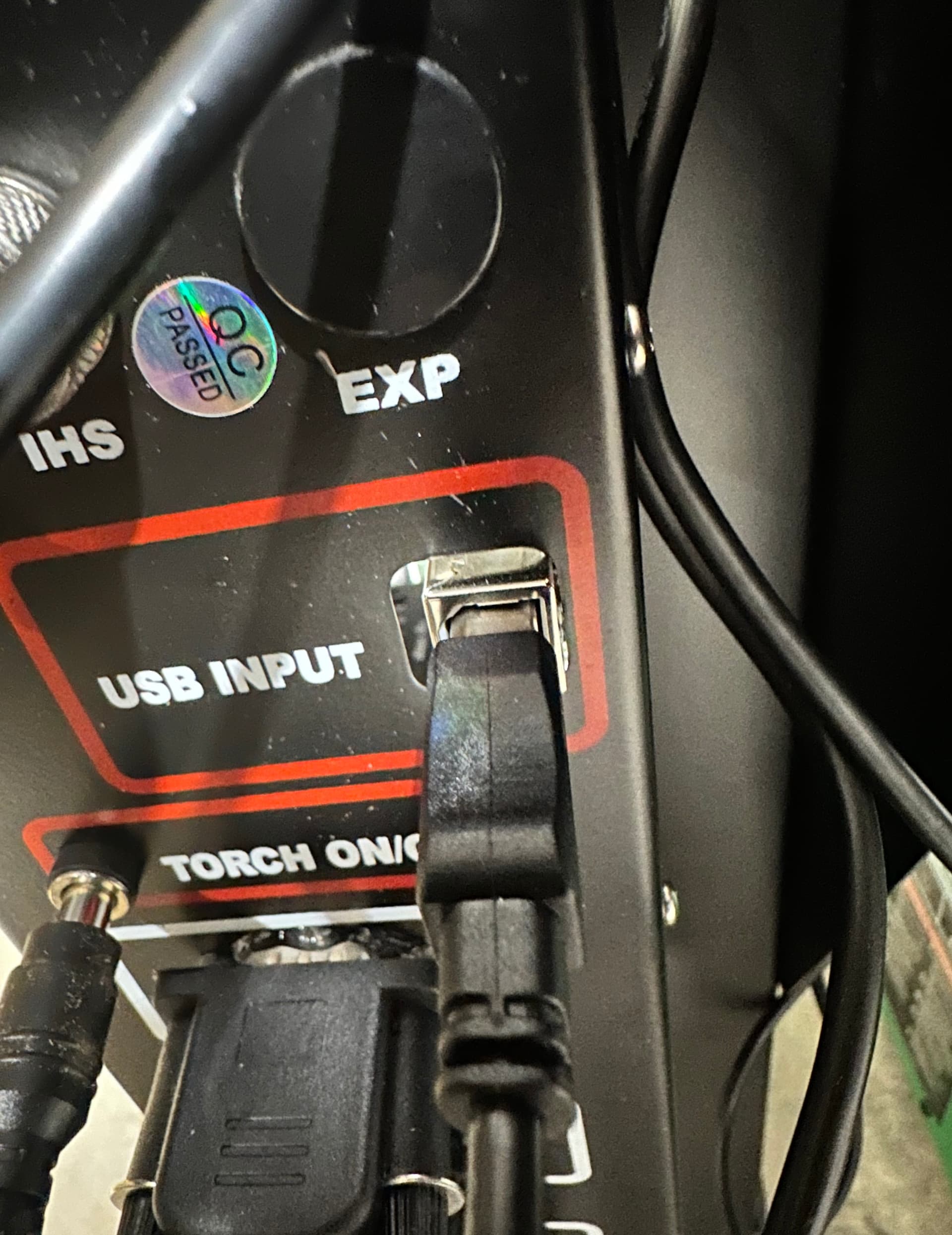

is the usb shell on the control box touching the outer shell of the control box?

In this photo, the USB shield is touching the housing, which is a major issue.
It creates a ground loop that seriously affects the THC control. We have seen many instances of this issue driving people up the wall

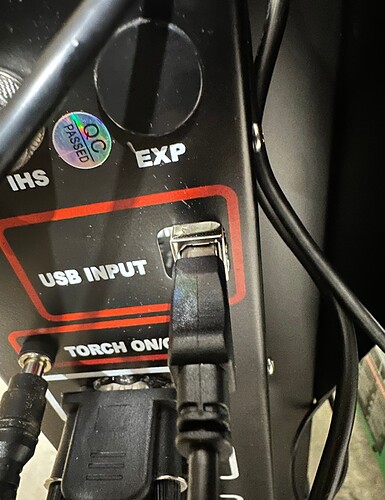

Mine looks like this.

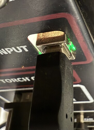

it is touching you need to shim out the board. may not be all your problem but it doesn’t help
Try sticking a piece of paper between the USB and the metal enclosure and see if that changes anything.
I loosened the screws and inserted a piece of paper around the outside of the USB connector. Before it was showing a short from the outer jacket of the USB plug to the enclosure. Now I’m seeing 1.5K ohms between the outer jacket of the USB plug and the enclosure. Ran another test cut. No change.
