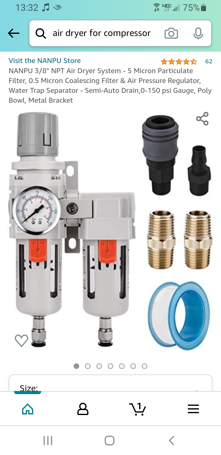

What are you doing for drying and cleaning the air supply?
Video or pictures may help.
Nothing. Is that important?
Will this work?

air supply if not dry and well filtered can cause all kinds of problems

I did Google them and ordered a set of six off Amazon in the last hour, along with a water filter/separator.

Yes clean dry air is critical. If you post pictures of your consumeables we will be able to tell if contaminated air is ruining them prematurely.
What you posted is probably not enough to clean the air, most people run a copper manifold at the least, or a refrigerated dryer. A motorguard filter is the last item for most of us. Oh and a desiccant holder.

Maybe someone can add to this but I believe I read that there is a fix/modification to the RW45 to rectify this issue? Something with a jumper, maybe? I run a Hypertherm so didn’t get too deep into it, but there were instructions on the Langmuir site. Again maybe someone can add to this, whether it is even relevant. Also, in terms of a water separator, what you have would be the minimum. I don’t believe this is your issue but you may want to consider a Motor Guard “toilet paper” filter just before the plasma. Again, I don’t think it’s your problem here, but when you get going it will help immensely with your quality.
