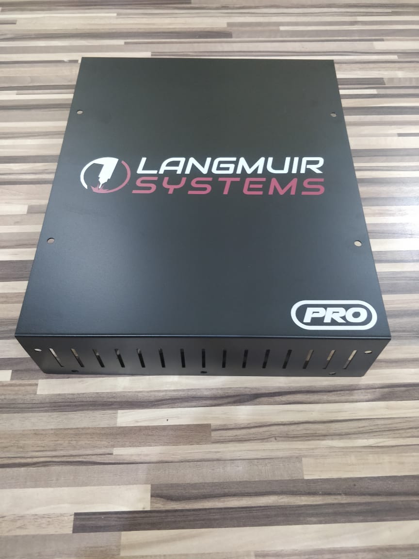

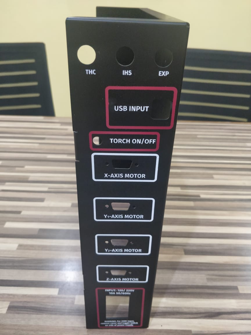

PRO Electronics Enclosure - First Look
We received the first article samples back from our silk screener for the new PRO electronics enclosures. We think they look great and we can’t wait to get them all assembled soon!

Hello, I am currently assembling my CrossFire Pro and referring to the electronics enclosure, the instructions state the following…
“If you are using the CrossFire or CrossFire PRO in a location with 220V power, be sure to flip the switch on the power supply to avoid damaging the power supply and other CrossFire electronics. It is set to 110V by default.”
I’m assuming this just for the electronics enclosure and not pertaining to the Razor Weld torch, correct?
Also, I am capable of running either 110V or 220V so, I’m wondering what is the advantage of running the enclosure on 220 vs 110?
Thanks! I have yet to receive my Razor Cut 45 but, making sure I’m ready for when it arrives! :smile:
The vast majority of the world uses 220 voltage .
the 110 volt switch it’s just for our convenience in North America.
All that selector does is change is the amount of windings on the primary transformer in the electronic enclosure so you end up with the correct amount of secondary voltage.
Your plasma cutter also can accept either voltage. 110 volts will give you less cutting power if you choose to run it that way.
Thanks! I am wired for 220 at the torch but not the enclosure. I was just wondering if the X,Y,Z stepper motors ran better or, more efficiently on 220v?
Just plug it in to a 110 wall socket there’s no efficiency to be gained. maybe in theory but not practically.
