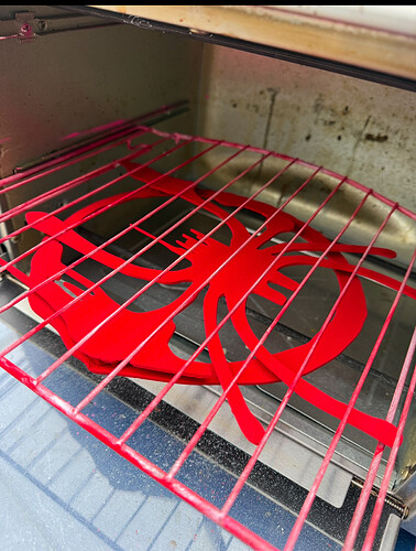

I use a 24”x24”x24” cardboard box with a fan and furnace filter as my powder booth. I use a counter top toaster oven. Works well for small stuff.

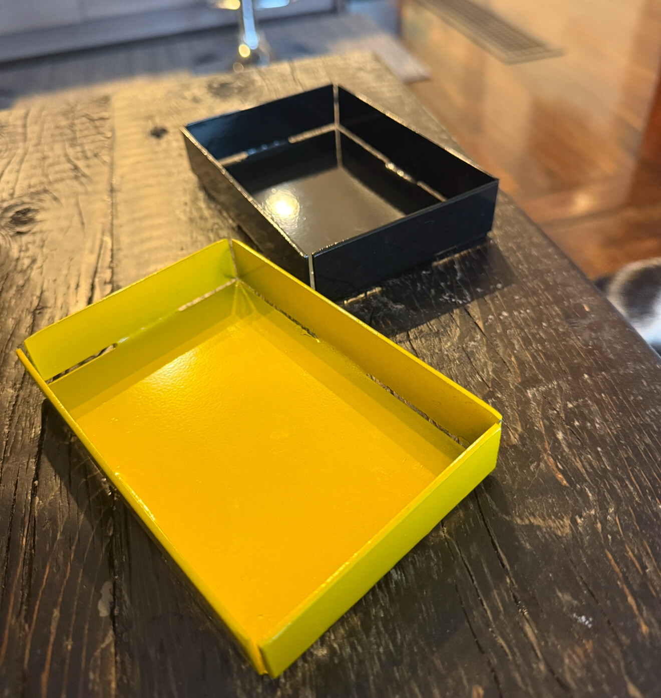

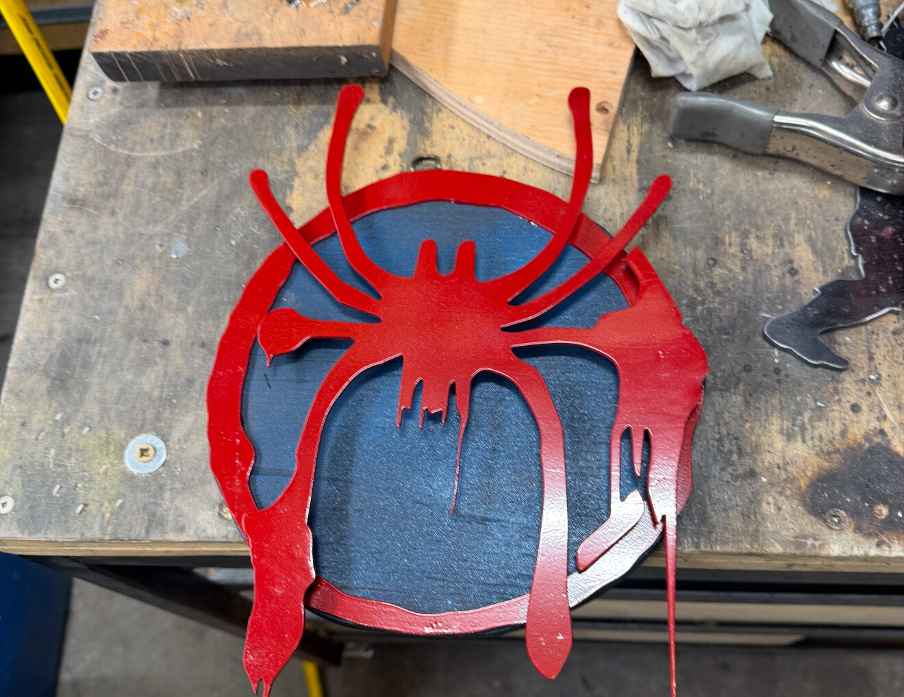

One of the first small boxes I cut with the CNC. Ended up PC them. Didn’t really take much time to prep other than a light sanding. I have a few more projects soaking in vinegar!
Junk/ trinket boxes

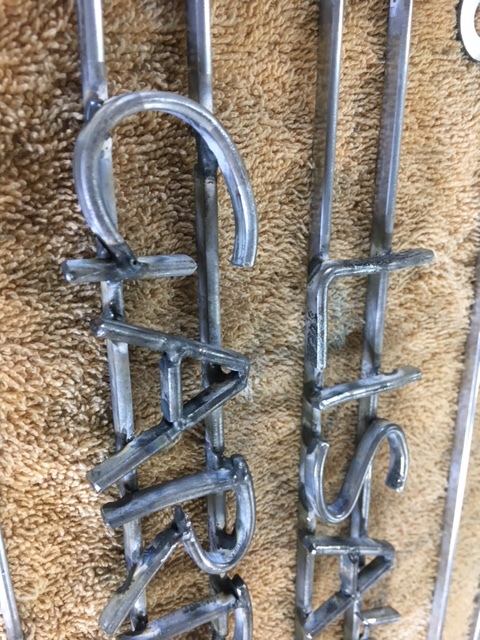

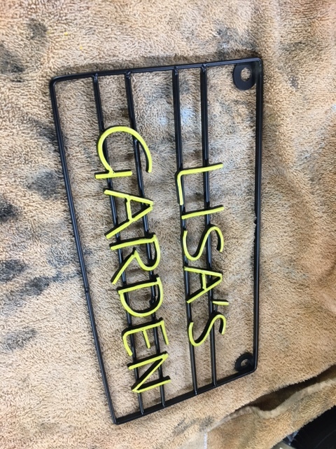

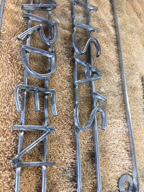

Here’s a set of hand formed & welded garden signs I powder coated a while ago.
signs yellow
Very nice! Looks like you bent all the letters! Lots of work. How did you do the two colors?
