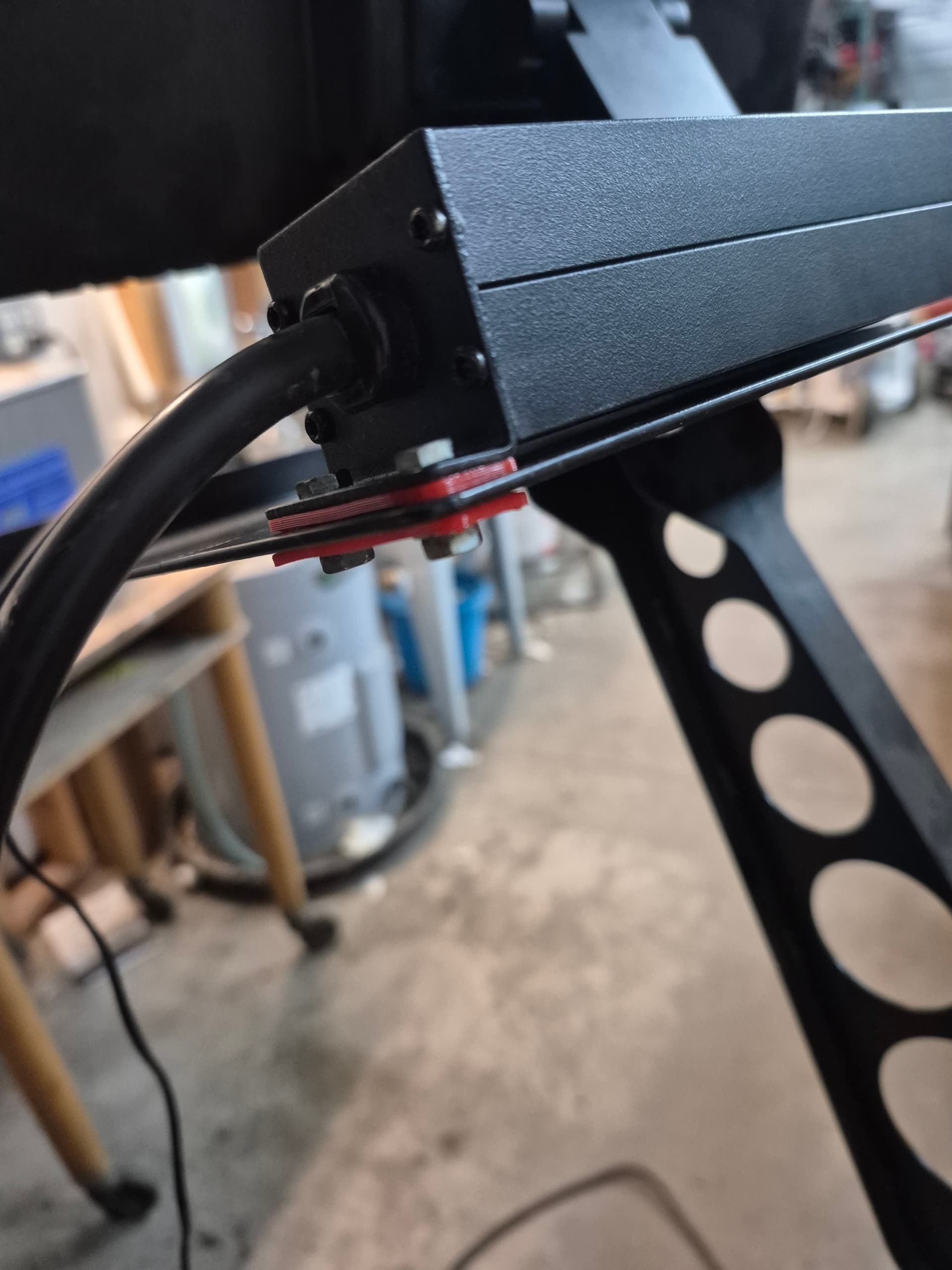

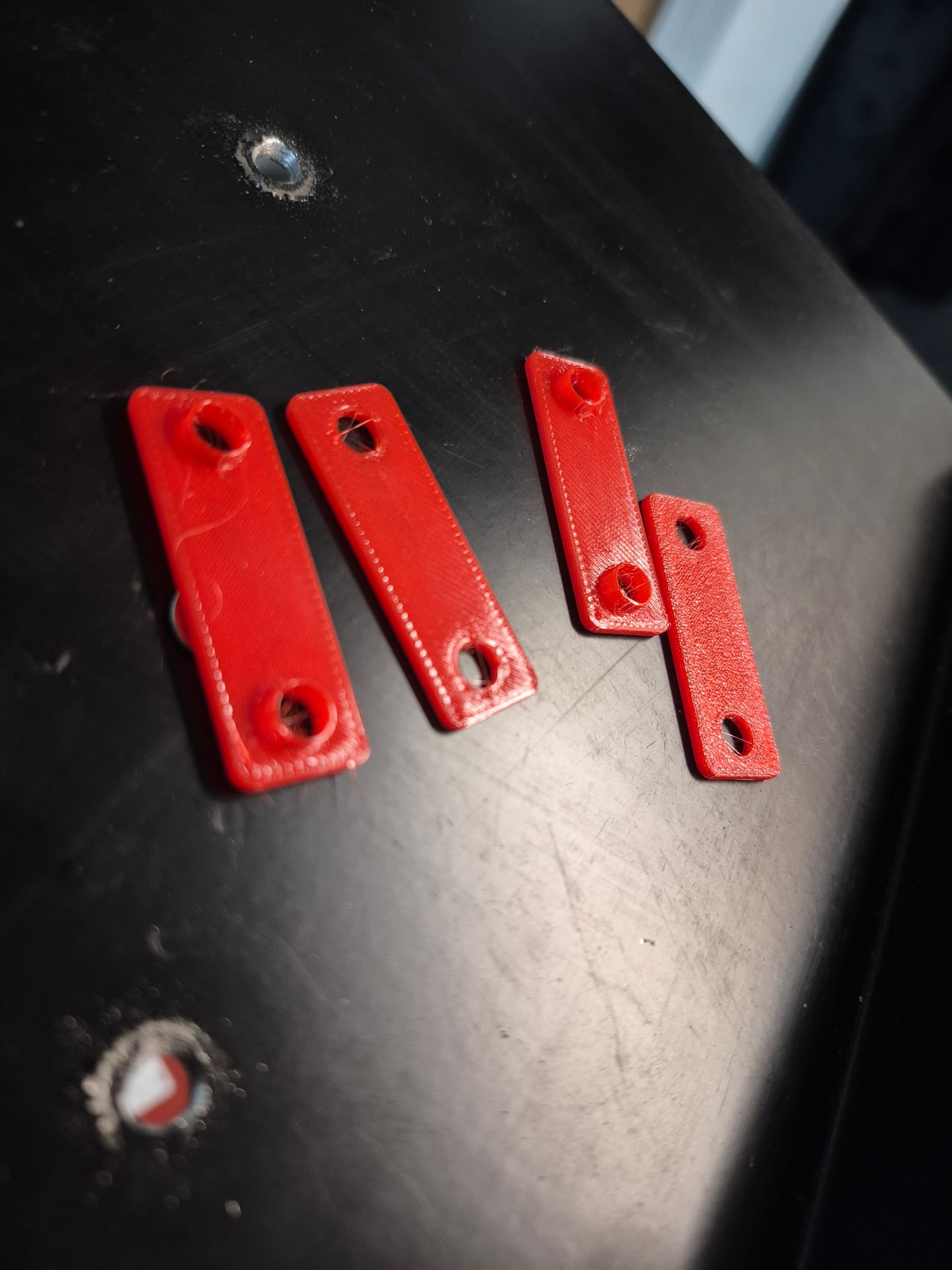

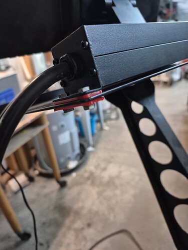

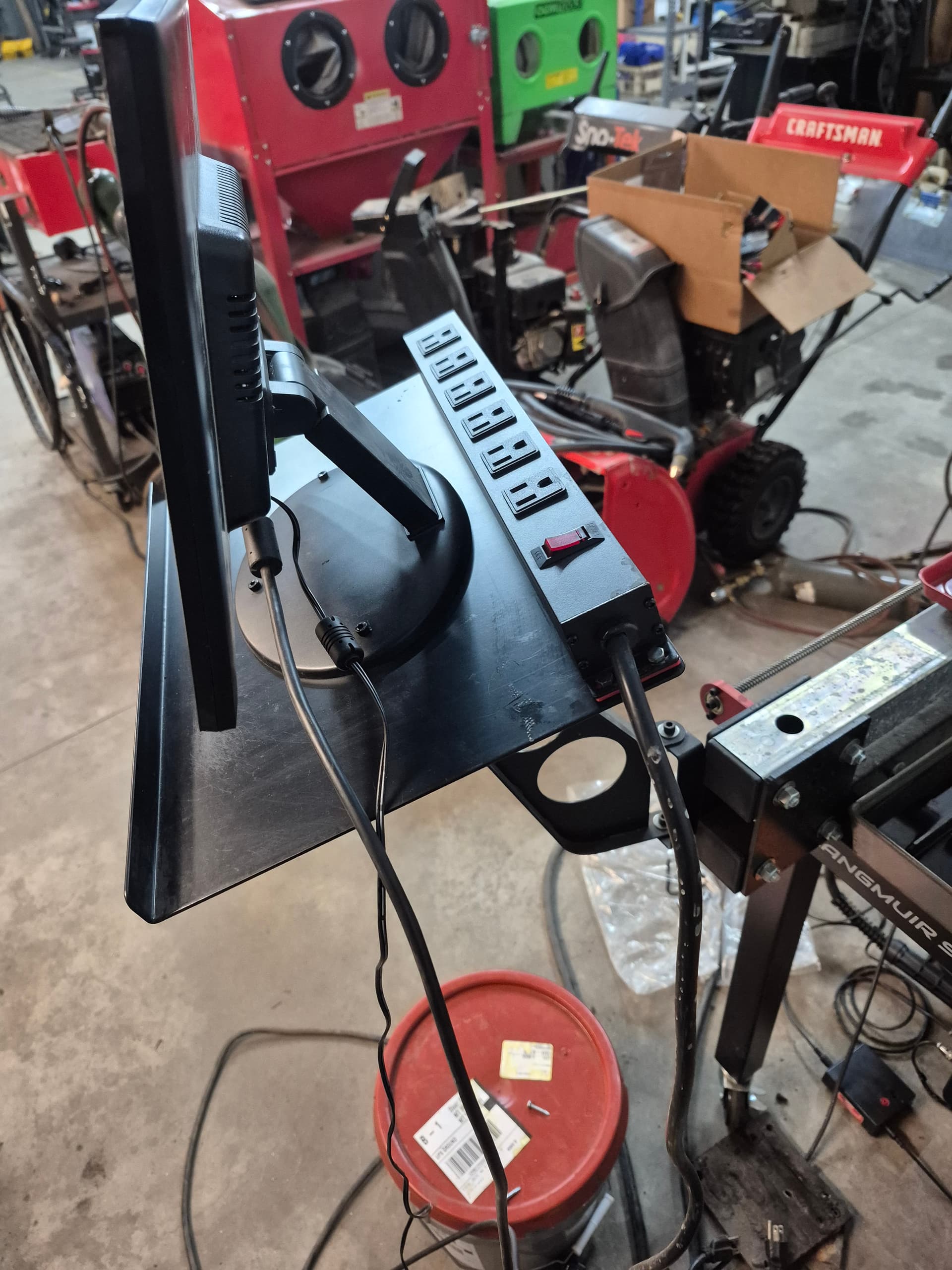

I wanted to mount a power strip to my Crossfire computer tray so it wasn’t getting splashed and was easy for me to access. After seeing all the issues with grounding, dirty signals, and what not I was concerned with mounting it like I wanted. So I printed out some isolators from TPU on the printer. I think it will do the trick. I drilled .25" holes and the top isolators have a sleeve built in that goes through the hole to make sure the mounting hardware doesn’t touch the tray. Anyways, don’t know if anyone will want to do the same so I attached pictures and the print file.
