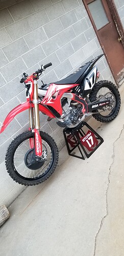

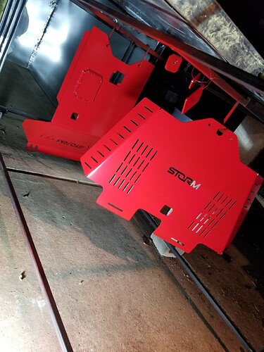

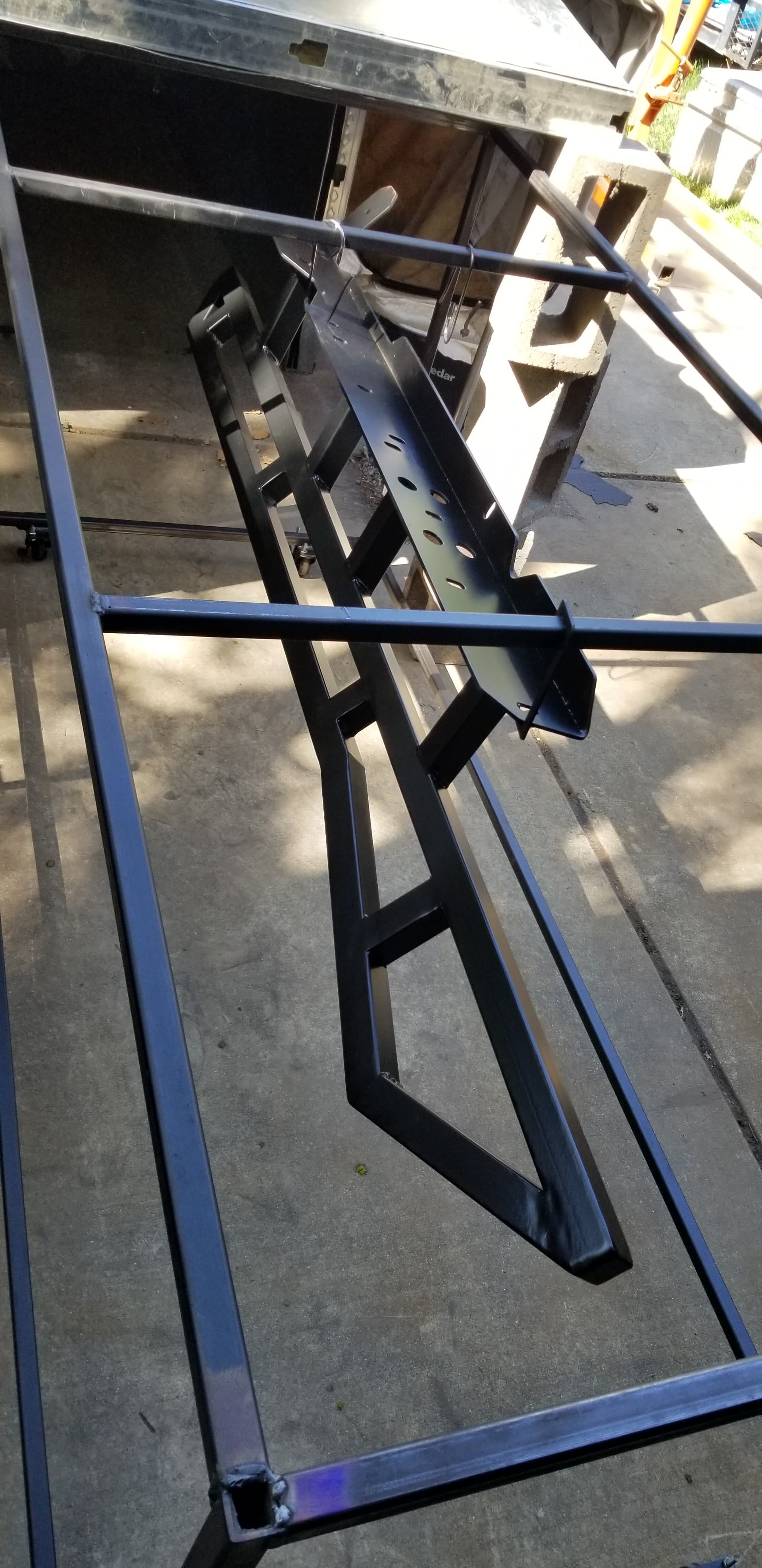

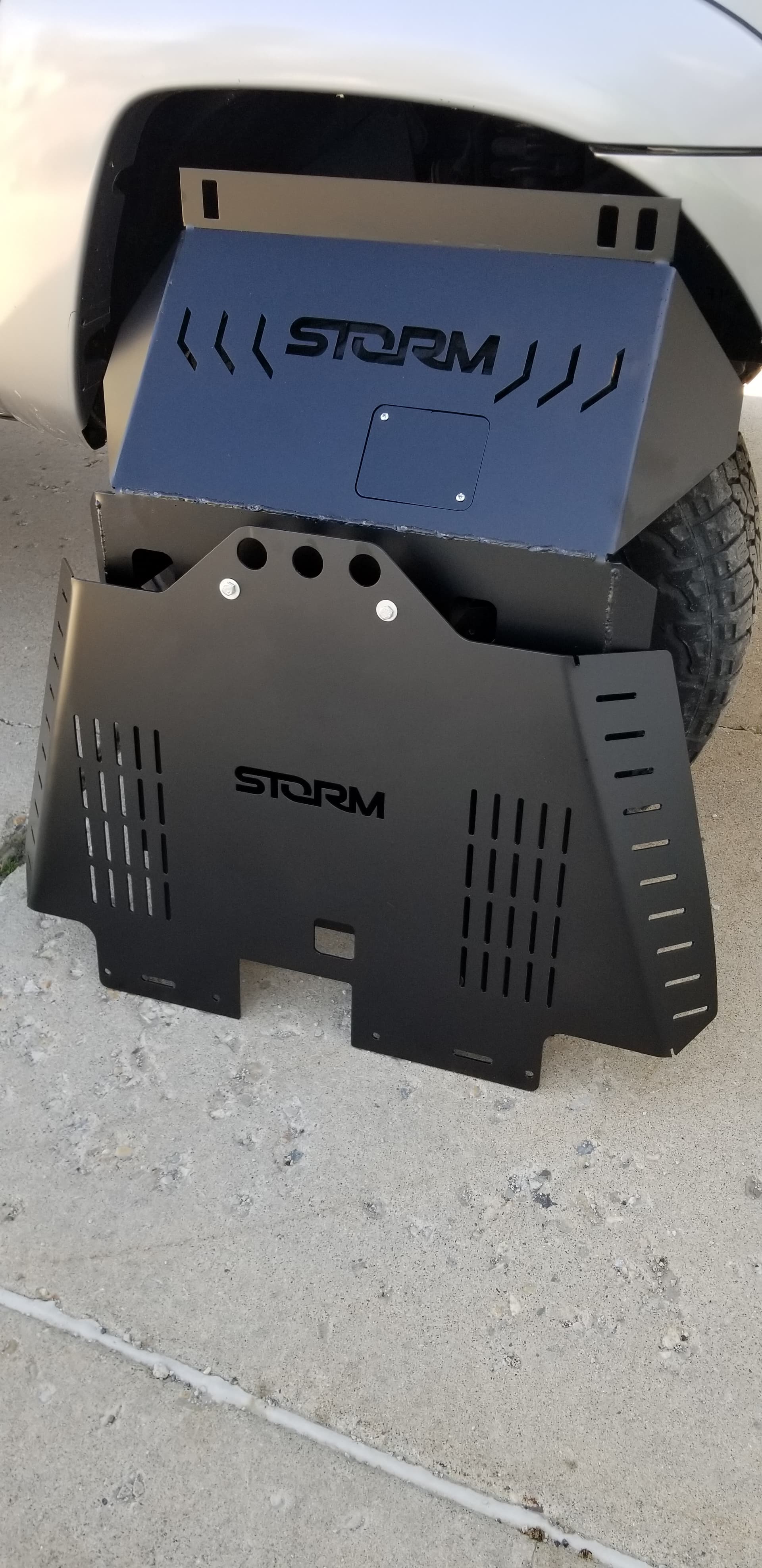

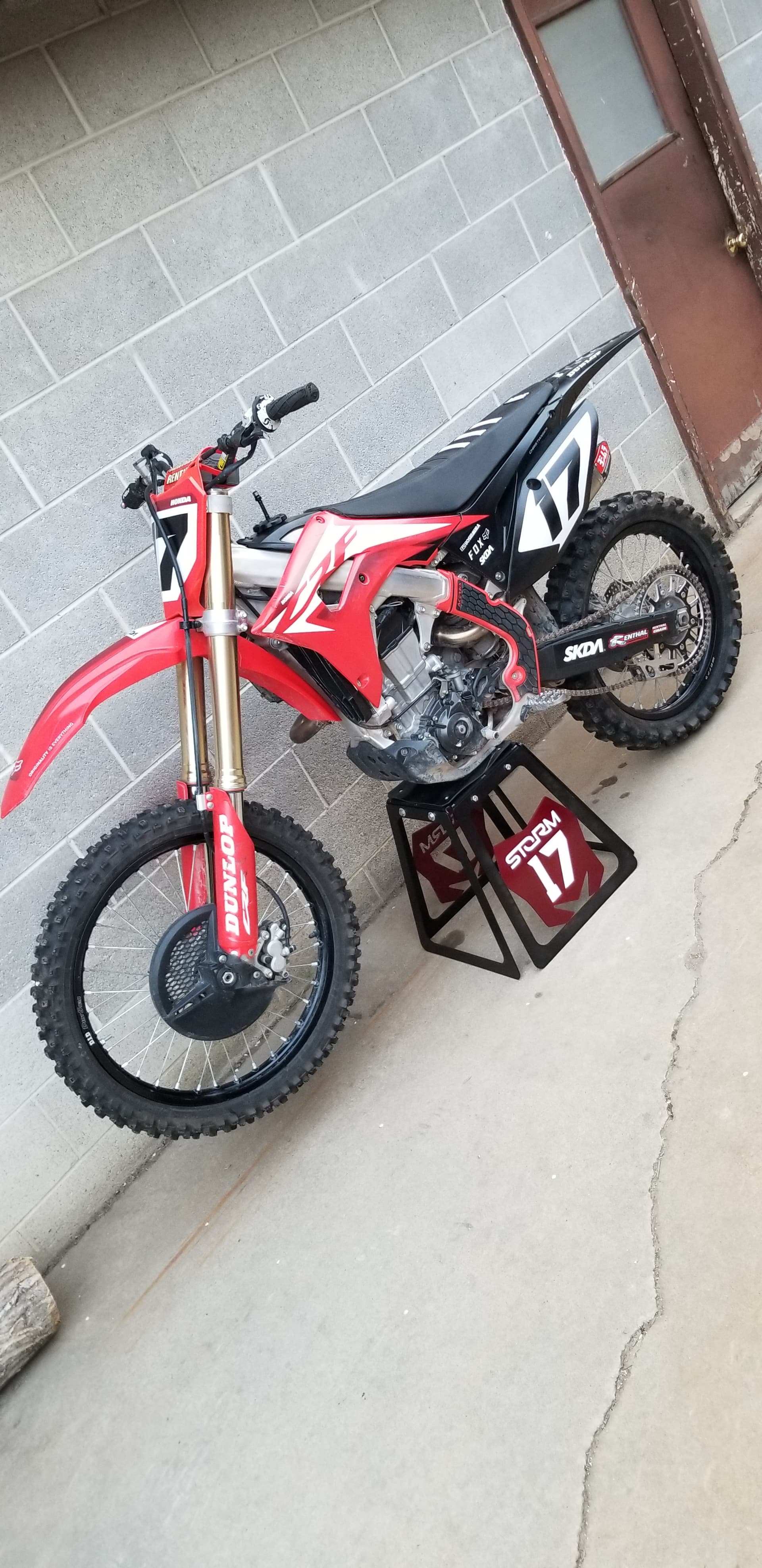

Powder coating has turned into one of my favorite things! Been so much fun learning and seeing the transformation happen! A massive upgrade for my little fab shop! Done alot of skid plates with some rock sliders, dirt bikes stands…etc mixed in!
