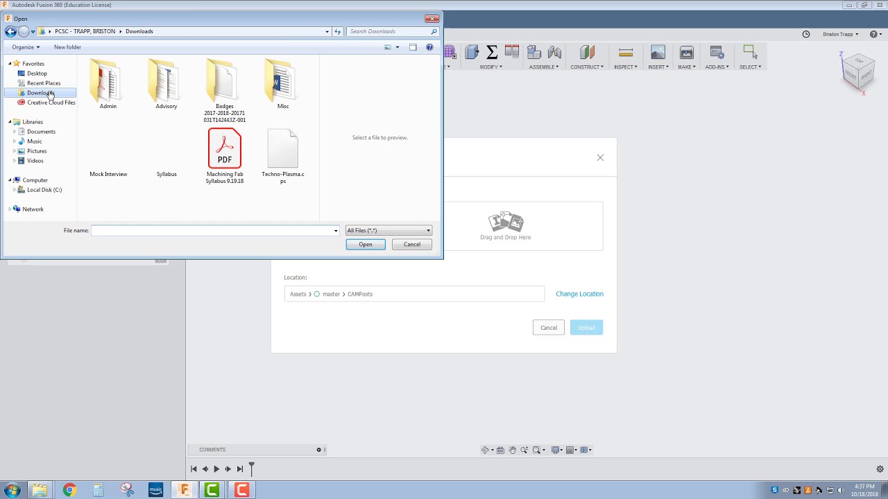

You using fusion360 for cam?
You get the post processor from Langmuirs website. Download it to your fusion account via Langmuirs instructions on their website.
Google drive will only get what you post via Fusion. The file will be only readable with a G code reading program like CutControl.
CutControl Post Processors
Langmuir Systems offers free CutControl Post Processors for Autodesk Fusion 360 as well as MasterCAM and SolidWorks. Find the latest versions of these posts below.
  • Fusion 360 Post (v1.0)
    • Posted programs can contain only a single tool.Several operations using a single tool in the same program are ok.
    • If you are using more than 1 tool for your part, you will need to post separate programs and run them sequentially.
