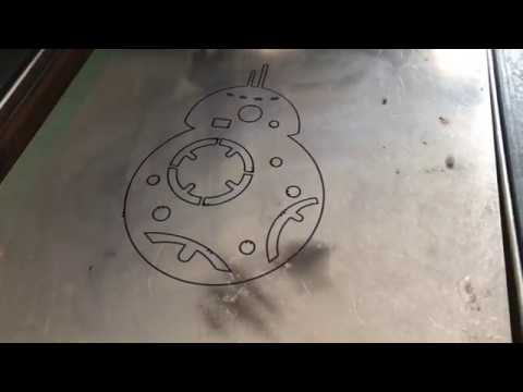

Funny you ask I am actually been working on making a sharpie attached to a 6v solenoid. Was planning just wiring it to a momentary switch so it’ll be down when off but I can lift it with the switch to move to the next cut without marking. Hoping to have it done by this weekend ill post pictures if I’m successful with it.

I got my Sharpie all hooked up it works! Just think it could be improved upon. Its only spring loaded down but man it sure slams it to the table. Heres a short video and a couple of pictures the video is sped up 2X.

Do you know the offset between torch centerline and sharpie centerline?
That’s awesome! Does it use standard “torch on” to fire the relay?
This one I do not I just whipped this one together quickly this week on my breaks at work. I like what your thinking of the bend lines and such, it would be easy to make it so it had the same center line just have to copy the diameter of the torch.
No not hooked through the machine at all. Just have it hooked up to a switch for time being. Would be nice to be able to tie it into the machines relay, don’t think I’ve seen a wiring diagram for langmuirs internal computer yet. Next step is to make it a bit smoother and of course make it automatic.
The CrossFire has a simple electromechanical relay. Should be very straightforward as long as the current doesnt exceed 1 amp (need to doublecheck that).
