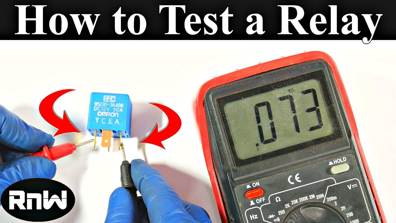

Would I be able to test the relay itself?
Would the relay click if it was bad?
here’s a video i found that shows how to test the relay. shows a good and bad one. both click but one doesn’t show continuity which is the bad one.
I pulled the harness from the white board and reseated that firmly. FrieControl No fire. Im trying to test the relay but the relay is configured differently than the bottom of the reference Youtube relay you had provided.
maybe @langmuir-aksel might be able to help you out from here. i’m sure you can test it similarly to a normal relay using the solder tabs on the bottom. just have to know which ones are which.
I reseated the relay. I’m no longer getting any relay click now with FireControl. I guess I will have to order one. :thinking: I almost have to assume it was there in the relay.
